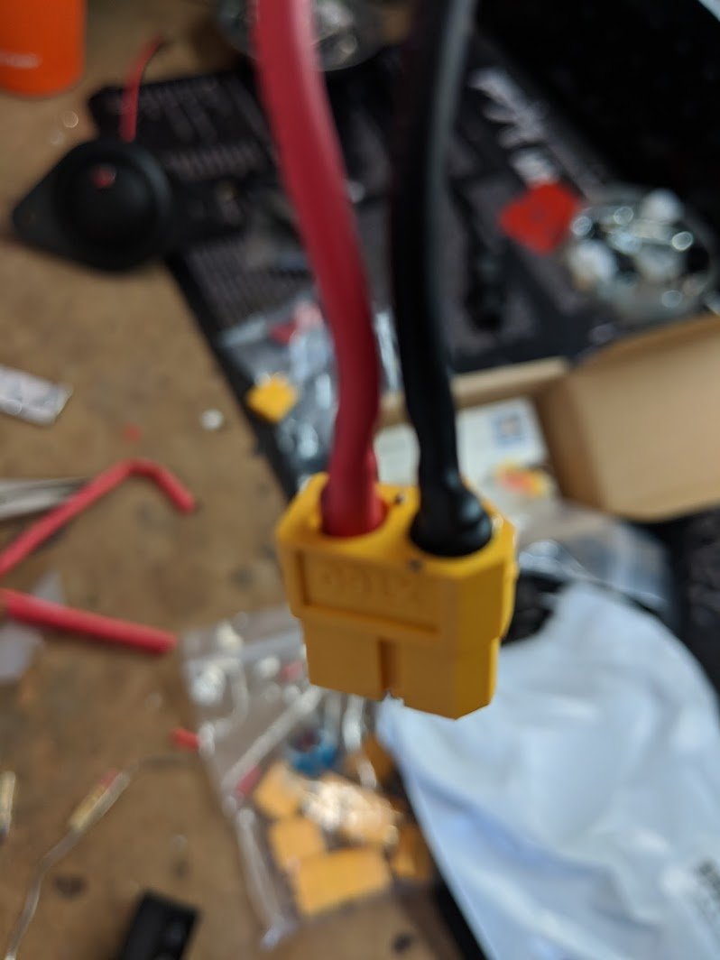

Today the BV and PMP came in, so I took a look at the wires and decided to solder everything.
I took apart the power jack from the camera and clipped off the receptical from the PMP. Soldered those together, as well as the constant power and acc power add a fuses.

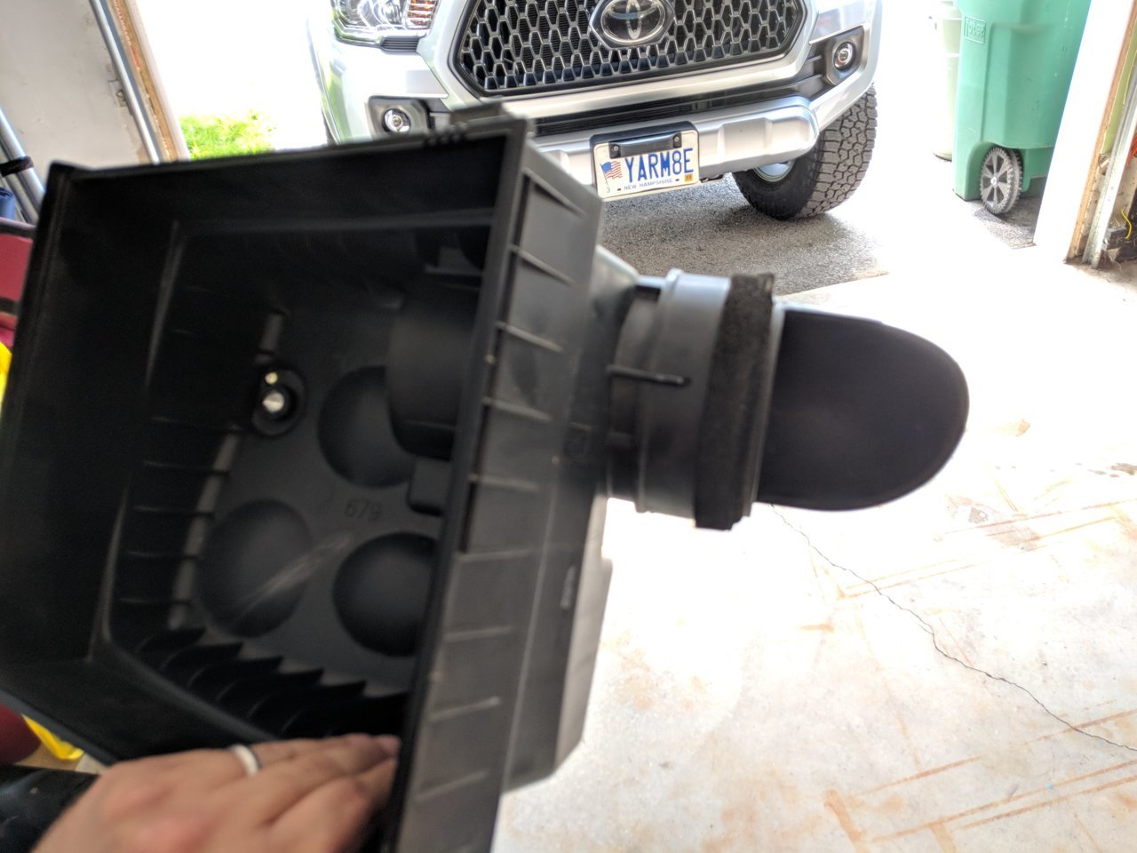

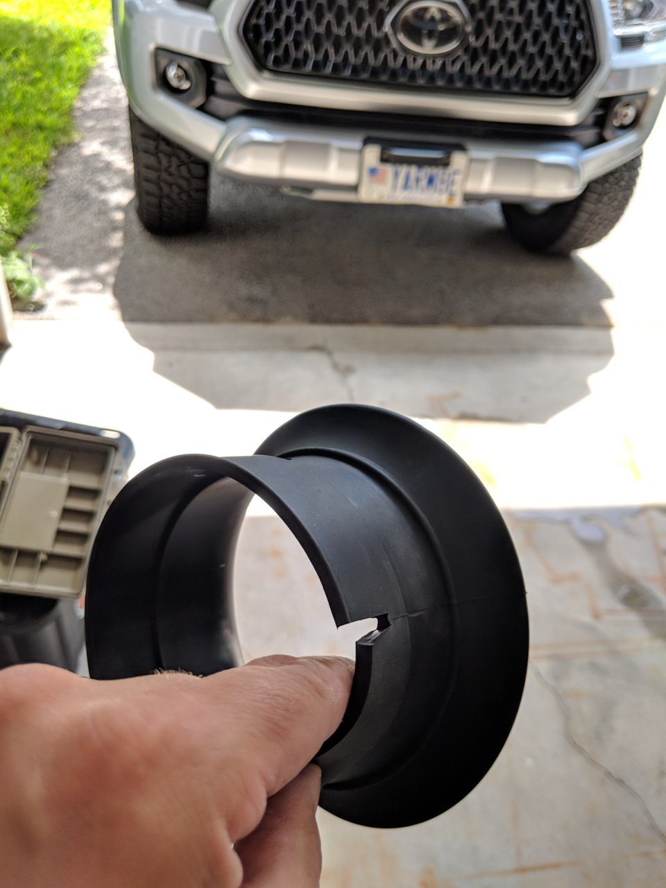

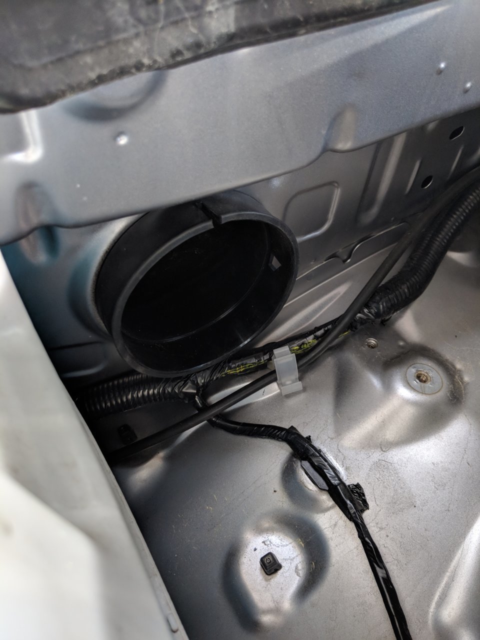

Today I removed the stock air flow thingy (technical term) to the air box from the wheel well and replaced it with the TRD Intake Flow Accelerator (PTR0335090AC). This is part of the TRD Intake, but I am piecing together my own little deal.
Stock:
img_20180729_124809-jpg.2828693
TRD:
img_20180729_124922-jpg.2828694
img_20180729_125012-jpg.2828696
Pretty simple to install. The bottom section of the air box has 3 bolts that need to be removed. 10 minutes overall. Next is the intake pipe once I decide what to do. Then OV tune.

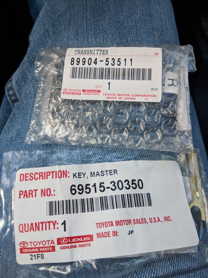

I decided that I am going to do the Lexus Key Card addition as explained in this thread
I made my order today because my local had the best price for the card (202.86, PN 89904-53511), and ordered the key blank with it (37.58 PN 69515-30350). Ordered through the local's website. Parts department emailed me asking for the VIN number, so I gave it. Got this email back:
Hello
By the VIN provided by you, the parts you have ordered is not the correct part for your vehicle.
There is a price difference of $96.99 in your favor. we will credit the difference. The parts should be available tomorrow.
Thanks
I emailed them back asking them to please call me. Had a nice conversation with the parts guy. Said the part he changed it to was not a wallet card. I asked politely to please change the order back to what I asked for, and he responded with "are you absolutely sure that part will work with the truck vin you gave me?" To which I replied "I just read 16 pages worth of testimonials for exactly that part with exactly the same truck as the vin I gave you, so yeah, I'm pretty sure".
Parts will be available for pick up tomorrow. I tried to get the extra 96.99 off anyway, but he wasn't having it. Nothing else really going on right now, boring.....
Key Card 2 Aug 2
Picked up my order this afternoon and had the card programmed, and the key cut. Took the technician at my local favorite locksmith (Dependable Lock Nashua, NH) about 5 minutes to do after I assured him it would work. The look on his face was priceless when I said "gotta love the internet" after he started the truck with success after the first try.
A pricey convenience mod, but I think this one will be worth it to me....

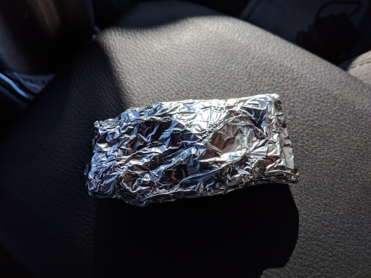

Key Card 3 -Aug 3
So I'm a trust but verify kind of guy. I've decided that I love the key card in my wallet. So far it has great range, and I have had little issue with it. However, I have decided to keep an emergency keyfob in a make shift faraday wrap in a secure location in my truck for now, just until I get used to trusting the card.
faraday-wrap-jpg.2836666
The aluminum foil works great on it to keep the signal contained.

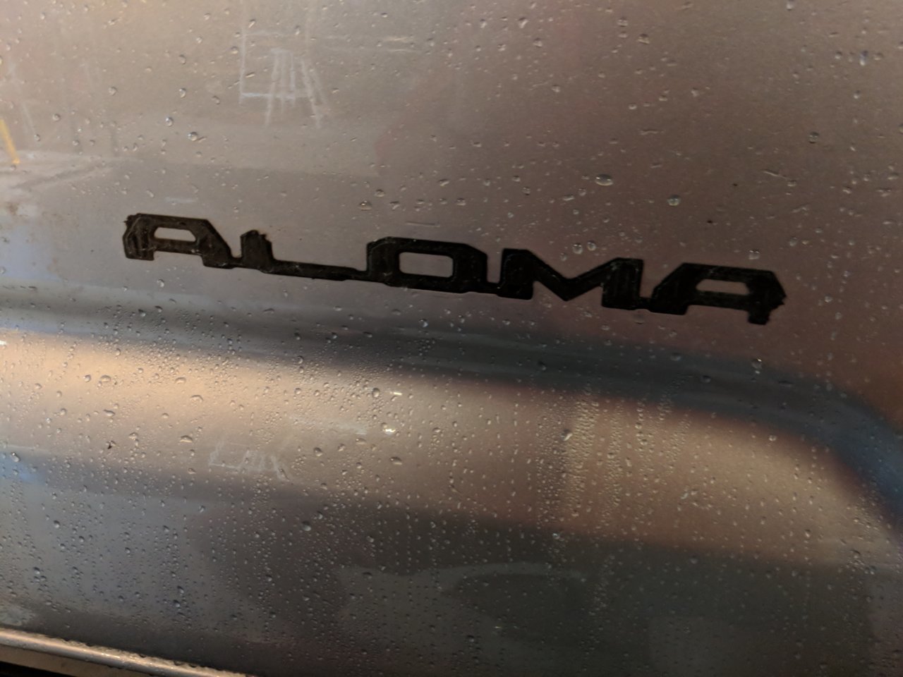

Debadge Aug 11
I decided to remove the badges from my truck. I used floss to cut through the adhesive. Once the badges were off, I pealed off the thick adhesive:
img_20180811_143051-jpg.2850003
img_20180811_143532-jpg.2850005
There was a thin adhesive film left that I wiped away with Laquer thinner:
img_20180811_152631-jpg.2850007
I wiped away the remaining shadow and film with Goo Gone, then waxed with Maguire's cleaner wax:

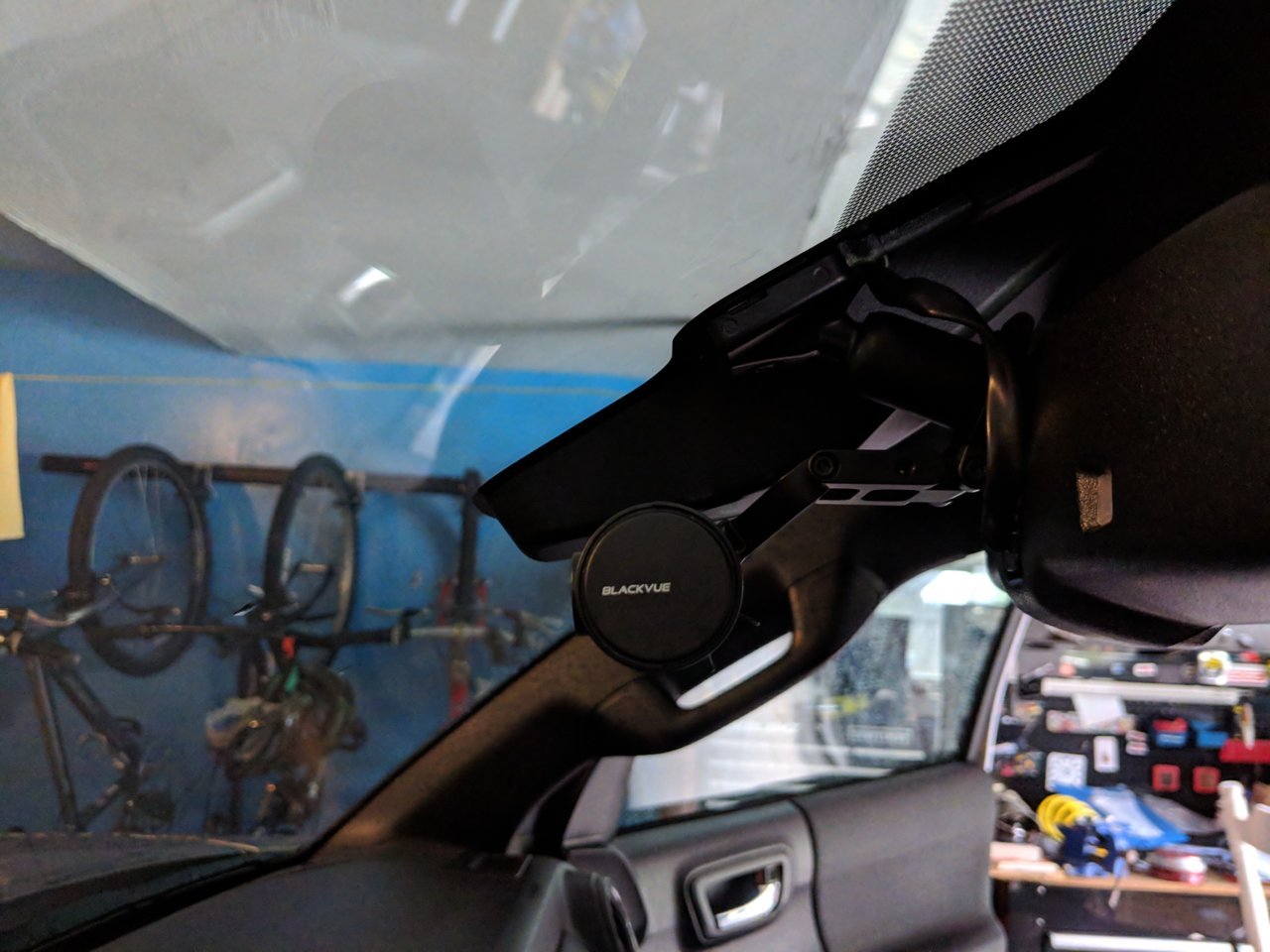

In other news, I'm not quite satisfied with the dashcam mount that uses the GoPro mount, so I have something else coming in tomorrow to reposition the camera.

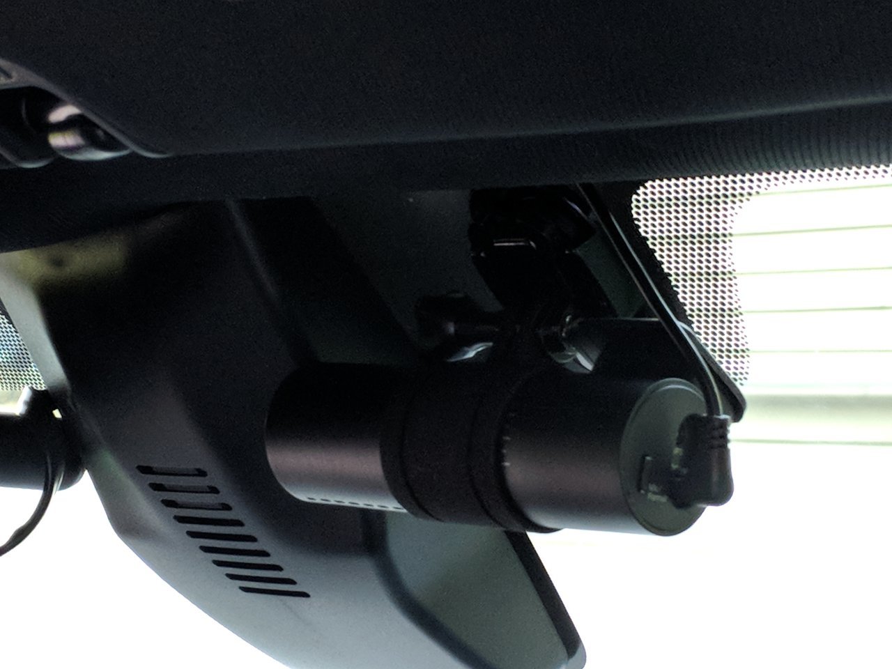

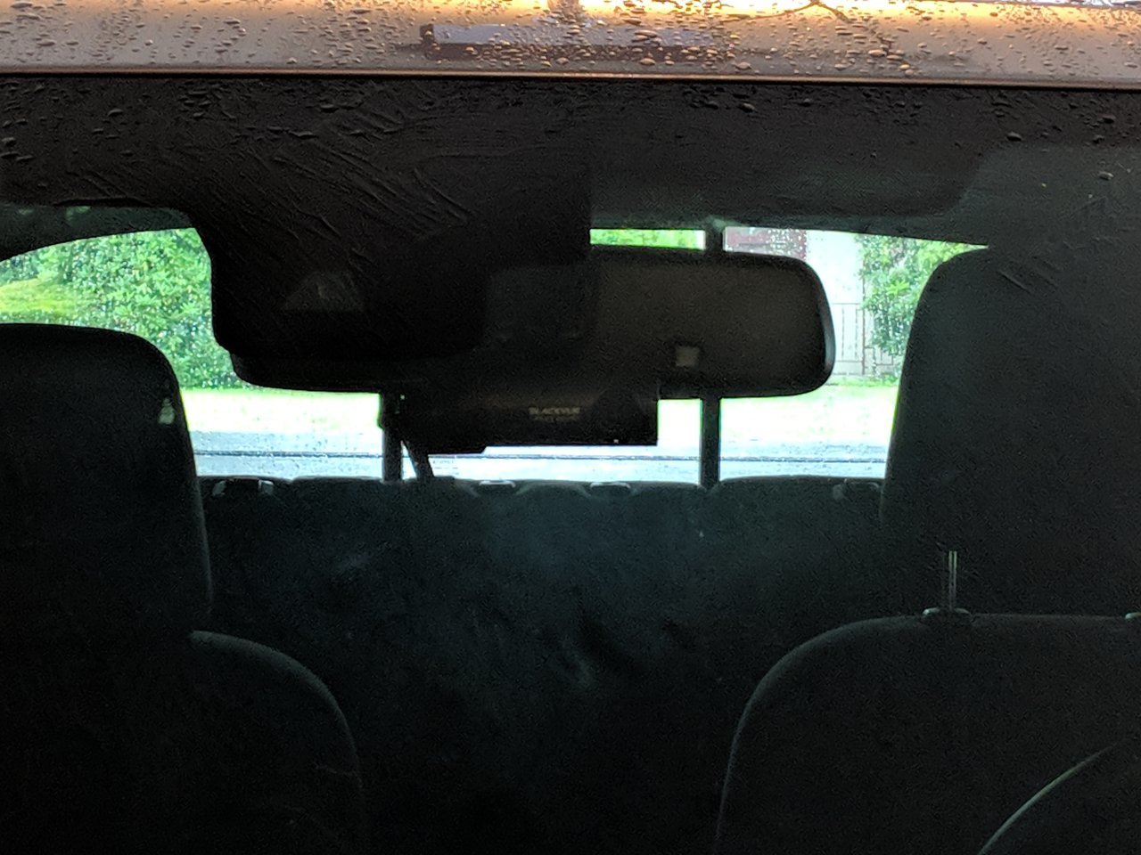

Dash Cam (Again) Aug 12

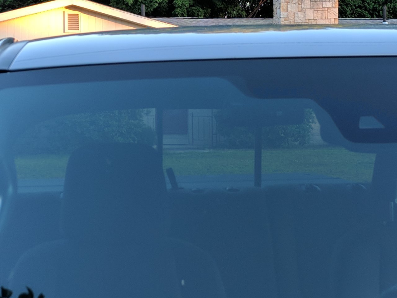

I relocated the dashcam from the GoPro mount to under the rearview mirror. I did this because the TSS is still in the way with the GoPro mount.
img_20180812_134220-jpg.2851696
img_20180812_134150-jpg.2851698
The mount is the
$99 BLENDMOUNT INNOVATIVE MOUNTING SOLUTIONS BlendMount BBV-2000R, Aluminum Dashcam Mount for BlackVue DR900S/750S/650S/590W Series Series - Patented Design Made in USA - Looks Factory Installed
. It was kind of a pain in the ass to install, but once I had it dialed in, I found there is minimal interference to the sight line by the TSS module. It is more on the center-line as well.
The BlackVue DS590 is a little on the slim/smaller size, so I had to add the included stick on pads for the mount to get a good snug hold on the cam.

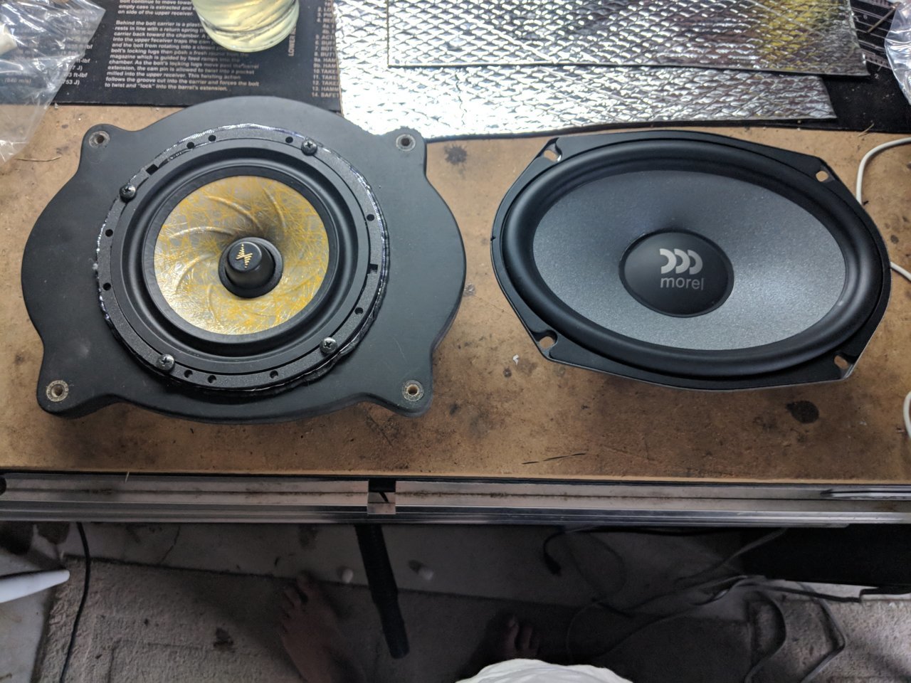

The Morel Tempo Ultra 692s came in today, so I swapped out my PPI drivers for the Morel drivers. They are not on the proper crossovers yet, so I'm going to be listening low volume until I can figure out where the tweeters are going.
Drivers
img_20180821_175359-jpg.2867158
Comparison
img_20180821_175905-jpg.2867159
img_20180821_175909-jpg.2867160
PPI in door:
img_20180821_184104-jpg.2867163
Morel in door:
img_20180821_183141-jpg.2867164

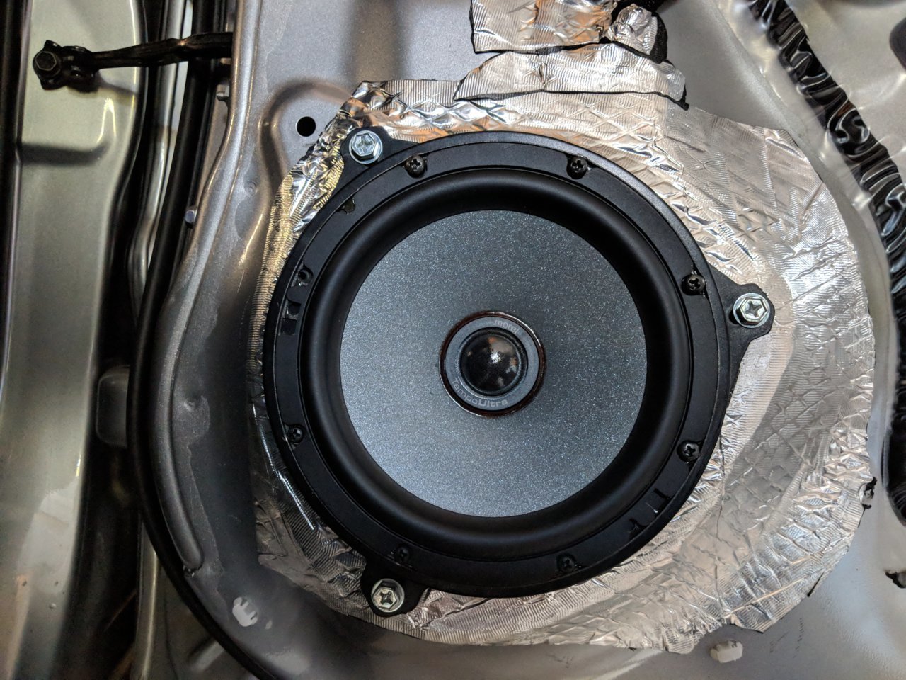

You can see in this picture that I put some noico deadener on the surface that the speaker attaches to the adapter.
Crutchfield's "what fits" guide says these will not fit. They do, and just fine. There is 1 thing I do not like about the Morel drivers so far. I do not like the connection posts at all, and will probably end up soldering wires with bullet connectors. Right now they are hooked up the same way as the PPIs were (using the OEM wiring for the speakers to the amp). When I get a weekend free I'll install the crossovers and run new wires to the doors. Of course a lot of that will depend on figuring out how to make the sail panels without getting pissed off and breaking shit.
This morning I tested the speakers at what I considered the old middle volume (23) and found the drivers to be a high step up from the PPIs, even when not crossed over properly. I was listening to Umphry Magee's "Death by Stereo" album, and the morels kick amazing. When this gets fully set up with the crossovers, these things are going to be monsters.....

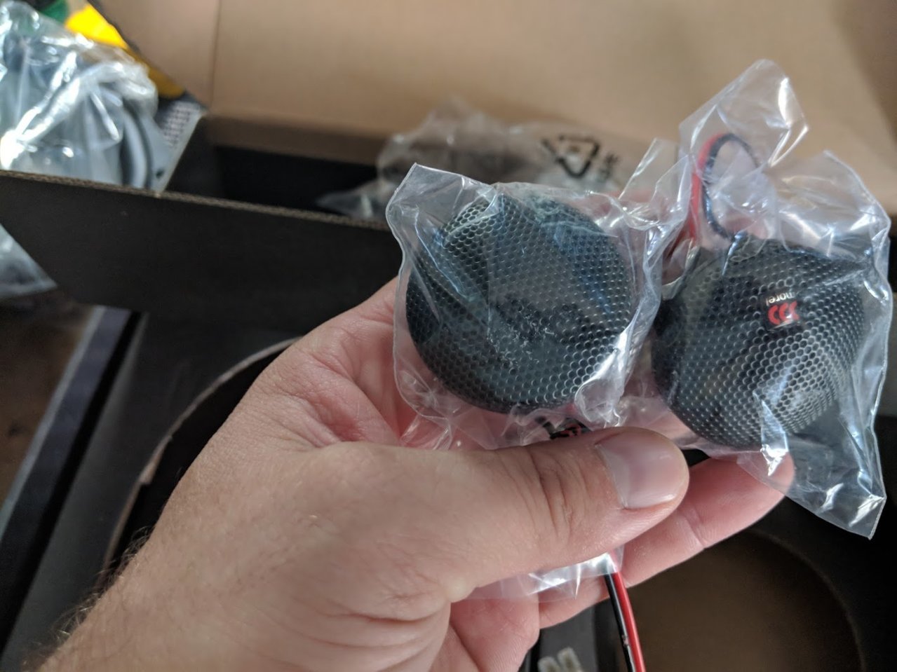

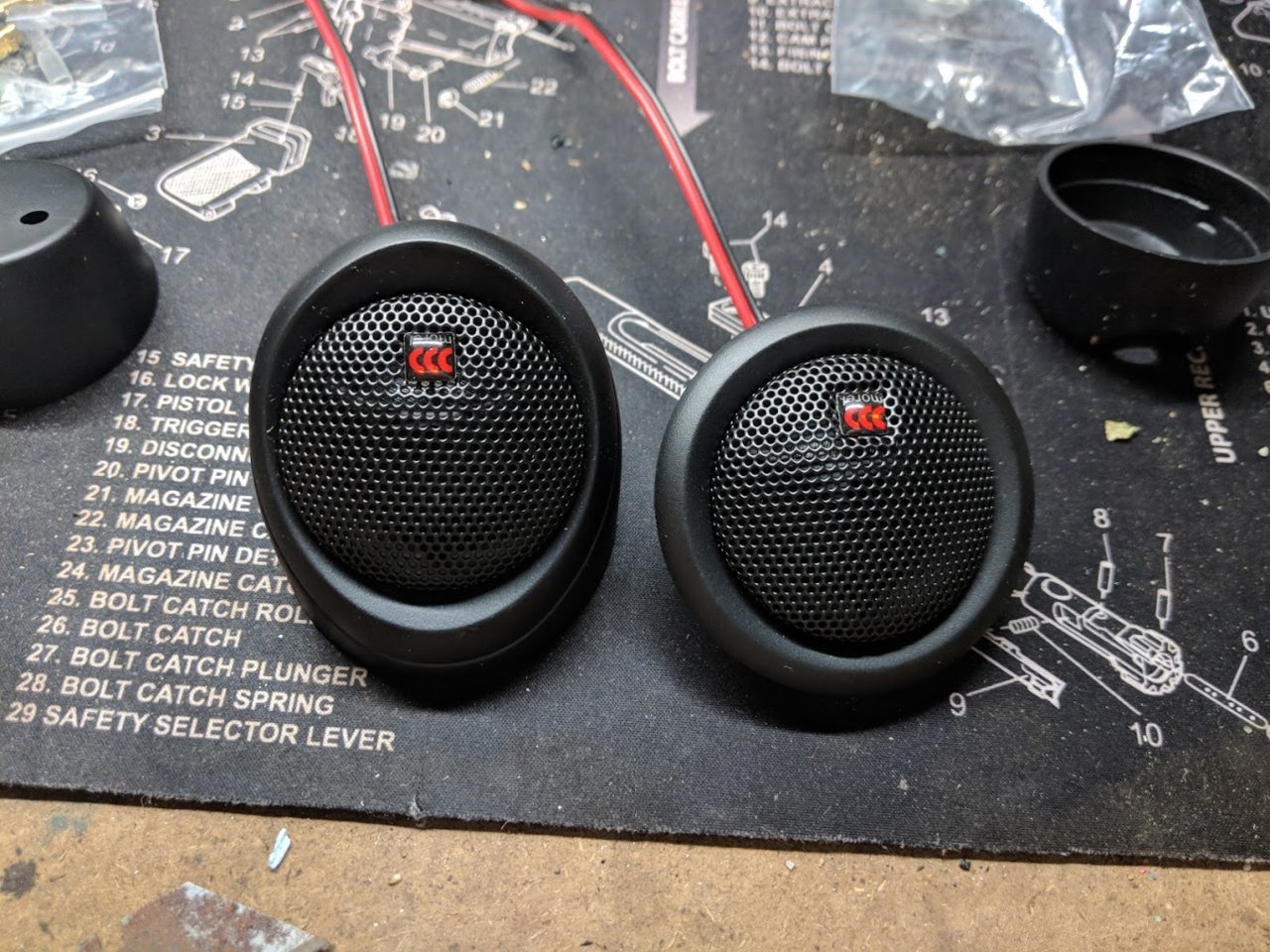

Tweeters:
morel-tweeters-jpg.2867895
morel-tweeters-2-jpg.2867896
The tweeters come with 3 mounting options, but no swivel mount. I'm going to have to look into finding a swivel mount for them.

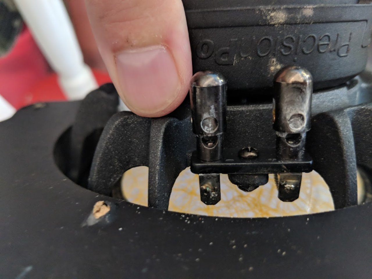

A quick note about the PPIs: These are great drivers, but they were unmatched by the Kicker drop ins, and needed to be on their proper crossovers, getting at LEAST 200RMS. They were severely underpowered. I have the crossovers and the tweeters from the 3 way kit, and the crossovers will work in just a 2 way configuration, but I'll be honest, I don't like the AMT style of tweeters without the small mid range drivers, and I can't find a set to match.
Anyway, when I took them out of the door, I found some mild corrosion on the wires:
corrossion-jpg.2867901
Another reason for me to solder the wires to the speakers, then heat shrink to protect the connections......

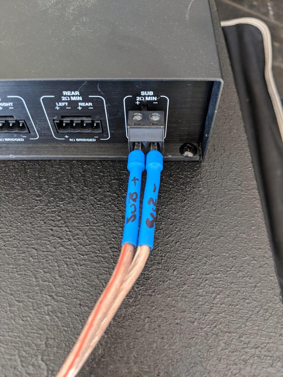

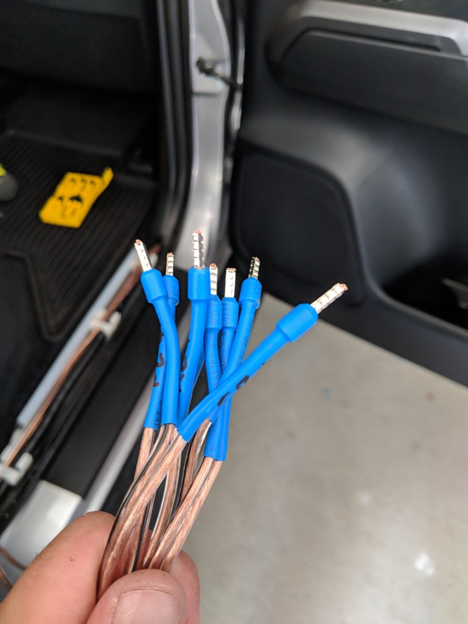

Audio Clean Up Aug 26

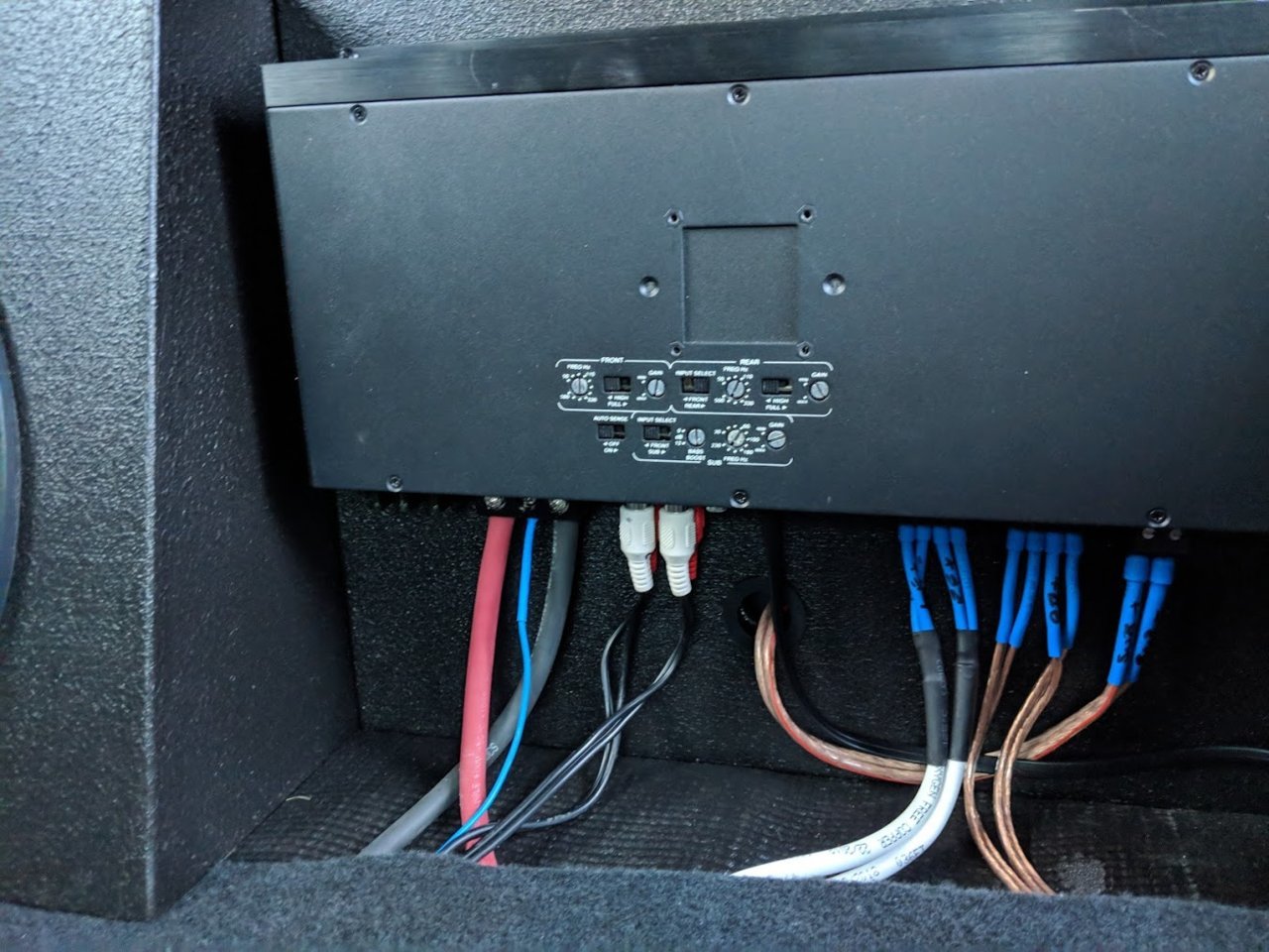

Clean up! I grabbed some stuff on Amazon to clean up my system and to prep for doing the tweeter / component crossovers.
Put new teminals at the end of everything
img_20180826_140550-jpg.2874691
img_20180826_135808-jpg.2874689
img_20180826_131716-jpg.2874688
Ran wires for the crossovers
img_20180826_153104-jpg.2874692

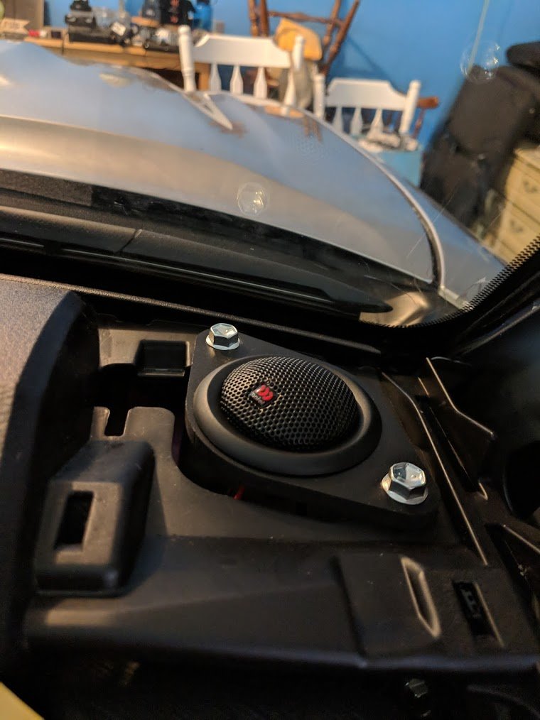

Audio Again Aug 30

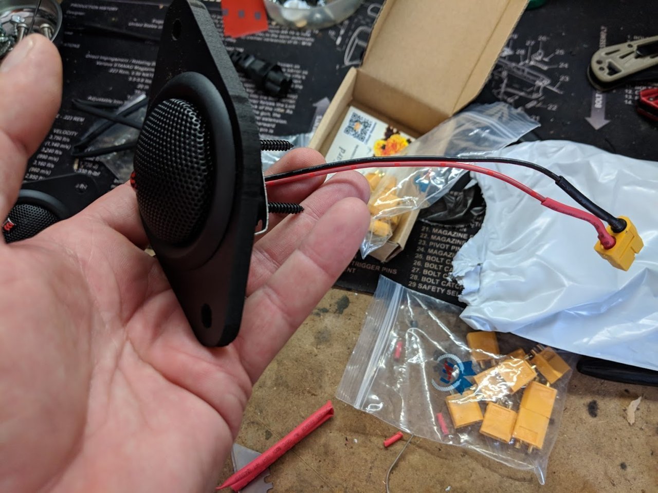

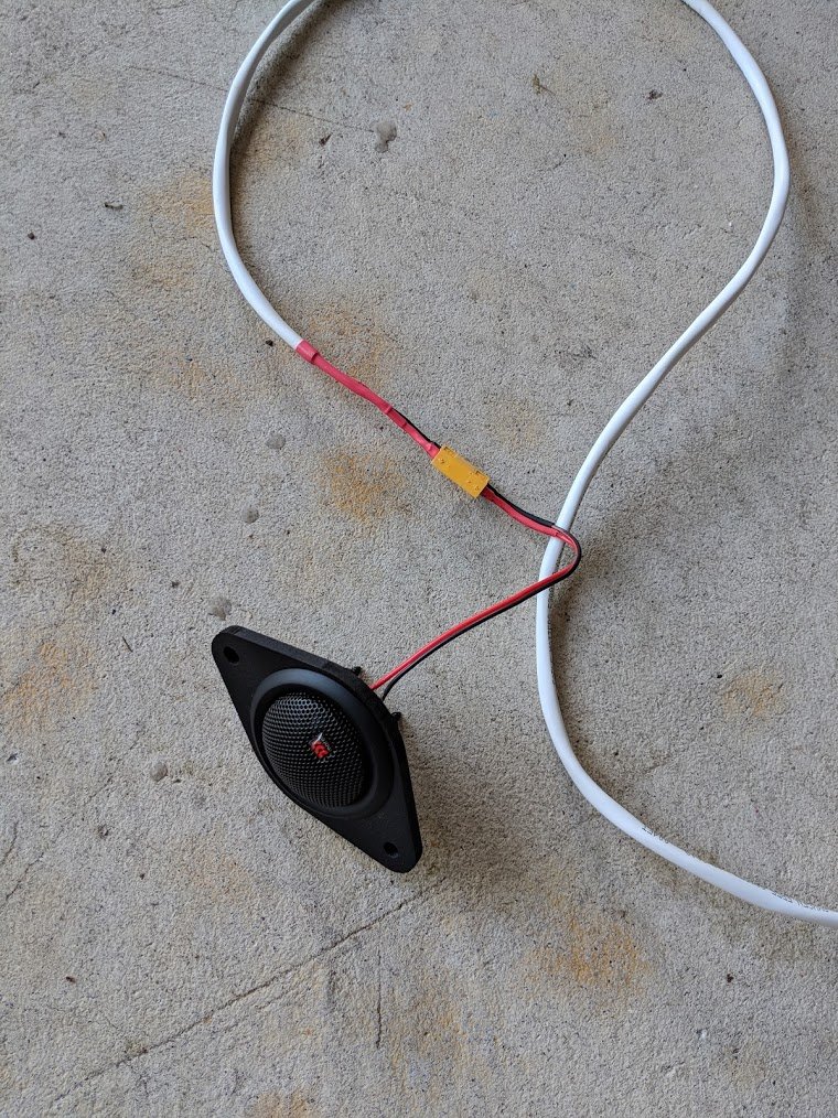

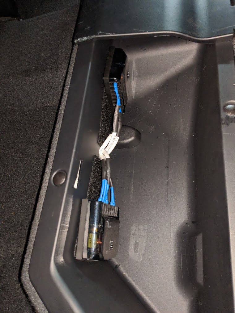

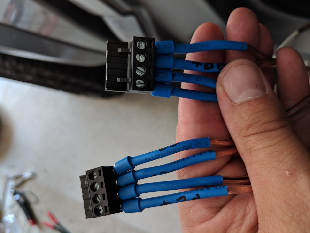

Last night, the connectors and the adapters for the tweeters came in, and when I got home from work, I got to work soldering the connections for the tweeters.
tweeter-instal1-1-jpg.2880013
tweeter-install-3-jpg.2880014
tweeter-install-4-jpg.2880015

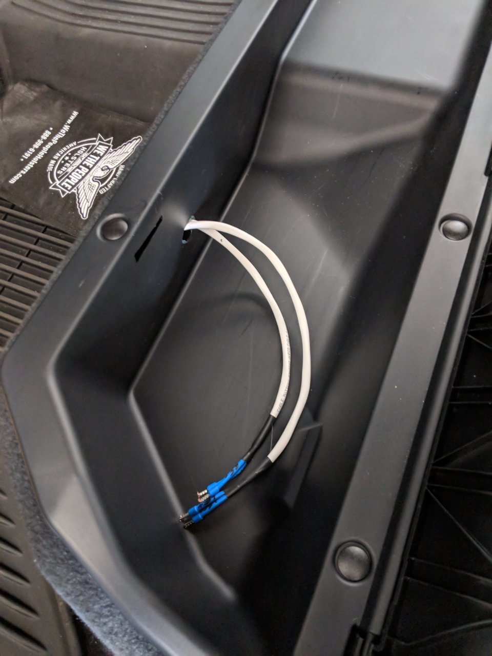

I then started on the passenger side, removing all the trim panels, Oh shit handle, a-pillar, etc, and ran the wire down. When that was done, I removed the door panel, took the woofer driver out and ran the woofer wire to the door. This was MUCH easier to do than my Tundra was. The wire boot comes out easily. There are two wire harnesses to unplug, and you can push the boot out from the cab of the truck, then run the wire through a pre-existing hole in the boot, and into the door. Run all the wires back through the hole in the cab, plug in the harnesses and away you go. I didn't take pictures of that though. Next time I have the kick panels off, I'll try to remember to do that.
All in all, running all the wires and installing the tweeters took around 3 hours of taking my time, taking water breaks (it was hot AF in my garage), and finding misplaced tools.
tweeter-install-5-jpg.2880020

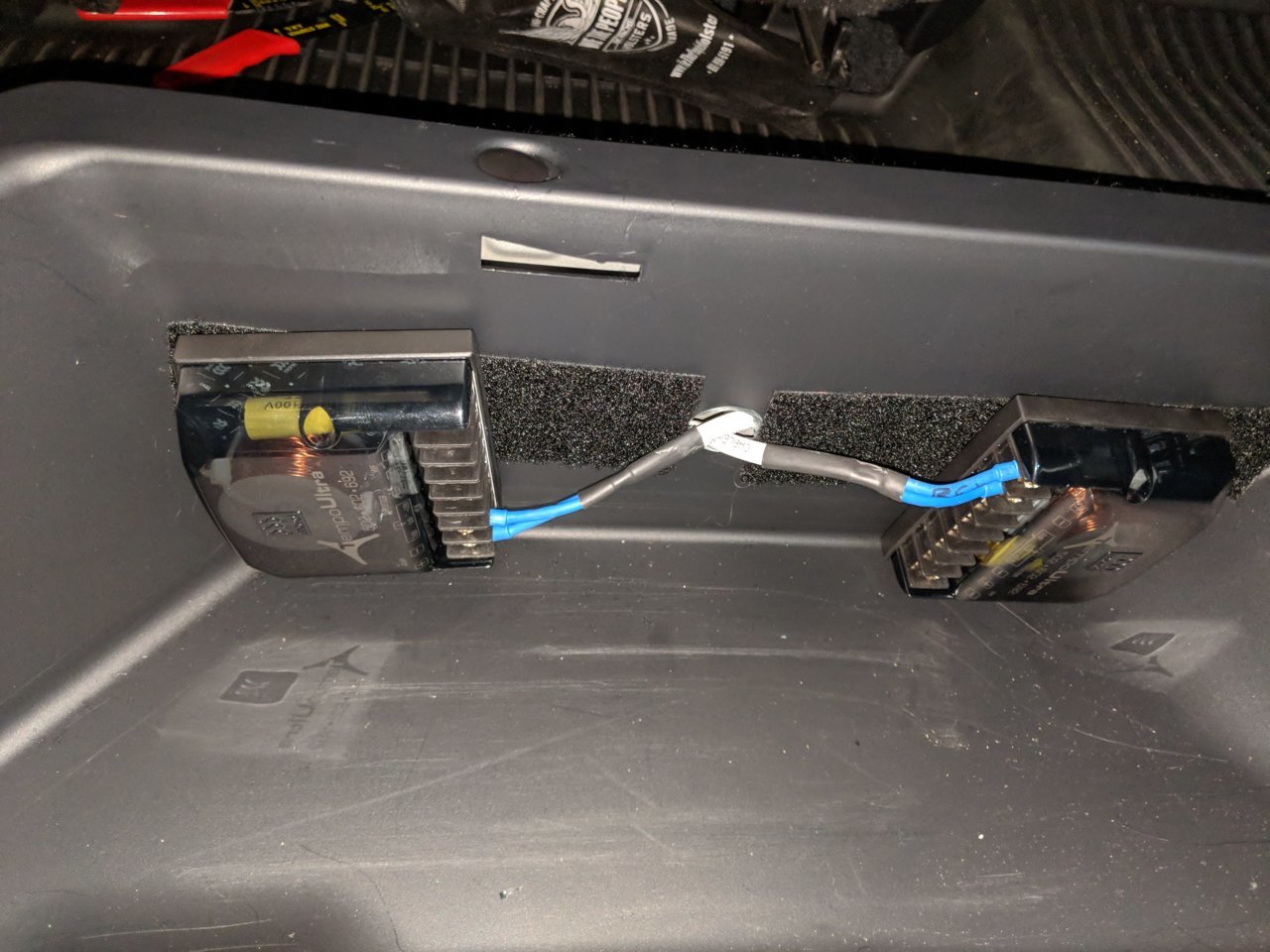

With the crimp on connections I used, as well as proper labeling, hooking up the crossovers was a breeze
tweeter-install-6-jpg.2880021

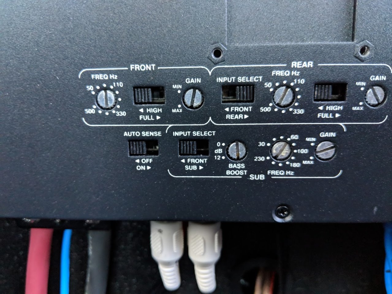

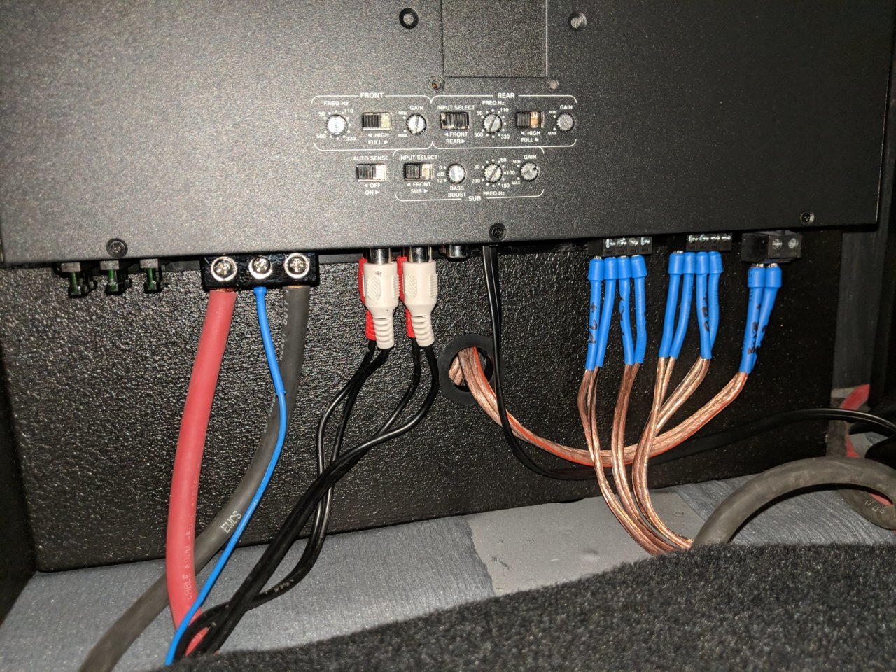

The woofers have been breaking in for the last couple of weeks (days?) and are flexing really nice with rich full bass. I have the high pass for the fronts set at 90 so I'm not overwhelming the woofer drivers in the door, but it sounds great right there. The tweeters are plugged into the +2dB attenuation slots, and sound pretty good there so far. I'm not sure if tweeters need the same sort of responsible breaking in period, so I'm going to take it easy on them. But they are clear with great sound reproduction. I did not reset the gains at all, as I tuned the amp with an oscilloscope to match the input of the head unit.
amp-settings-8-30-jpg.2880053
amp-cleaned-up-2-jpg.2880054
One thing I do need to adjust on the amp is the rear high pass setting. Right now it is set at 110 (ish, more like 108 or something, see picture). The kickers in the rear doors sound almost tinny and flat compared to the fronts, and I need to get just a little more bass to them.

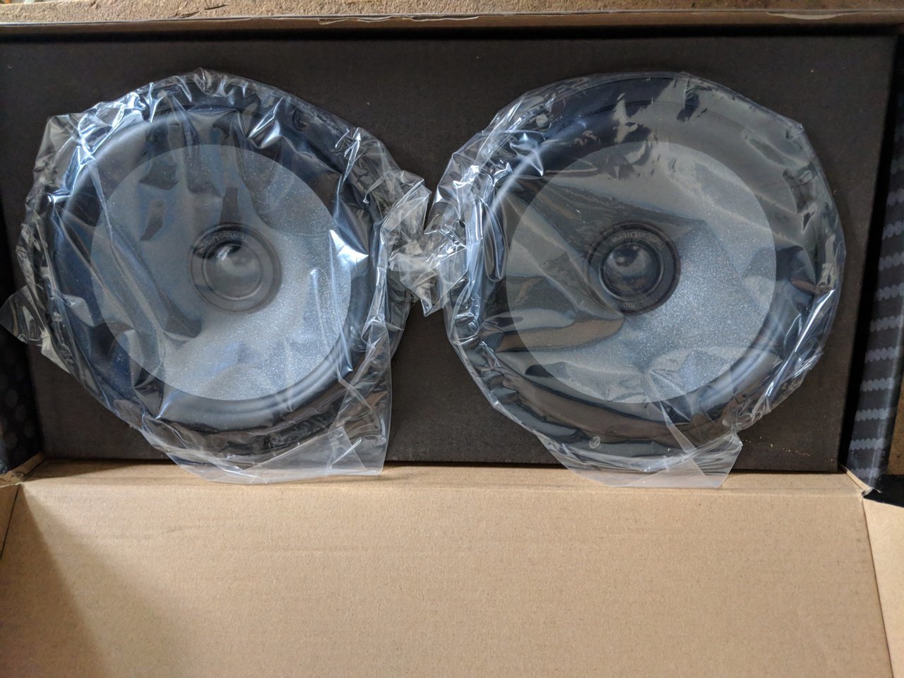

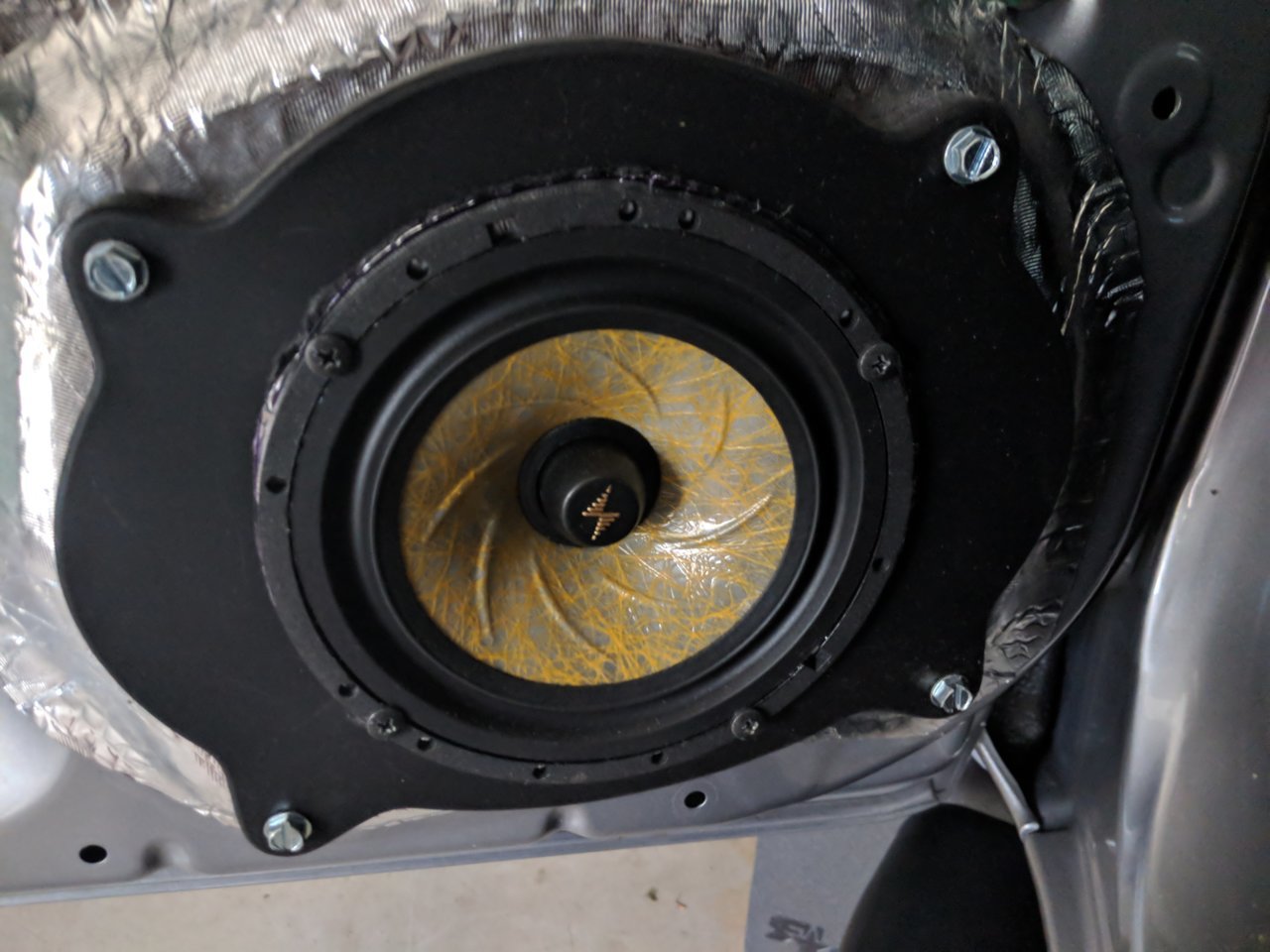

Updated the rear doors in the truck to match the fronts. That whole "Premium sound for $250" is great, if you don't like music LMAO.

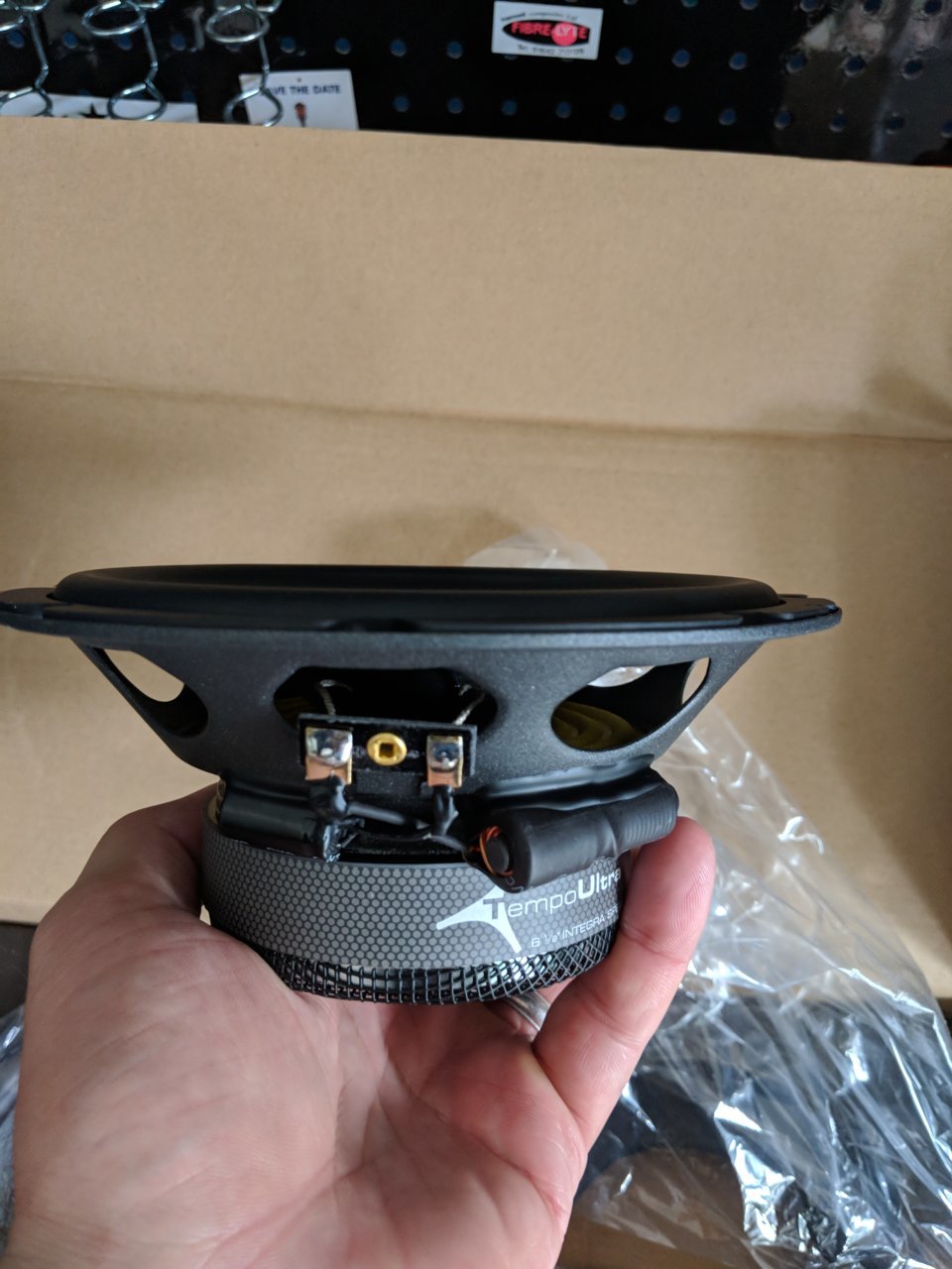

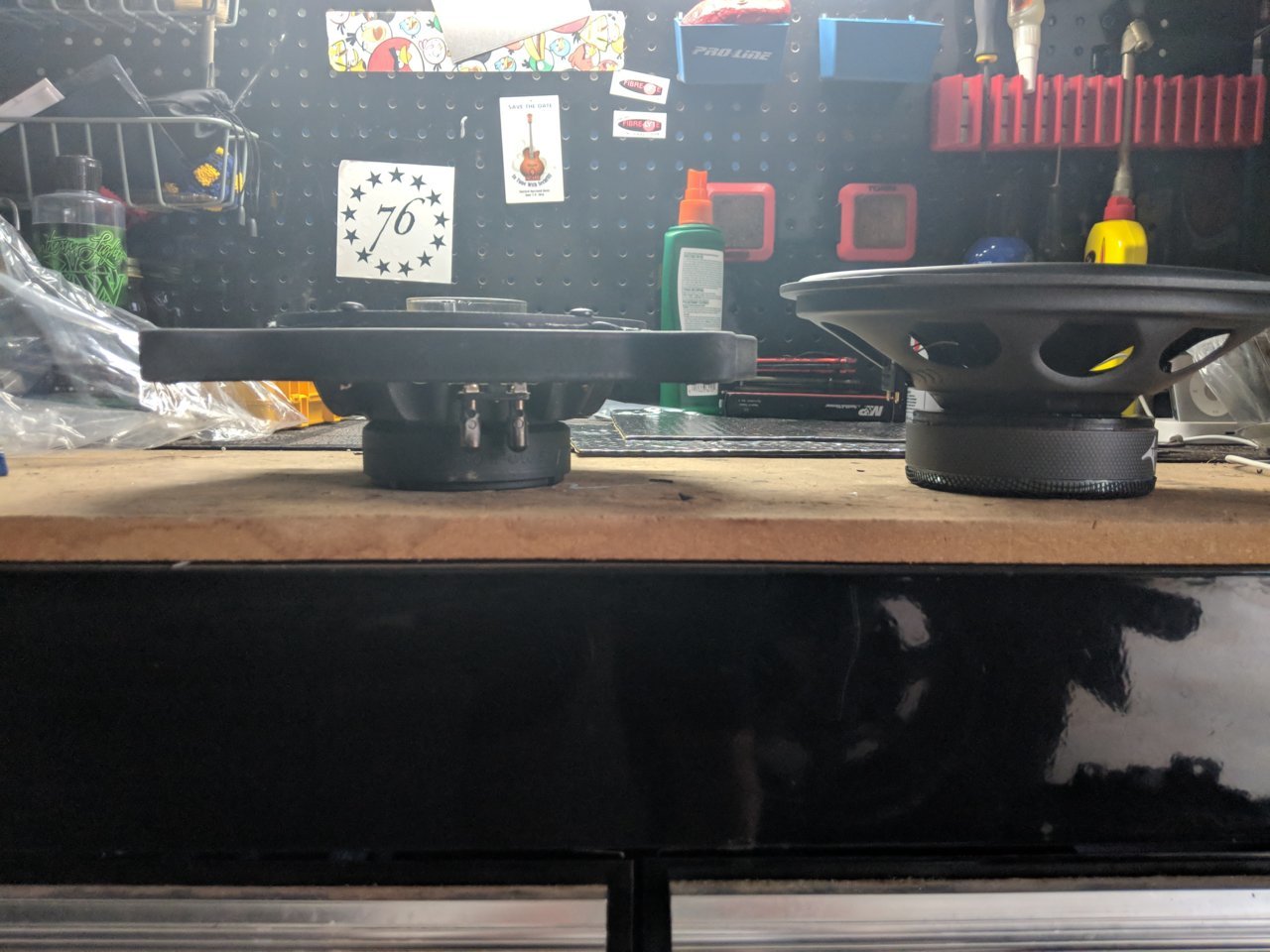

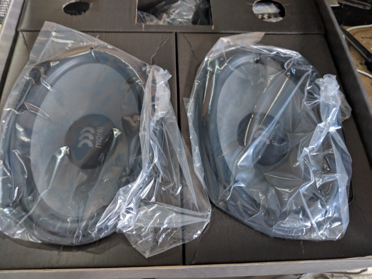

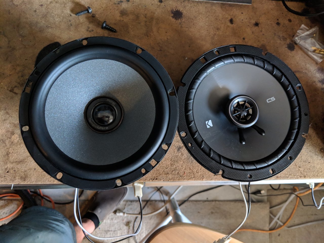

The Morel Tempo Ultra 602 Integras came in, so I did a pit crew change out. I'm getting really friggen good at getting the panels off at this point.
Anyhow, here is a side by side of the Morels and the Kickers. Please note that the Kickers are the 6.75" coaxials, and the Morels are 6.5" coaxials.
Unboxing:
img_20180918_142520-jpg.2909908
img_20180918_142547-jpg.2909909

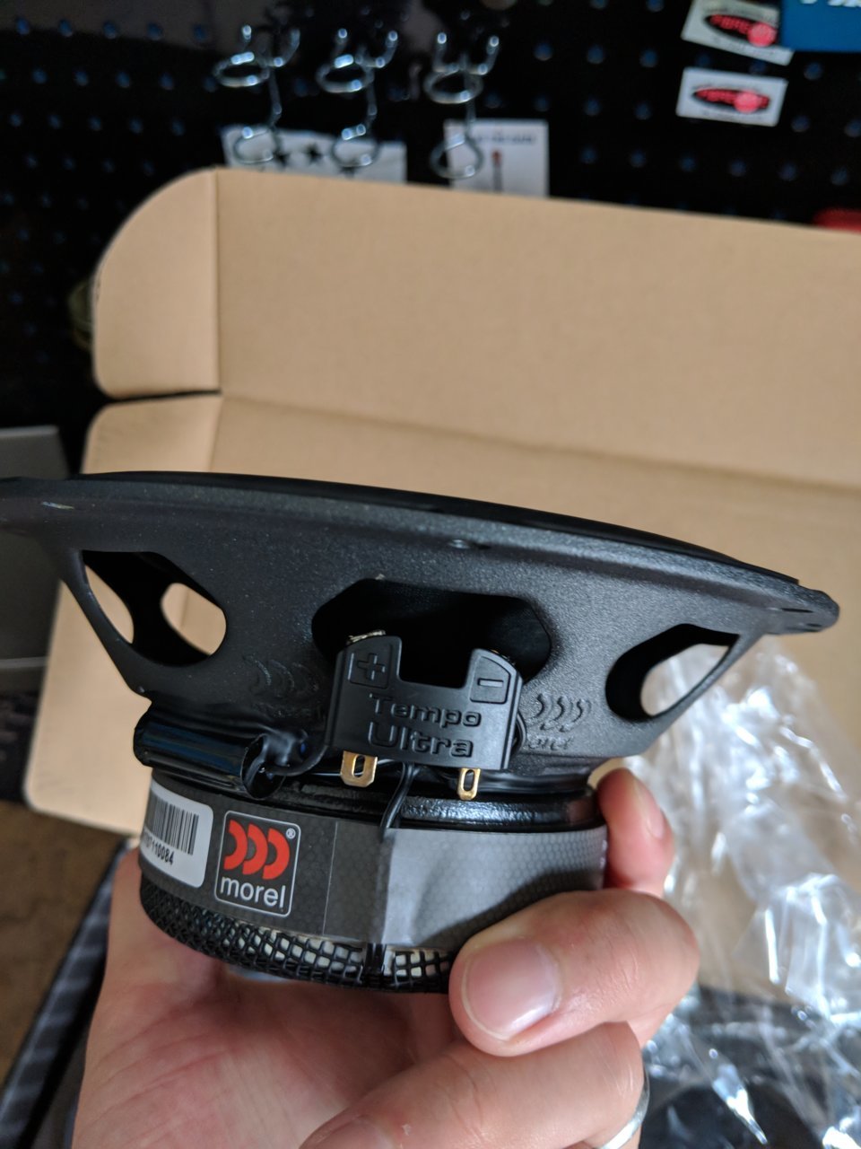

The speakers have soldered in resister style crossovers to protect the speakers from going too high on the woofer or too low on the tweeter.
img_20180918_142614-jpg.2909910
The terminals in my opinion should be more robust for a $269 pair of coaxials
img_20180918_142620-jpg.2909912

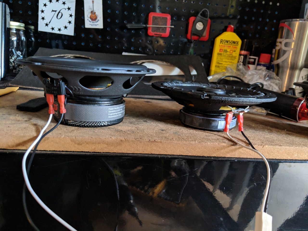

Side by side comparison
img_20180918_180705-jpg.2909917
img_20180918_180709-jpg.2909919
Look at the size of that magnet on the Morels!

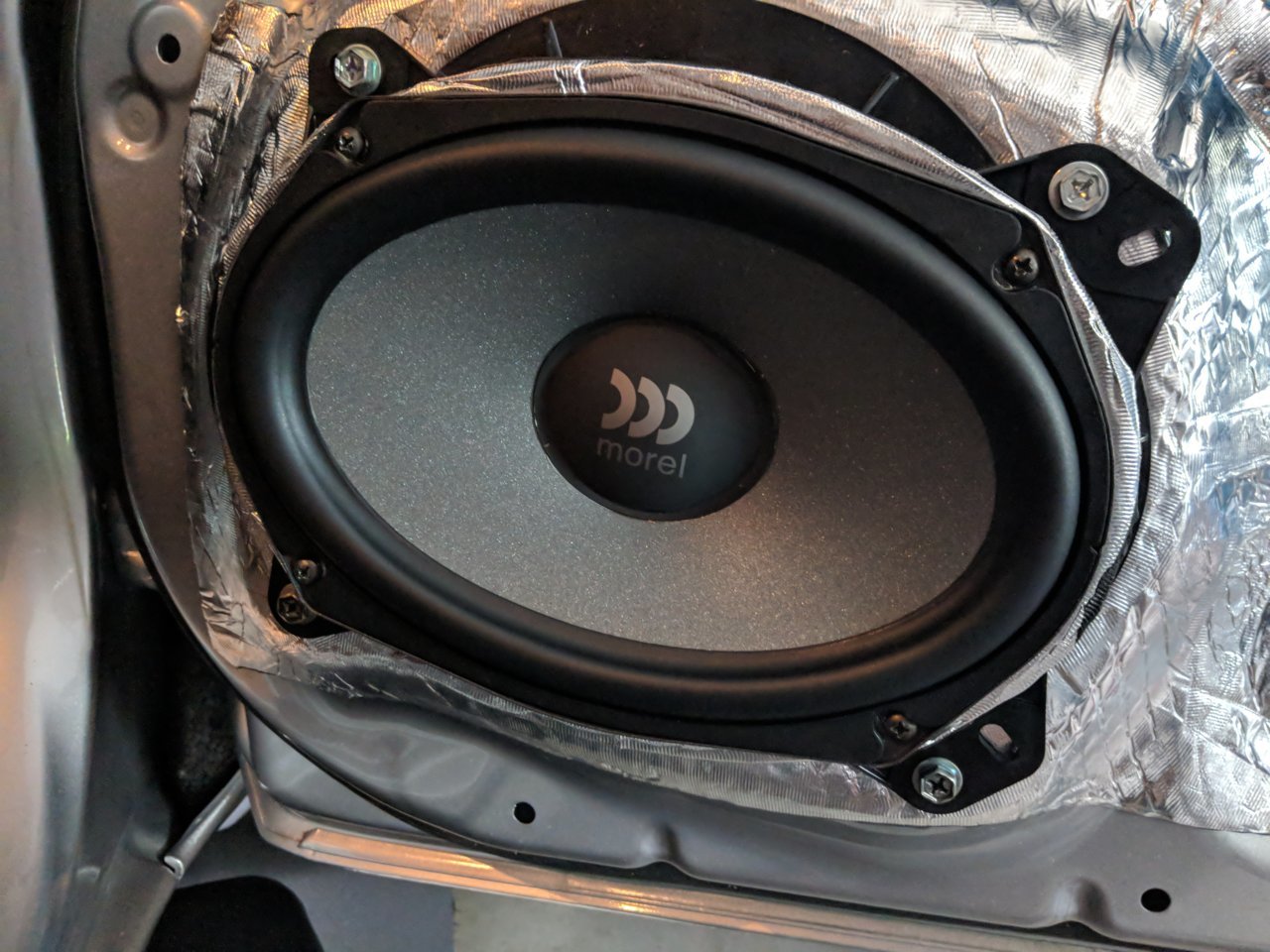

And we're installed:
img_20180918_181112-jpg.2909929
Right at this moment, I am not getting full range of these speakers. I have my high pass set at 110-ish Hertz, and will leave them like that for one month for responsible break in. Then I will probably set the rears to "full", or at the very least down to 60-ish.
