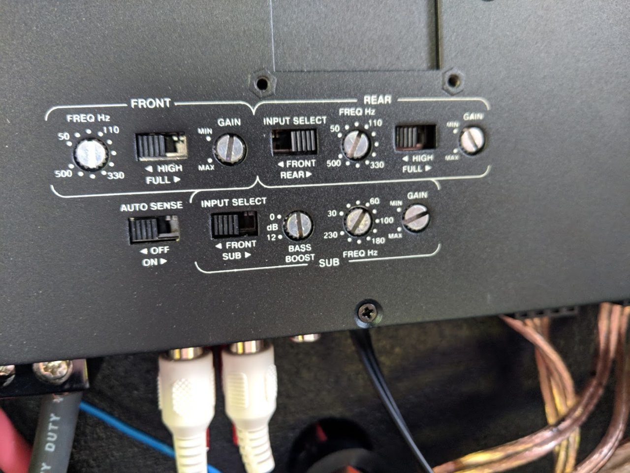

Current amp settings

I had some tuning issues with the JL. The bass felt muddy and the timing was off. So after a lot of back and forth with @Mr Marv (who by the way is a treasure trove of audio information), the amp settings were changed multiple times in small increments until I ended here:
amp-settings-jpg.2721832
The tic marks on the dials are 20hz intervals. That said, the crossover point for the front speakers is 90 hz, the rear 100 hz, bass boost is 6dB and the sub is set at 60 hz. These sounded to me like the best settings so far, and I am rolling with them for at least a month before I change. I ran with these settings on the JL for two weeks before the Audison was installed.
Also, for timing, Marv suggested I switch the wiring on the sub to the opposite of pos - pos, neg to neg. His explanation from text:

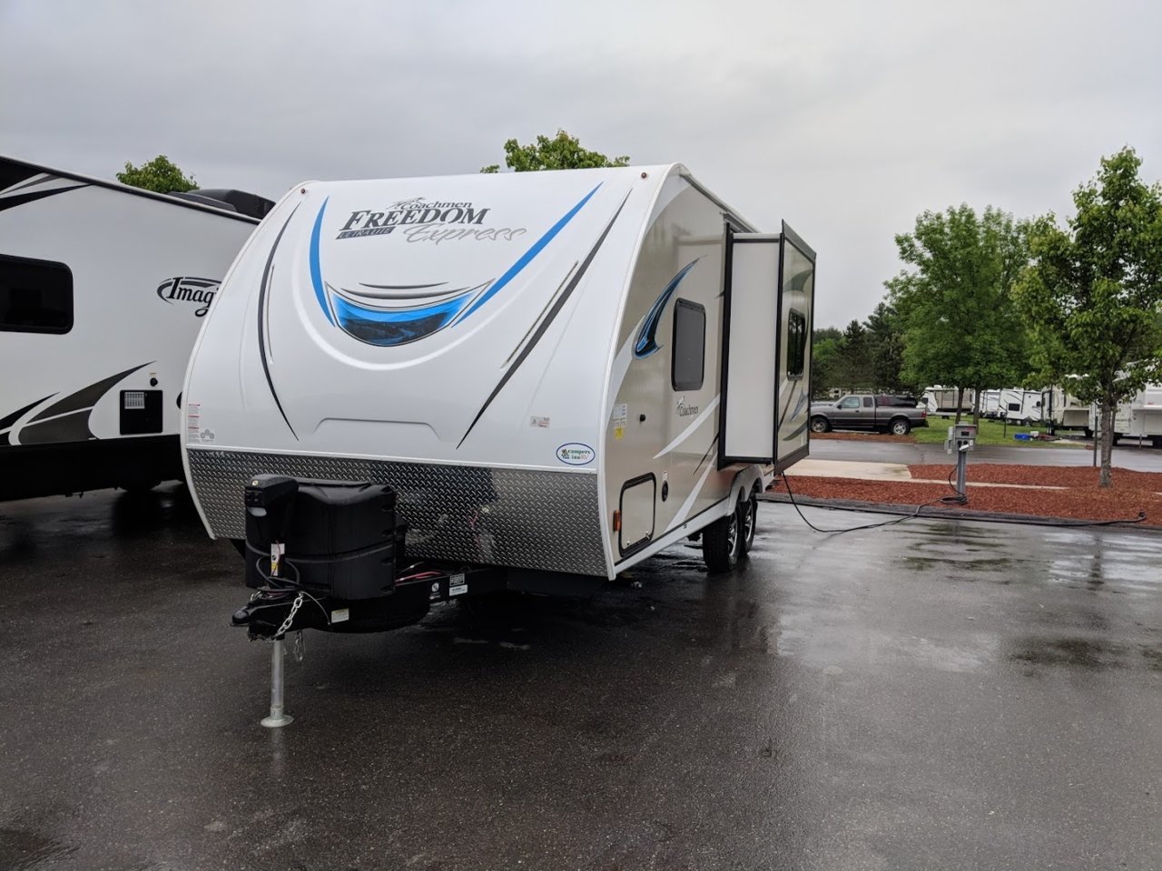

This is a Coachman Freedom Ultralite Express 192RBS. You can see from the floor plans in the link, that this is for the most part, the Queen's Castle. Us surfs got to sleep outside.

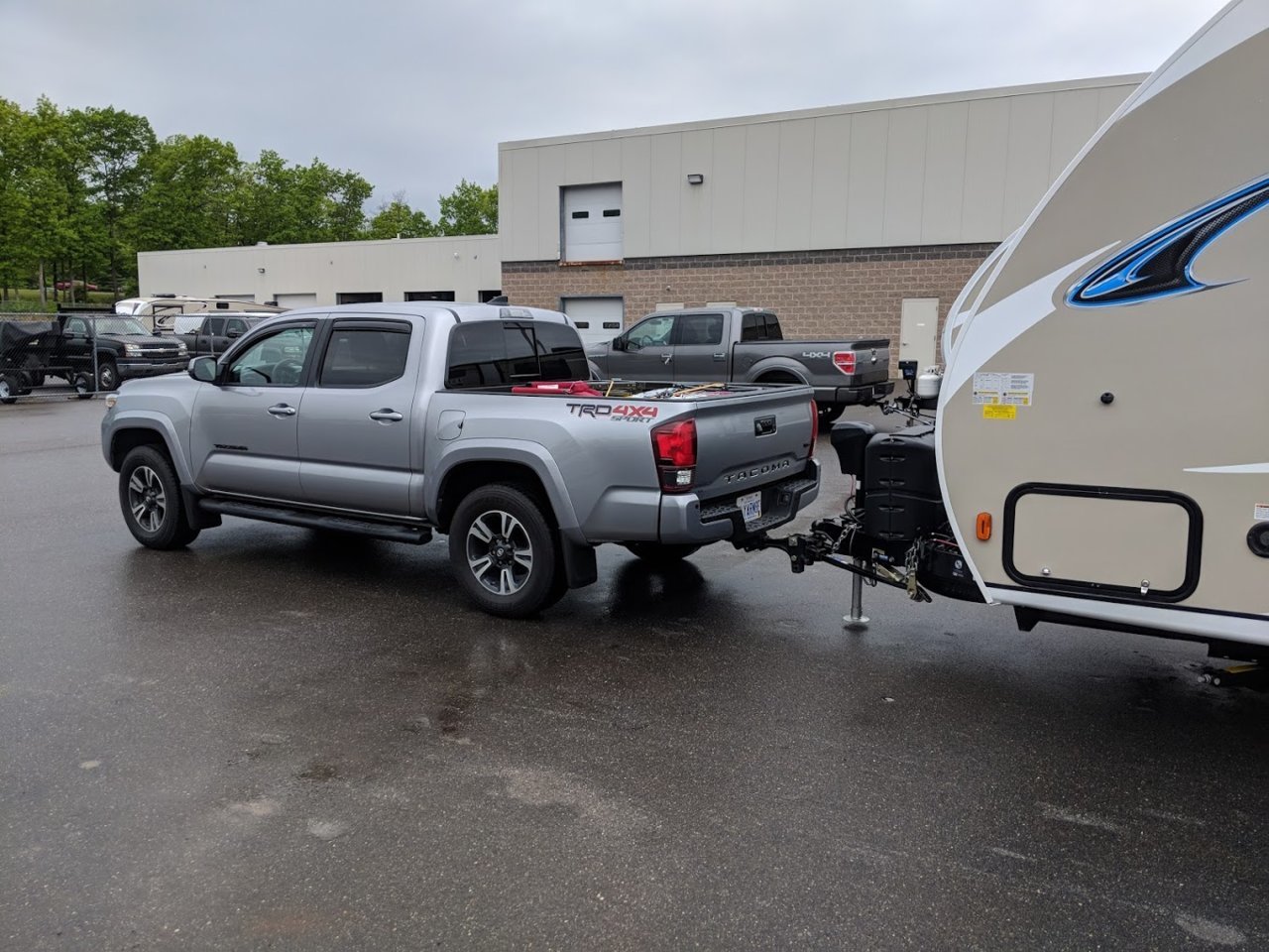

OK, so the trailer is a bit on the heavy side with a stickered dry weight of 1883 kg, or 4152 pounds. Dry weight isn't necessarily the whole picture though, and I'm willing to bet the trailer, as set up driven off the lot, was closer to 4500 pounds, probably a little heavier.

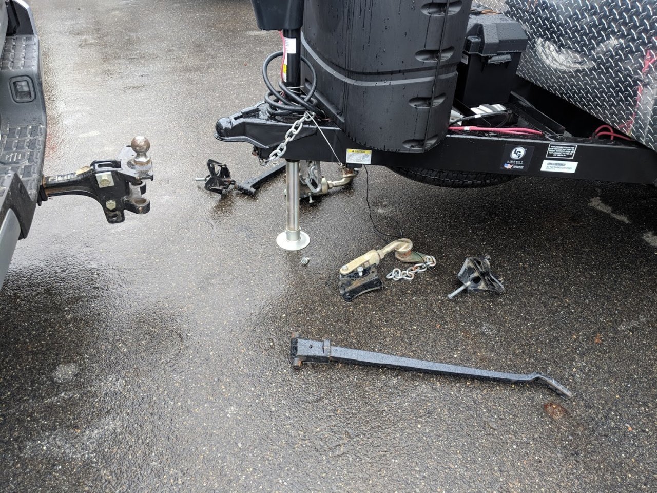

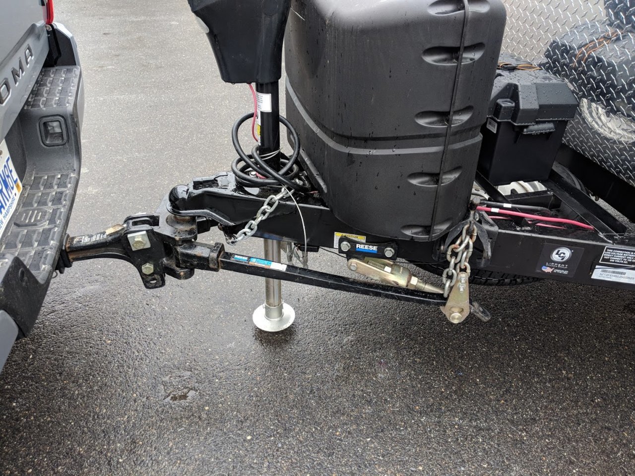

Which brings me to gear. As I posted quite a while back, I installed a Redarc Tow Brake controller, so I have the stopping part covered. What about the hitch part? The one thing I always want to make sure of over the last 2 trucks and trailers is not to sink my ass end. That said, I have owned a Reese Straight Line Weight Distributing hitch 10,000 system for over the last 15 years, and it has done me extremely well. I thought there was no sense in changing that up.
I had the camper dealership install and ensure that I had minimum sinkage:
hitch-1-jpg.2723592
hitch-2-jpg.2723593
hitch-3-jpg.2723594
I was pretty satisfied with the hook up, I think I might have sank about 1/4" overall.

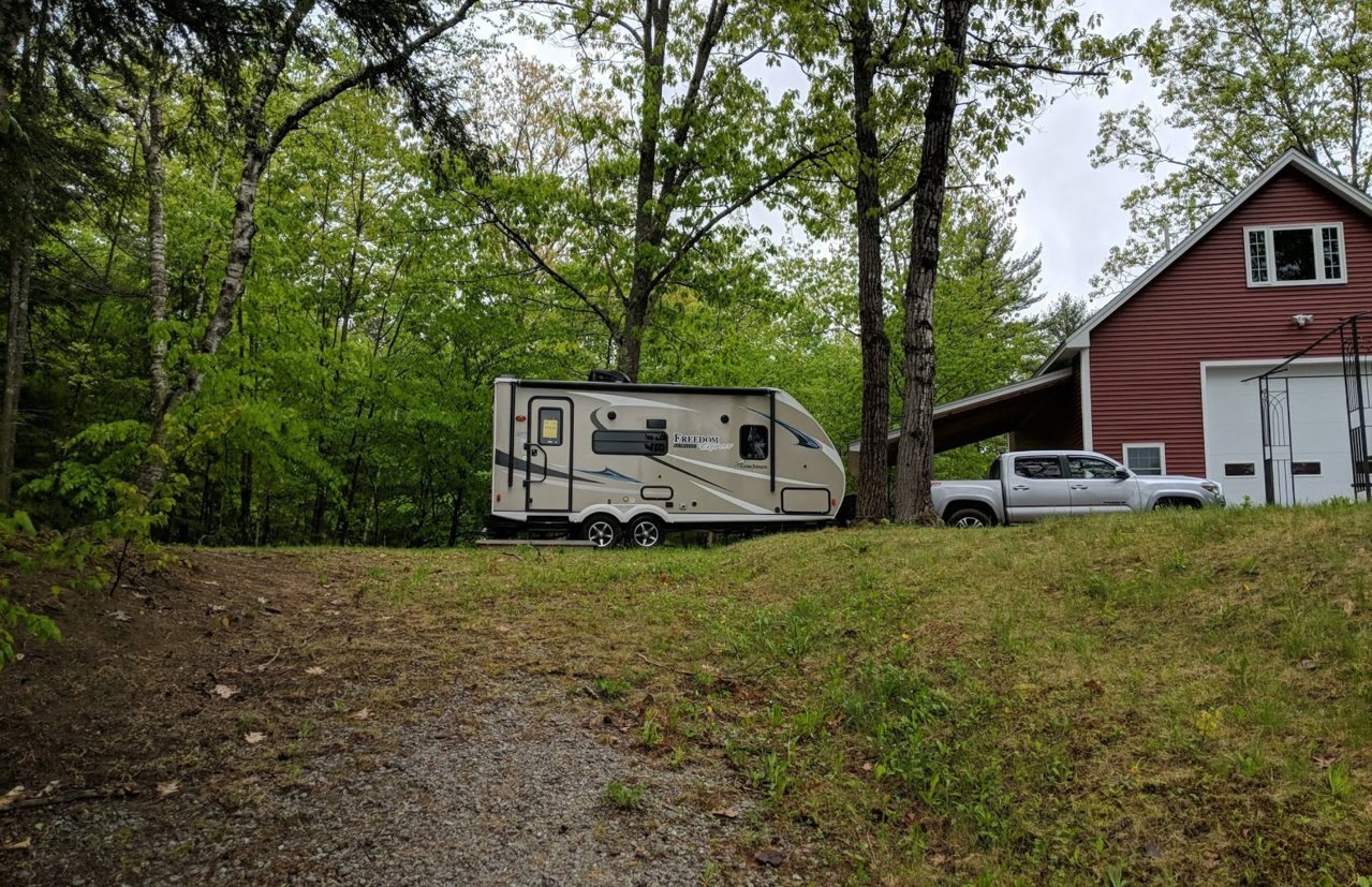

Got to the house, grabbed a water bottle and hauled up to the camp.
camper-4-jpg.2723603
Our property is 59 miles door to door. I live in New Hampshire, and the roads and highways are not exactly flat. I travel up the F.E. Everette to US 93, then on to Rt 4 for the remainder of my drive. I towed the trailer in S4, and had to downshift 3 or 4 times myself (and the truck shifted down at least 5 times as well). I had the ETC on the whole time. The trip was a little over an hour with speeds varying between 60-75mph on the highways, and between 35 and 60 on Rt. 4. I averaged 10.8 mpg for that trip.

In order to get the camper onto its pad, I have to enter through a gate, pull a huge u-turn through the yard, then back the camper between a tree and the garage, bank towards the driver's side at a 90* along the water facing side of the garage, then bank 20* to the passenger side onto the lot. Here is an old satellite photo (please pardon the crappy drawing on it):
property1-jpg.2723613
The Tacoma handled this chore very well. I usually have a spotter with me when I move the camper around, but yesterday it was just me, and I only needed to adjust my approach around the corner once. Nailed it:
camper-5-jpg.2723619
camper-6-jpg.2723620
camper-7-jpg.2723621

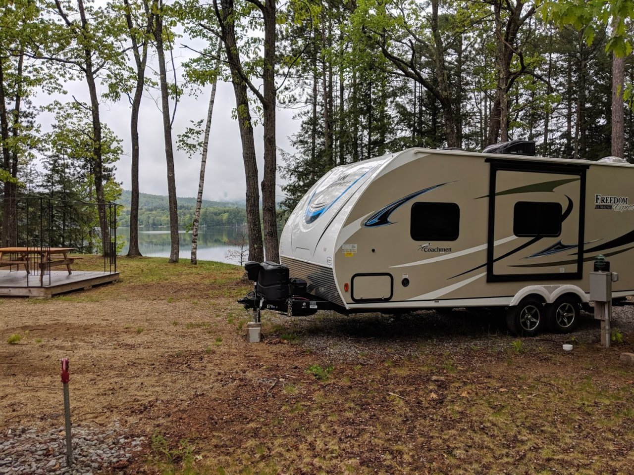

Of course, when the queen gets there she'll probably have me move it or something, so I hooked up nothing. Your eyes are seeing correctly, we have a 30/50 amp hook up as well as two dumping stations that go into our septic system. We purposely designed our system to handle 2 campers and a 5 bedroom house (in the future).

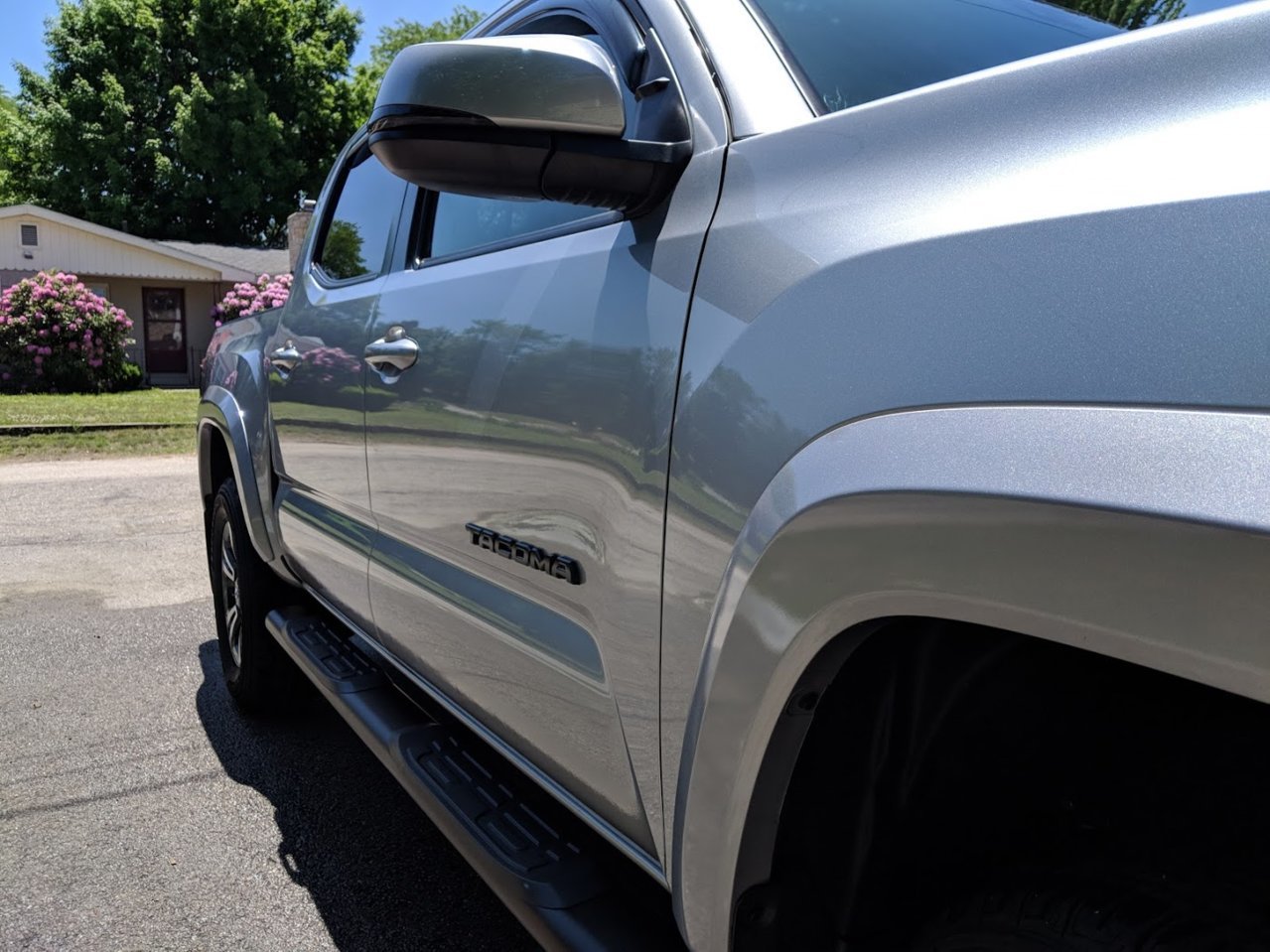

This weekend I had the opportunity to wash the truck and give it a once over with the F-11 Topcoat spray. The application is extremely easy, spray on, spread, buff out. I'm not entirely sure I believe the whole "lasts 6 months" claim, but I'll roll with it, and probably put another coat of it on next Sunday after camping. I will say this, it sure does shine up the truck nicely:
shined-up-jpg.2741501

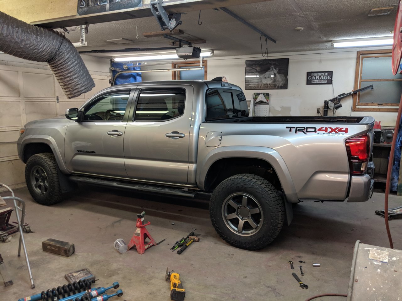

Talked to my cousin Saturday. We are finally all set to install the lift on June 21. We're going to work on it over night to get it done. Shouldn't be too much of a nightmare, as the truck just rolled 10k miles. Like mentioned before, it's a small-ish lift, 5100's all around, 1/4" spacer on the driver for lean, 1-1/2" Rogue Offroad AAL in the rear, OME 884 springs in the front. That will give me a better rake (I don't like the level look) and a better ride while on my meager off road excursions while camping up here in New England.

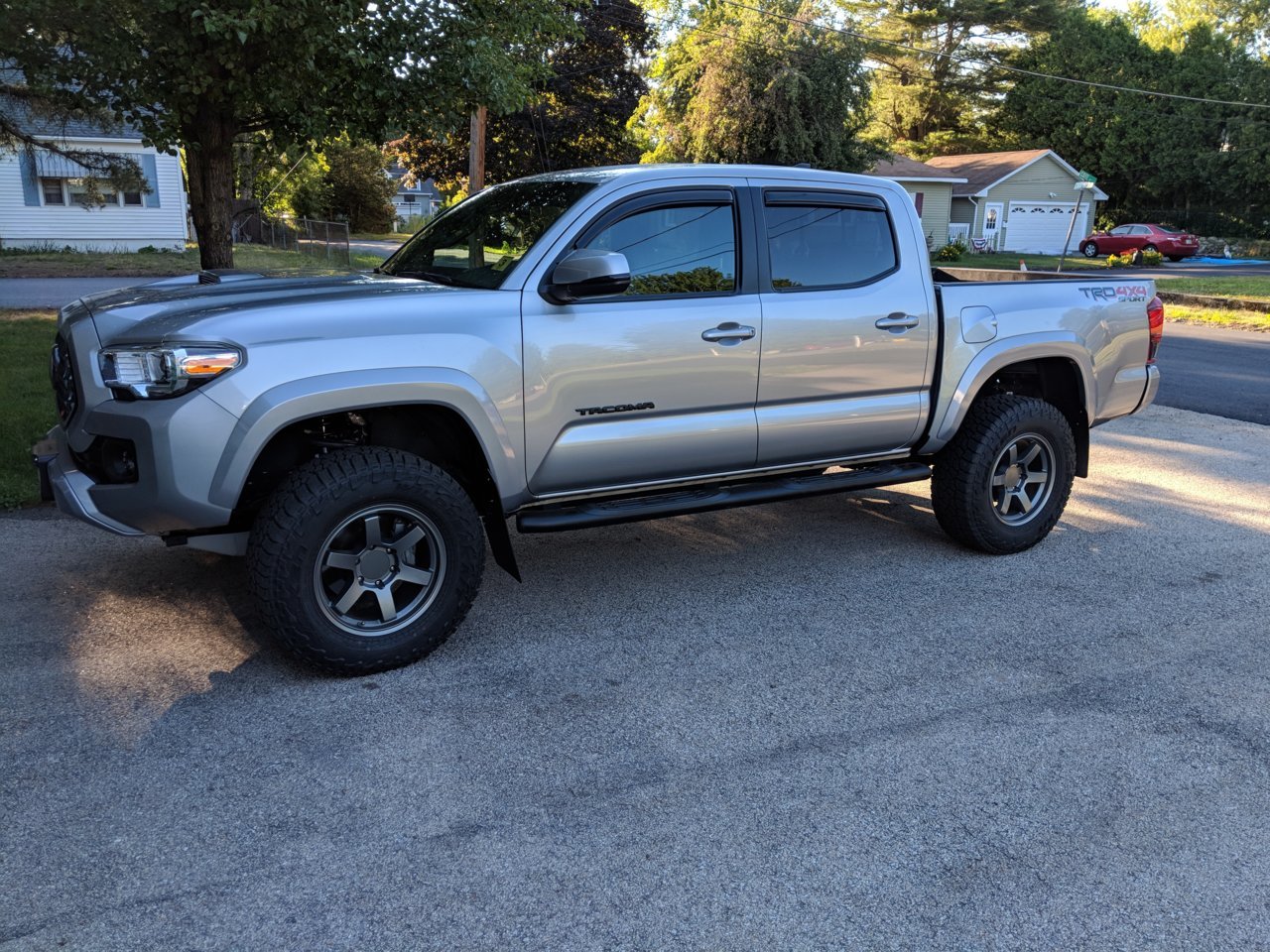

Yeah, I couldn't wait....
New shoes.
Wheels: Level 8 MK6 17x8", zero offset, matte gunmetal with Falken Wildpeaks A/T3, 265/70/17 standard load. There is rub right now at full turn, but that's getting taken care of with my lift later this month.
It's amazing what wheels and going one size up on tires does for the stance/look of these trucks.

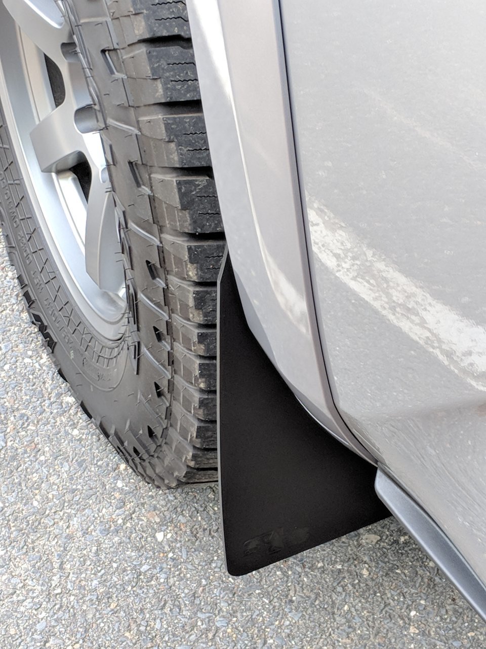

The Rokblokz come in this week.
RokBlokz

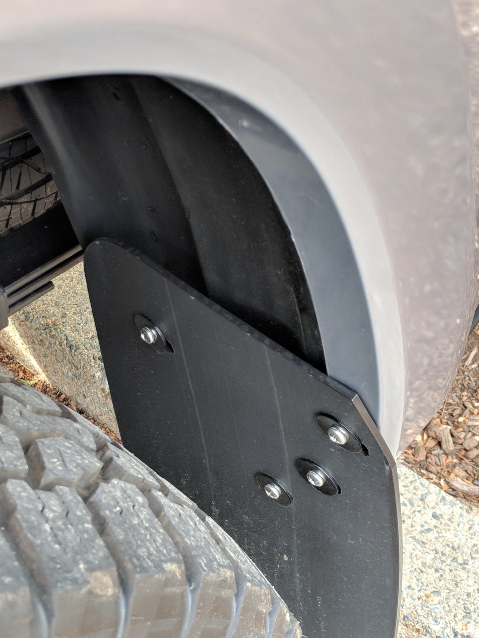

Because the tires I bought were a little oversized, going from 265-65-17 to 265-70-17, i had a little bit of rubbing on the OEM mudflaps only. It occurred just before full turn, and the edge of the tire was rubbing on the very center of the OEM mudflap.
After a bit of research, I decided to purchase the RokBlokz mudflaps. They are a bit on the spendy side ($149.95 right from the manufacturer) for what they are (stiff plastic with holes), but they were easy to install, look very clean (I purchased the black flaps with black logos) and offer the protection to the paint from dirt, pebbles and debris being flipped up from the tires.
For the fronts, there is a cut out section for "oversized tire fitment" that I utilized, pulling the flap further away from the tire.

As you can see from the interior pictures, there is a gap that looks as though it may collect mud/dirt/debris in the wheel well.
img_20180618_083504-jpg.2762796
Overall I'm satisfied with my purchase in the "near term". I say this because I'd like to see whether or not the gap does collect debris. The flaps offer a clean look, protection to the paint, while mitigating an rubbing.

Last night, me and my cousin installed my "small lift". I call it a small lift because it certainly isn't as tall as 3/4 of the lifted trucks on this site. I got a set up that fits my needs, which were:
a. better ride than the Hitachi suspention
b. better ride on some of the sketchy camp roads
c. light off-roading
d. a bump up in hauling capacity
e. aesthetic beauty (LMAO)
So bearing all this in mind, I went with the following set up:
3rd Gen Bilstein 5100 PN 24-239370 (on bottom setting)
Bilstein 5100 Rear shocks
OME 884 Springs
Headstrong Offroad 1/4" spacer (for driver side lean)
1-1/2" AAL (This AAL was from Rogue Off-Road)
The 5100s (front and rear) and the AAL came as a kit from Rogue Offroad, and is called the Tacoma Stage 1 lift.
The OME springs and spacer came from Headstrong (I like to spread money around to small businesses).
Start Time: 8:02 PM
Fuel: Mountain Dew

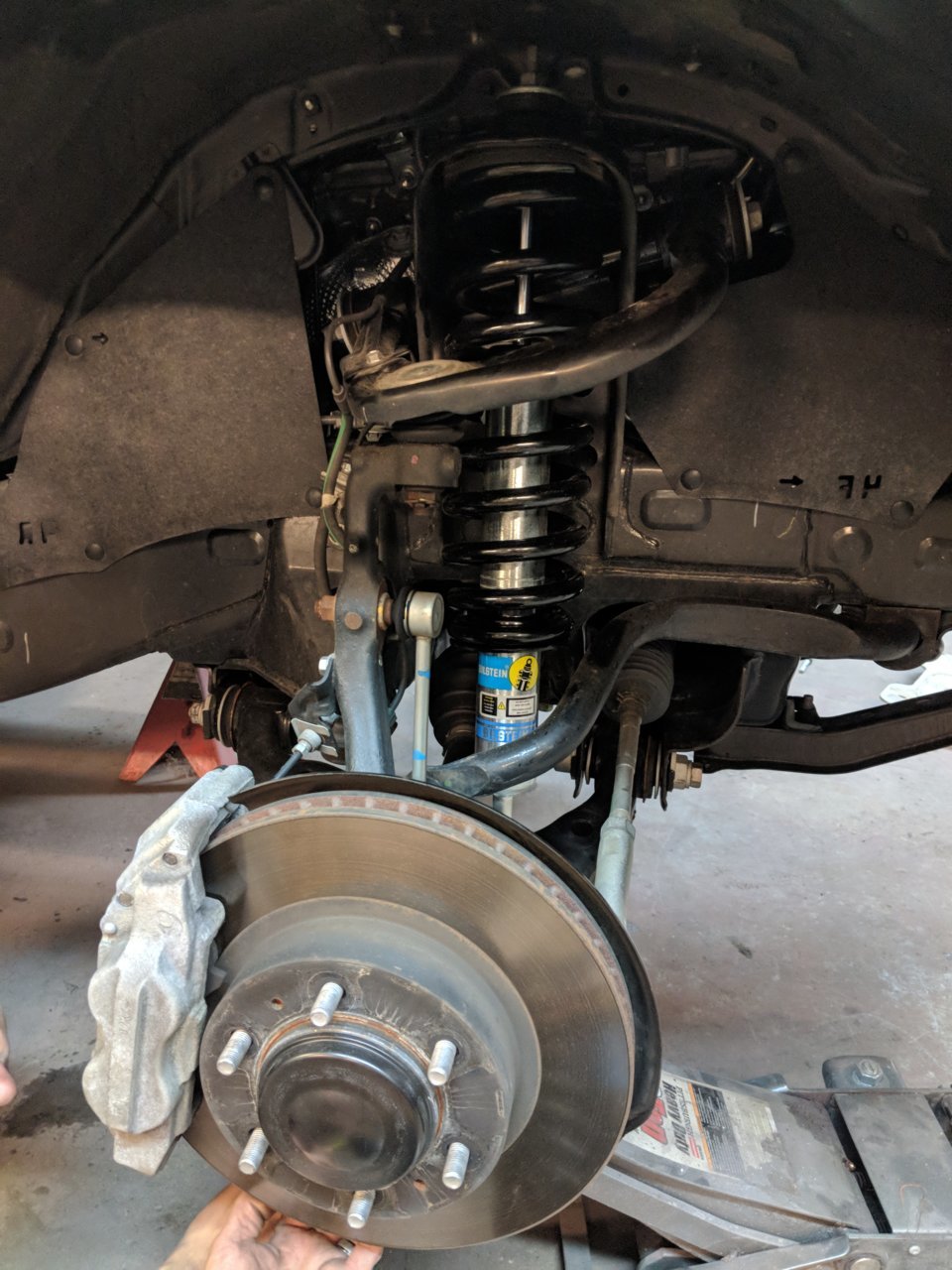

We put the front end on jack stands, and removed the wheels. We followed these two videos for taking off and putting on the front shocks and springs:
We started off with the passenger side because that was the most simple of the front, because we were not taking off the shock's top hat to add a spacer like on the driver side. Following that video, from the time I pulled in to the garage, to the time we had the new shock on (not including time to torque to specs), was 32 minutes.
img_20180621_203609-jpg.2768993
You read that right.
Murphy's Law showed up while doing the driver's side, but it was 100% MY FAULT. We got the OEM shock off, took the top hat down, put the spacer in, put the top hat back on it, put the new shock/spring in, and could not fasten it. The lower control arm was waaaaaay down. So after much back and forth, we went to the spring compressor.
Then I realized that the bottom seat for the spring was on the shock upside down. We flipped it around, fastened the top hat to the shock, and installed easily.
With that fuck up by me, we had the fronts done in 1 hour and 45 minutes. Keep in mind, we had air tools, the truck just crossed over 11k miles, making everything very easy to take apart.

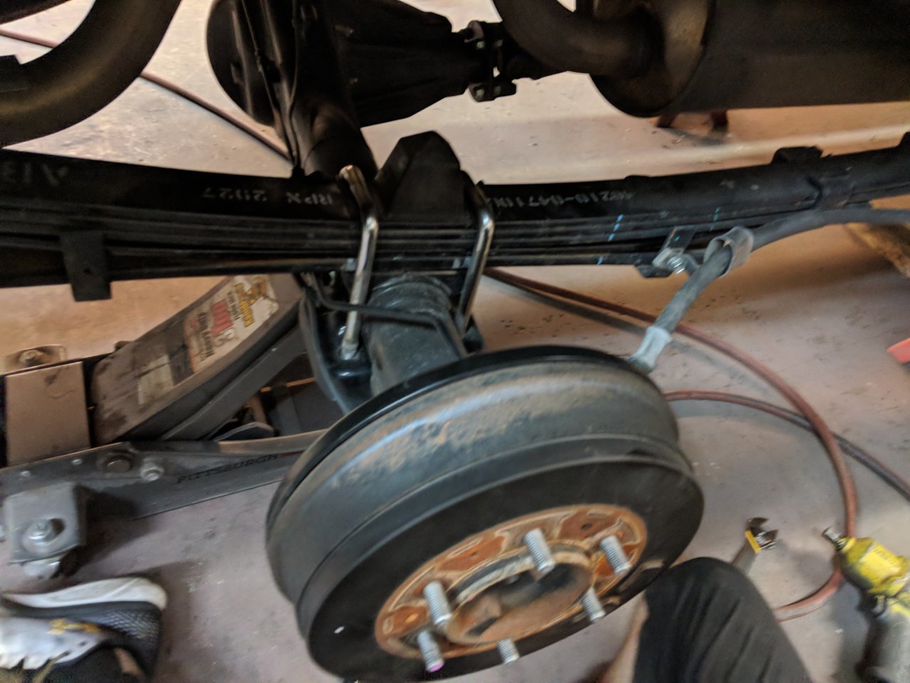

Items of note. The shocks are self explanatory on this. They come out very easy, and need to be removed before tackling the AAL install. However, before lowering the axle to get the new leaf in there with the much longer setting screw, you MUST disconnect the guide/fasteners for the break lines.
The rears took a little longer because after we got the first one done, we took a break and had a beer LOL.

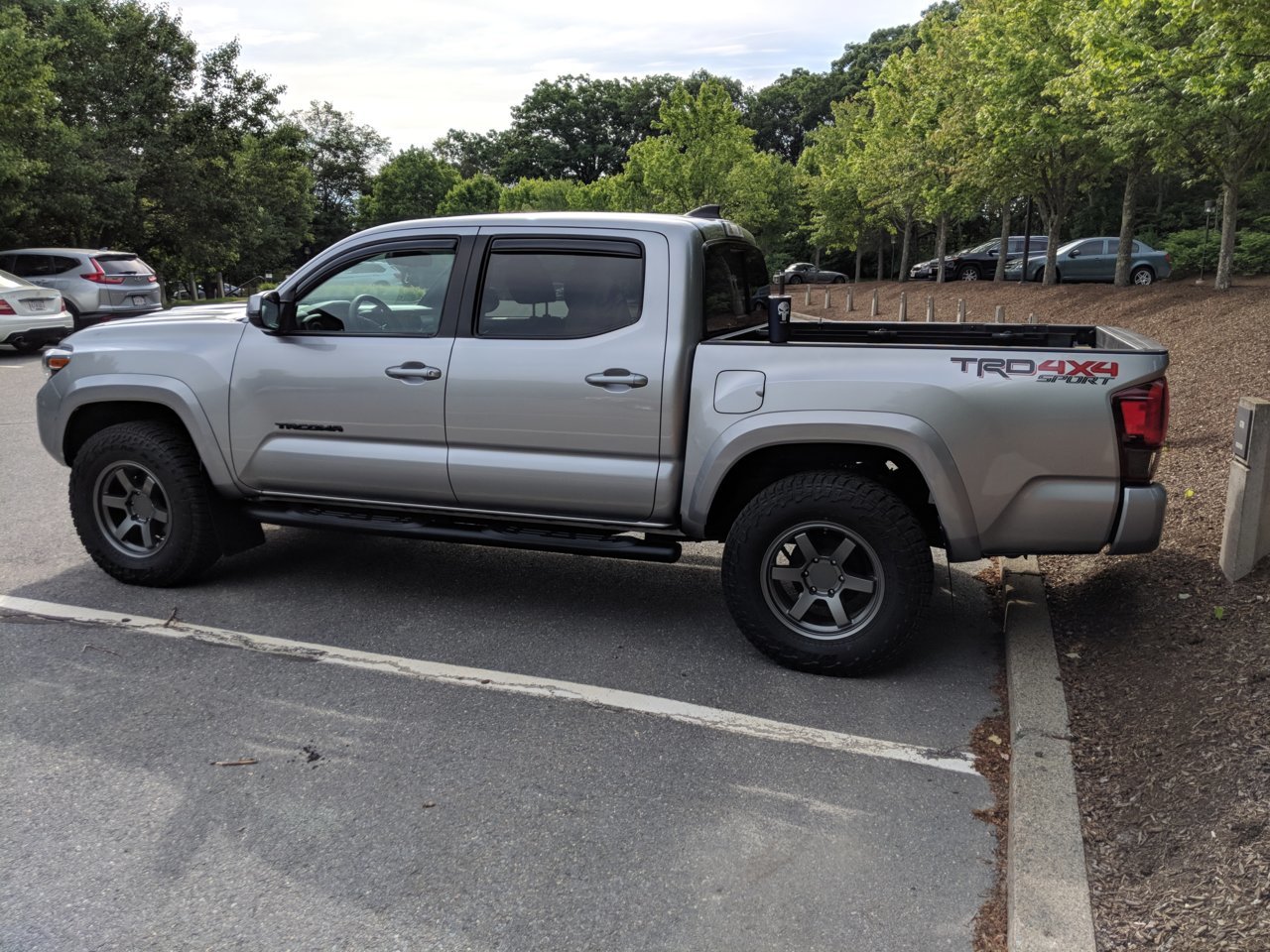

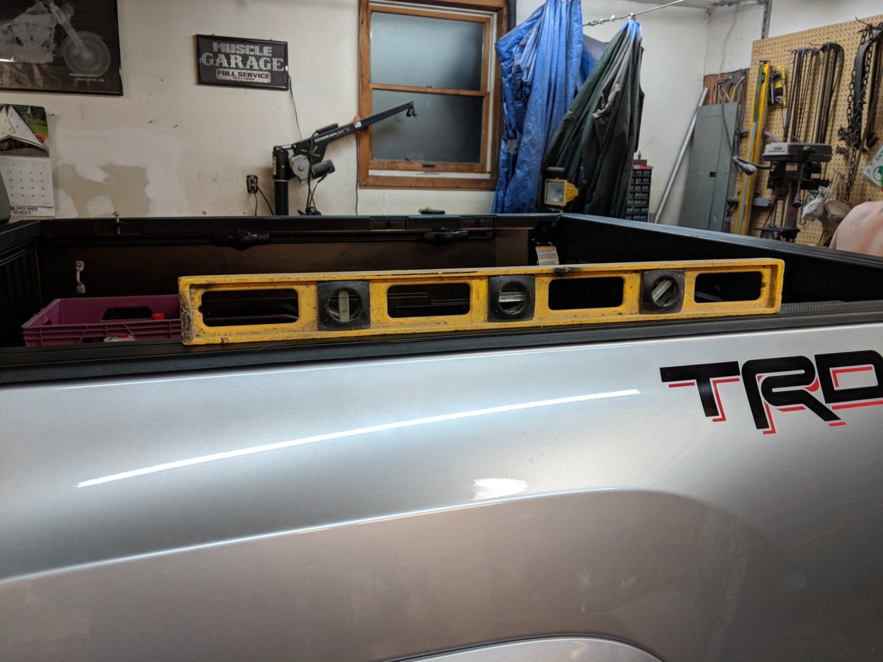

Results and measurements:
I measured my height a while back, and I'm pretty sure I did it wrong, but I went from the ground to the top of the wheel well. Some folks do it from the center of the wheel, some folks do it from the top of the tire. I'm pretty sure that it's supposed to be from the center of the wheel, but oh well. These initial measurements were made with the stock Sport wheels, and OEM tires (265-65-17) with the OEM cover on it:
Driver Front - 35-1/8" Passenger Front - 35-1/4"
Driver Rear - 35-5/8" Passenger Rear - 36
Post lift install measurements with new wheels and new tires: (265-70-17)
Driver Front - 37-9/16" Passenger Front - 37-9/16"
Driver Rear - 39-1/2" Passenger Rear - 39-1/2"
Talk about nailing it! However, to get the net lift from the suspension alone, we have to subtract 1" for the tire change. That said, net lift numbers work out like this:
Driver Front - 1-7/16" net lift Passenger Front - 1-5/16"
Driver Rear - 2-7/8" net lift Passenger Rear - 2-1/2"
HeadStrong's handy dandy chart states that Bilstein 3rd Gen 5100s with OME 884s on a DC 4x4 will give 1-1/4" lift. I hope I don't settle that much LOL
There is rake
img_20180621_235309-jpg.2769028
img_20180622_000648-jpg.2769029
Of course this is all going to change as it "settles".
All wrapped up, pre-alignment
mvimg_20180621_233504-jpg.2769024
mvimg_20180622_070402-jpg.2769025

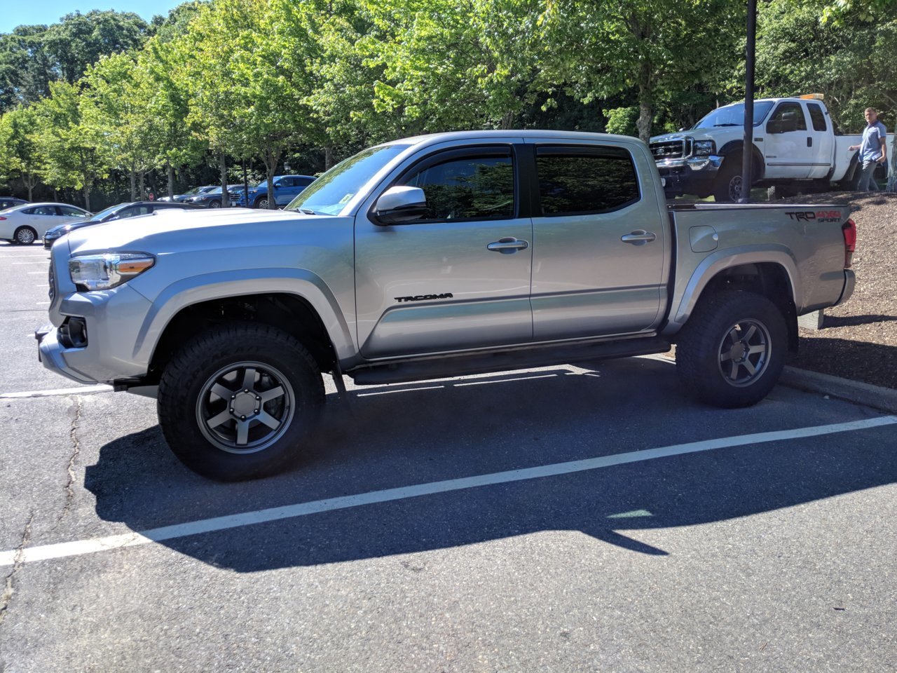

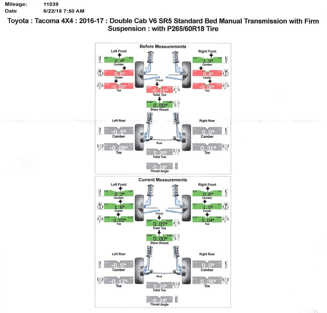

"Small Lift" install (2 - Alignment and thoughts)

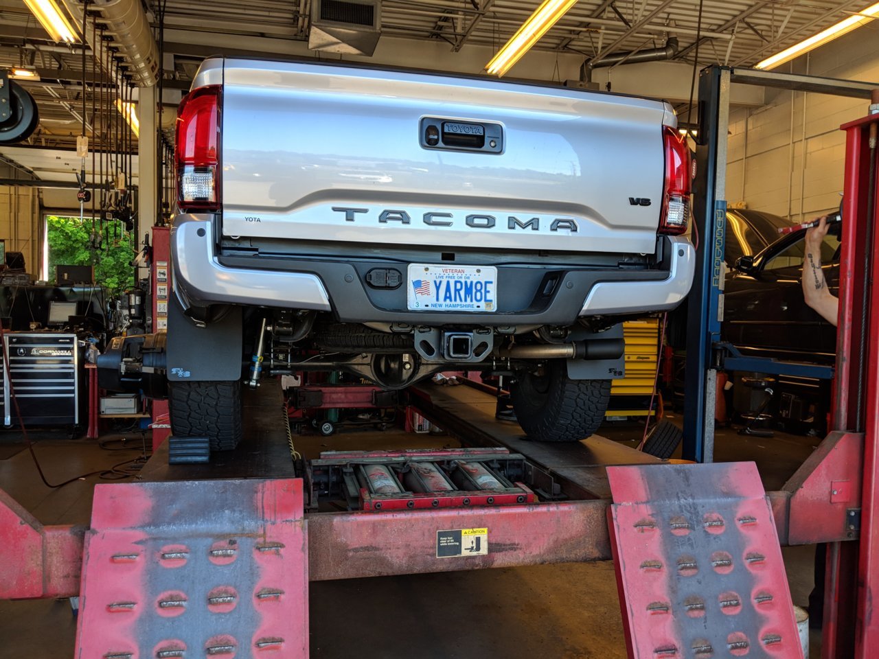

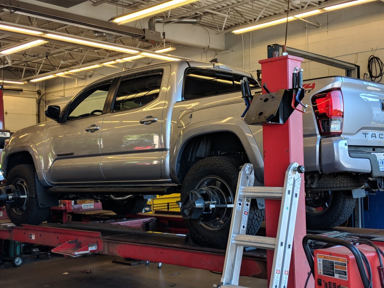

Knowing that I was going to be installing the lift last night, I scheduled an appointment for the alignment for this morning at 7:30. My cousin suggested a particular tech that we both knew and I booked it. So this morning, my truck went in.
mvimg_20180622_074544-jpg.2769032
mvimg_20180622_074719-jpg.2769033
Took the tech an hour and a half, but that was due to him showing me the machine, how he was going to go about doing it, and bullshitting about my cousin.
lift-alignment-jpg.2769042
Post alignment:

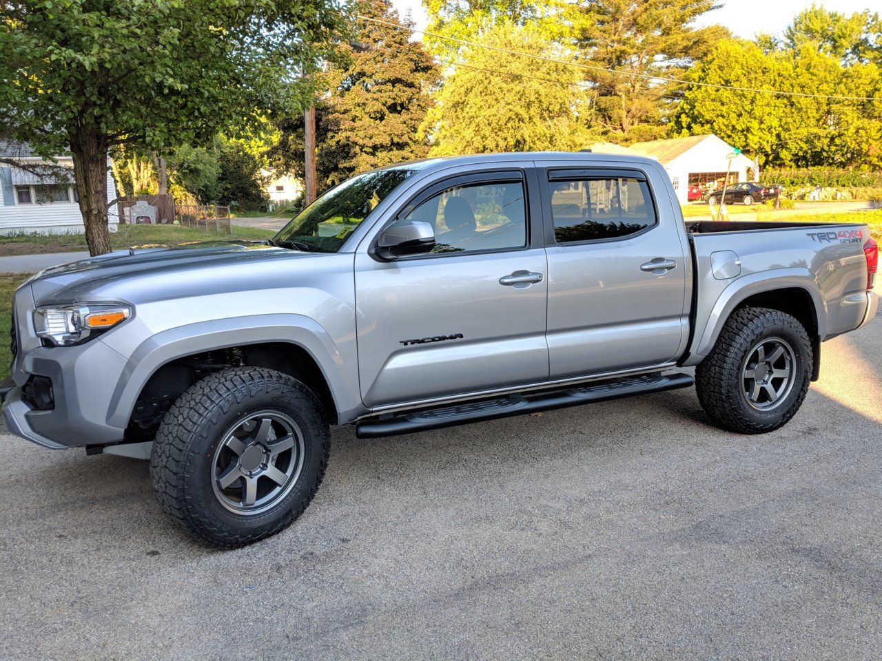

mvimg_20180622_093627-jpg.2769045
Thoughts:
I really thought this was going to be much more difficult than it was. However to be fair, my cousin is a gear head, had the space, the tools and the time to make it way easier than it would have if it was just me.
Butt Dyno:
It feels as though the ride is more "plush". The bumps aren't as jarring as they were with the Hitachi shocks and OEM springs. I feel as though I got the rake that (in my humble opinion) the truck should have. There's a bit of work that needs to get done for the rear alignment, and I'm going to need advice on that, as only the fronts got done (the rears are grayed out?) The truck tracks nice and straight (and did last night and this morning pre-alignment honestly), and right now I am extremely happy with my decision to go through with this.

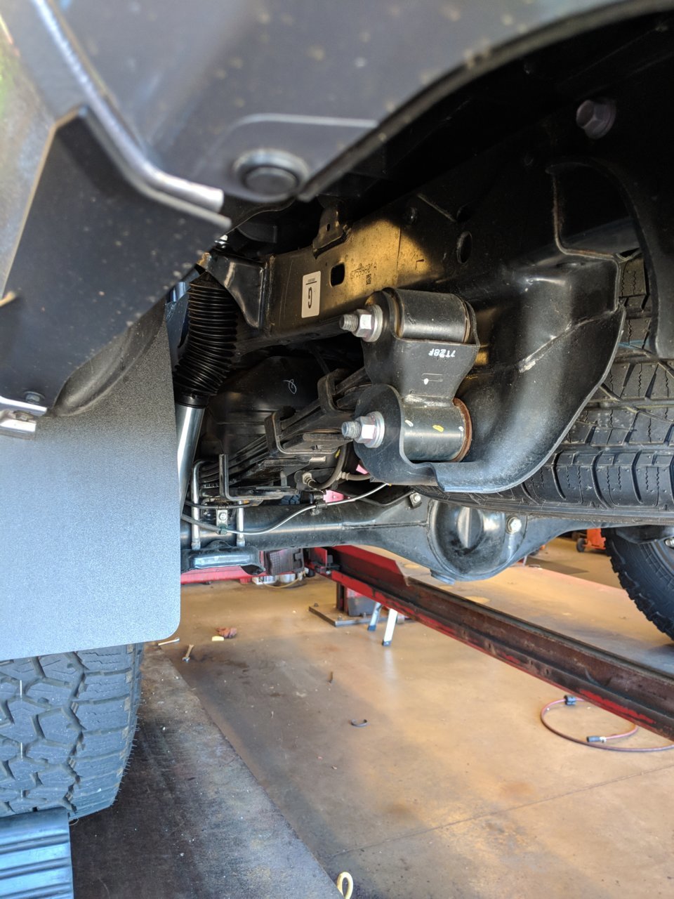

Oh yeah! I took a close up of the rear spring because I was amazed at how much of a difference the AAL made in the leaf pack. Before I installed it, that pack was dead level, and now it has a nice curve to it.....
img_20180622_081224-jpg.2769074
