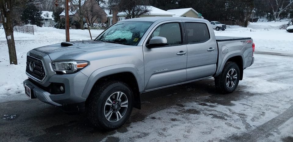

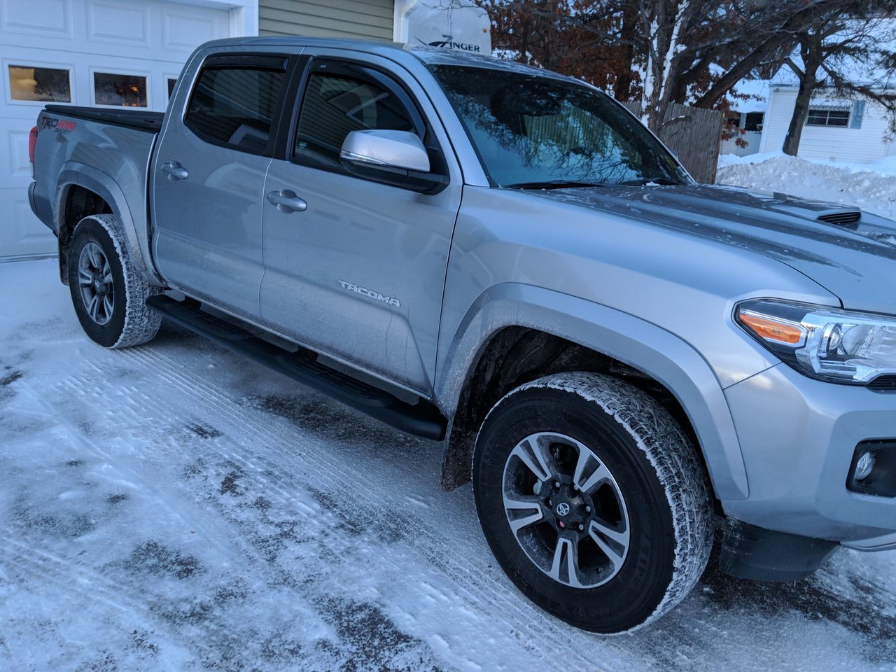

Up to date as of 1/02/2019. As it stands today:
now-jpg.8996

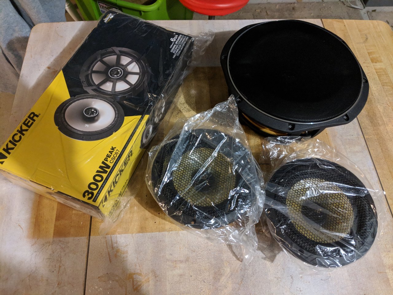

Last set of speakers came in. I am sending back the Kicker 6x9s. I've decided to use a set of unused old school PPI 6.5" woofer drivers in the front door instead. So these are the last of the speakers.
The PPIs friggen pound, so there will be no sacrificed low end in my truck.

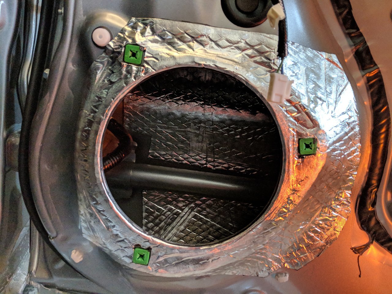

Jan 15: Rear speaker install

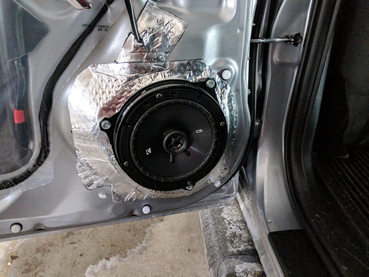

Today I got a couple of hours interruption free so I installed the rear kickers. These doors are way easier to remove than the Tundra's we're.
My back was screaming due to a "jump" I did at Cannon mountain in zero vis. I did not see said jump, and did not stick the landing. Skied the rest of the day anyways. Boy am I feeling it today though.
Anyways, I only put the 80 mil Noico inside the door and around the mount area. I'm not coating the whole damn door again. Waste of time and resources, and I'm trying to just use what I have on hand.
I am having everything shipped to my office to mitigate questions from the wife, so the custom adapters for the front doors are sitting there. Will try to get those in this week.
Honestly, this head unit pushes the Kickers (tweeters and rears) very well. I'm not sure it's going to push the PPIs though, but that's why the amp is coming with harnesses.
mvimg_20180115_133303-jpg.2505453
mvimg_20180115_142400-jpg.2505454
I used the small grommet hole to put speaker wire through and Noico'd that as well.
So far, I'm not disappointed at all.

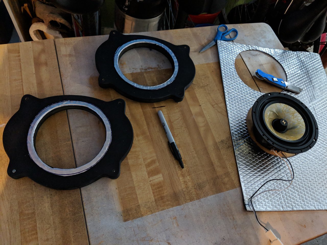

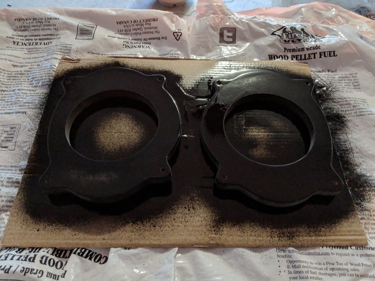

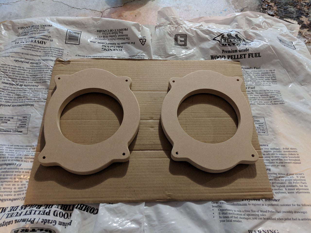

Jan 16: Front speaker mounts
Got my front mounts in today and am coating them for moisture protection.
mvimg_20180116_160639-jpg.2507611
mvimg_20180116_160728-jpg.2507612
mvimg_20180116_162421-jpg.2507613
Hopefully I can use the snow day tomorrow to install the PPI drivers

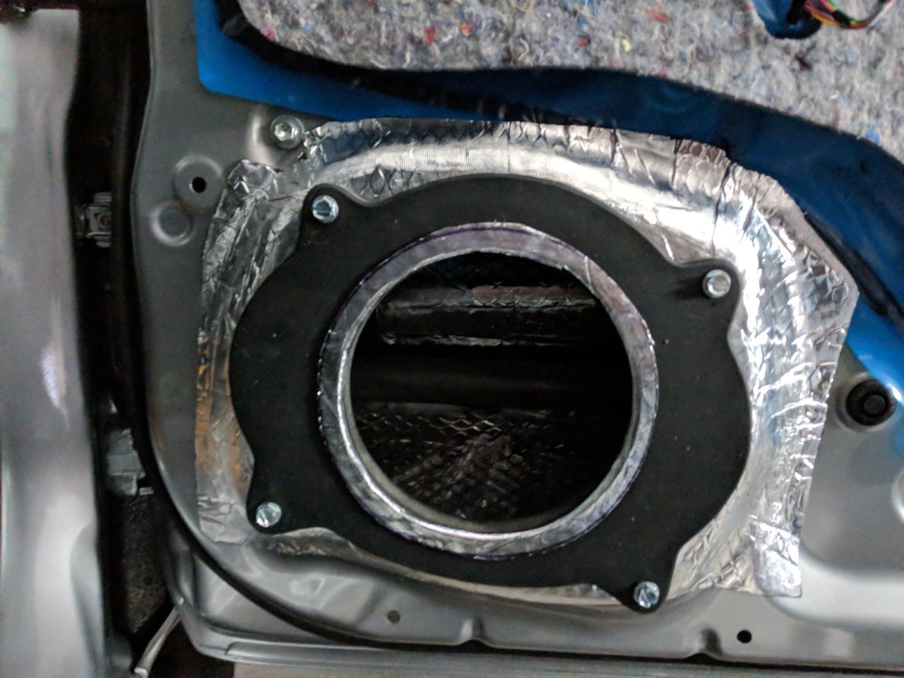

Jan 17: PPI Install (fronts)
Baby steps. Paint cured nice on my pellet stove.
mvimg_20180117_120106-jpg.2508758

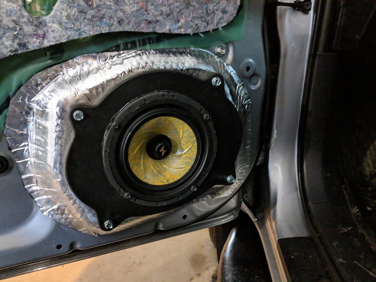

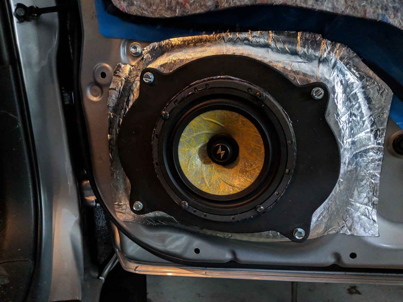

Speaker install completed. As I suspected, the head unit does not push the PPI speakers well at all, but they are still light years better than OEM. Once the amp & sub gets in there, it'll be all business in the front, party in the rear. Like a friggen 1987 mullet (you know you had one).
mvimg_20180117_134750-jpg.2509114
mvimg_20180117_145219-jpg.2509117
mvimg_20180117_152951-jpg.2509119
Total time per door including the Noico is 30-40 minutes each. If you cut the strips that are going in the door ahead of time, it cuts down the time. It took 1 sheet per door, and I have some left over to put behind the back seats later on when the sub box gets in.

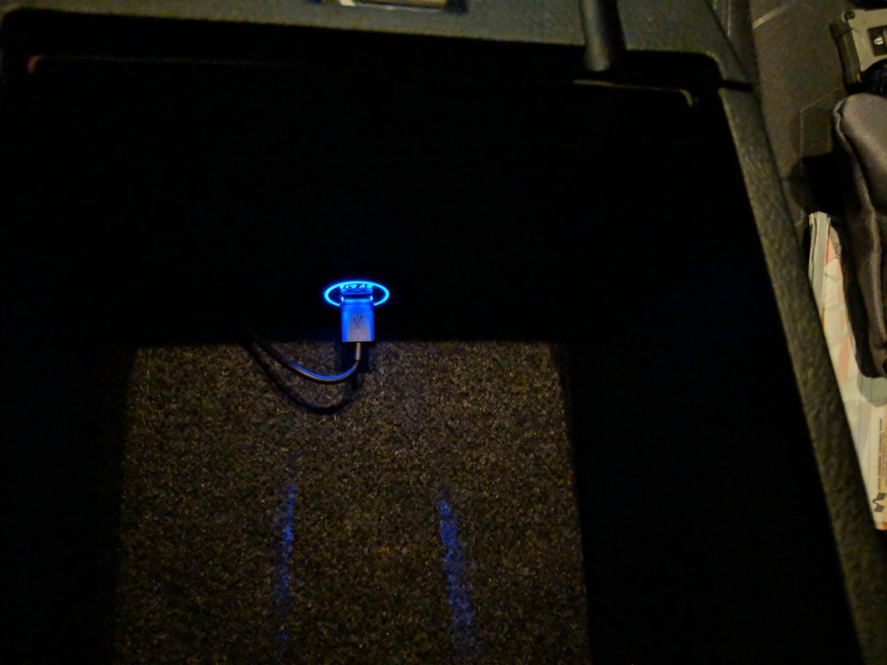

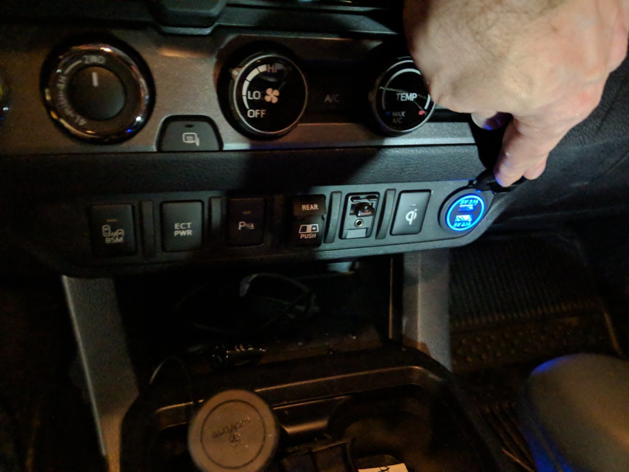

Feb 5: USB charging ports installed
So I'm waiting on a few things but got some goodies in the mail today, so I installed this little item.
mvimg_20180205_172308-jpg.2543591
And using the fantastic directions by @tonered found here:
https://www.tacomaworld.com/threads...-3rd-gen-today.399305/page-3842#post-17070853
I put in the other USB outlet. I use this one to recharge my watch.
mvimg_20180205_194245-jpg.2543912
I also ran my charger cord underneath the console and came out between the charging pad (which is useless to me) and the left cupholder.

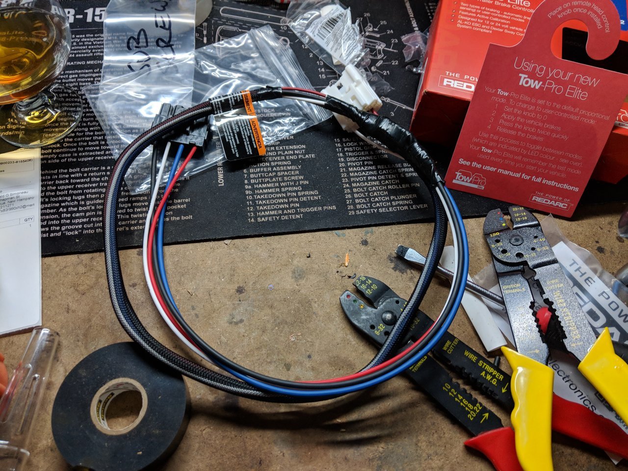

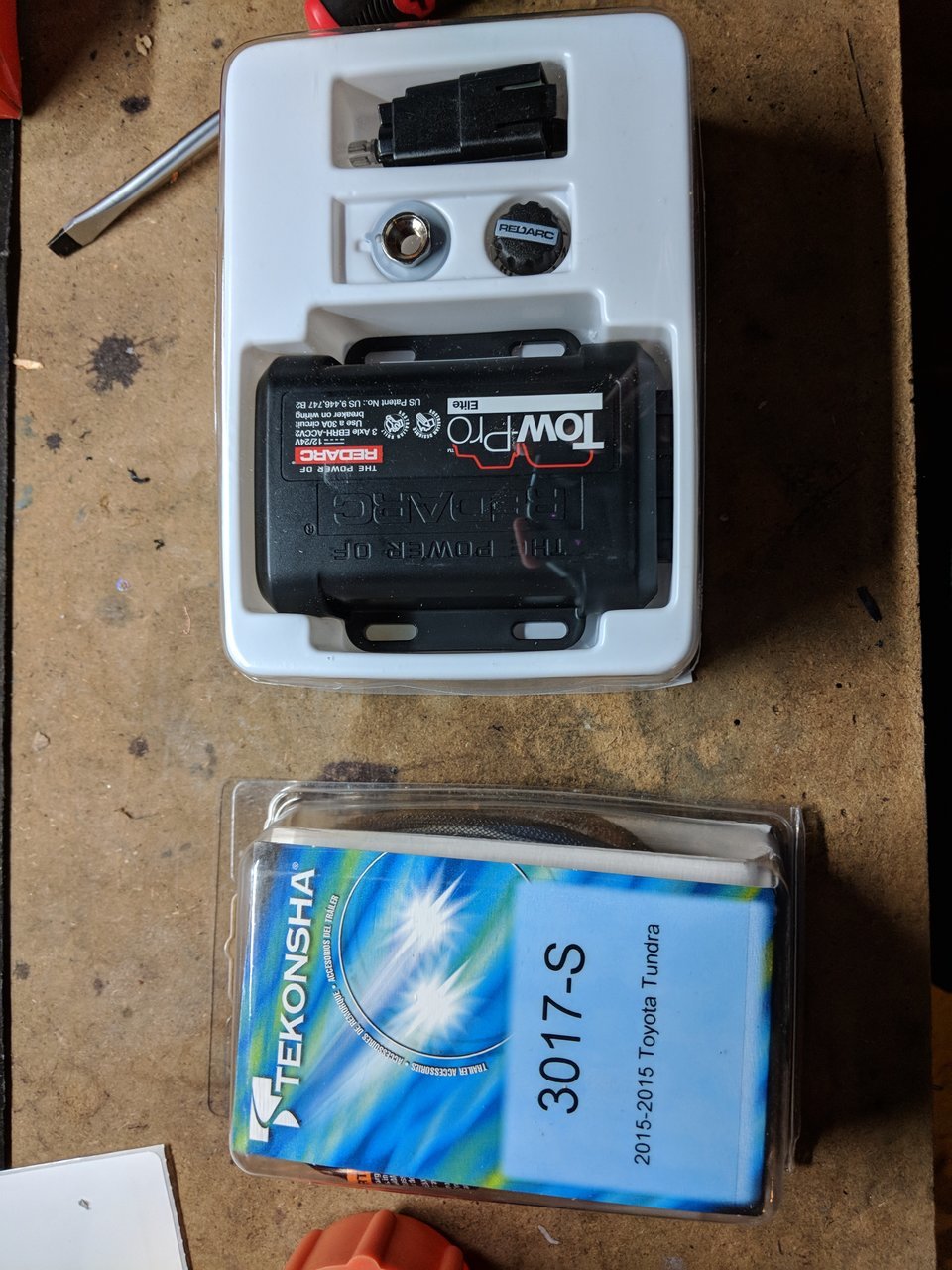

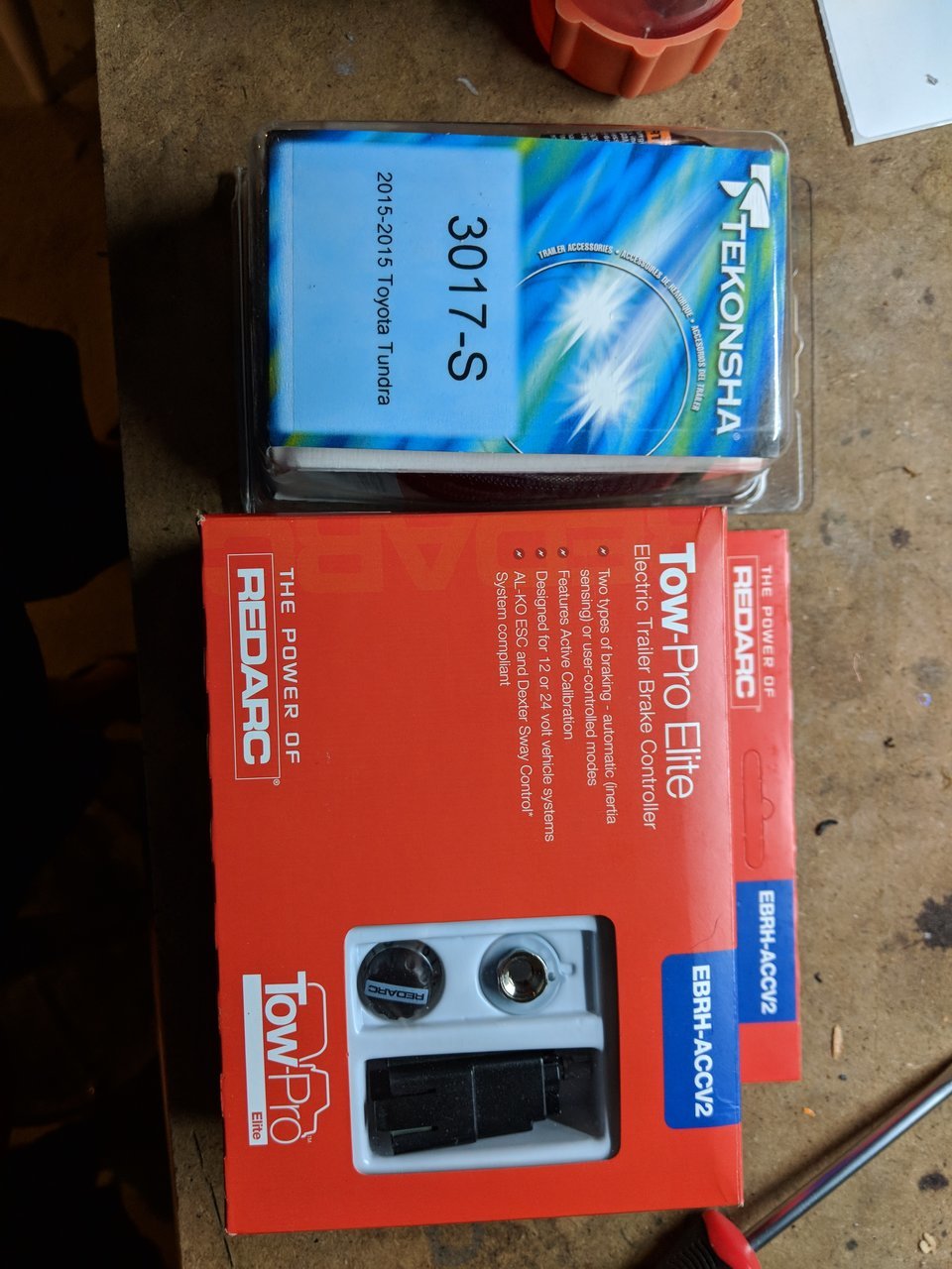

Feb 9: Redarc Tow Pro Elite came in
Hoping for a few things to come in tomorrow. Today though, the Redarc Tow Pro Elite came in. I can't install it yet, waiting on the switch plate to come in for it. Then, I found my soldering iron won't start (butaine) so I used the connectors that came with the unit.
mvimg_20180209_195923-jpg.2550199
Sweet looking unit, can't wait to get it installed.
img_20180209_194305-jpg.2550200
mvimg_20180209_194252-jpg.2550201

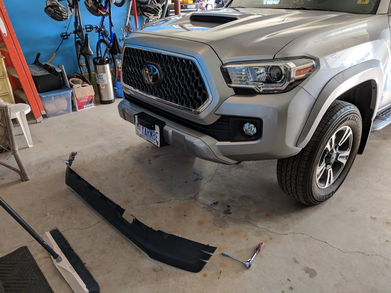

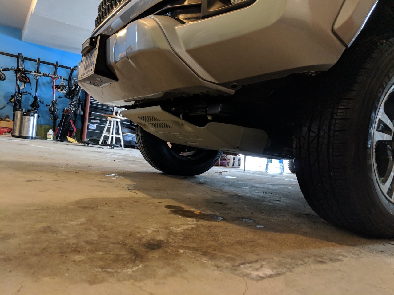

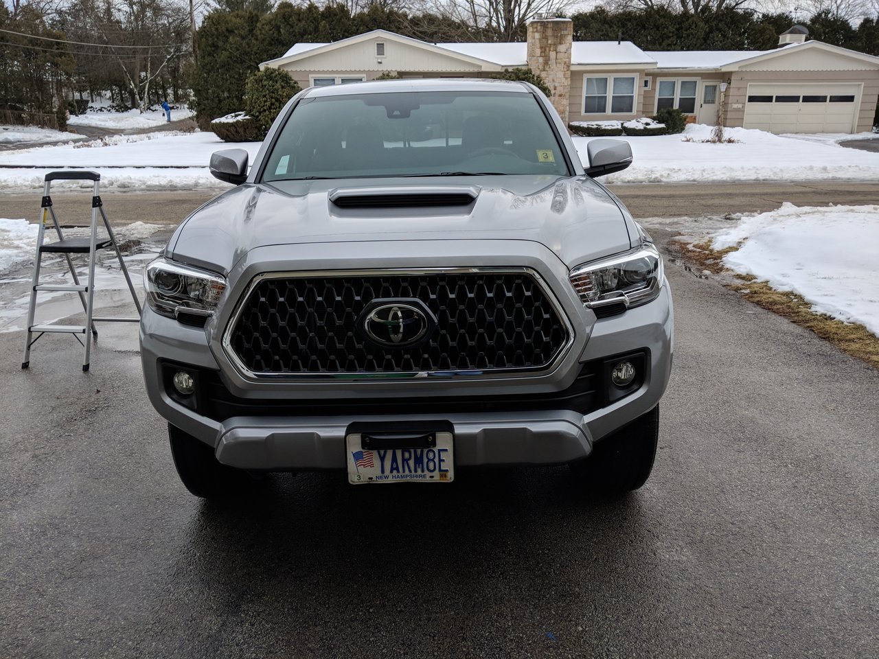

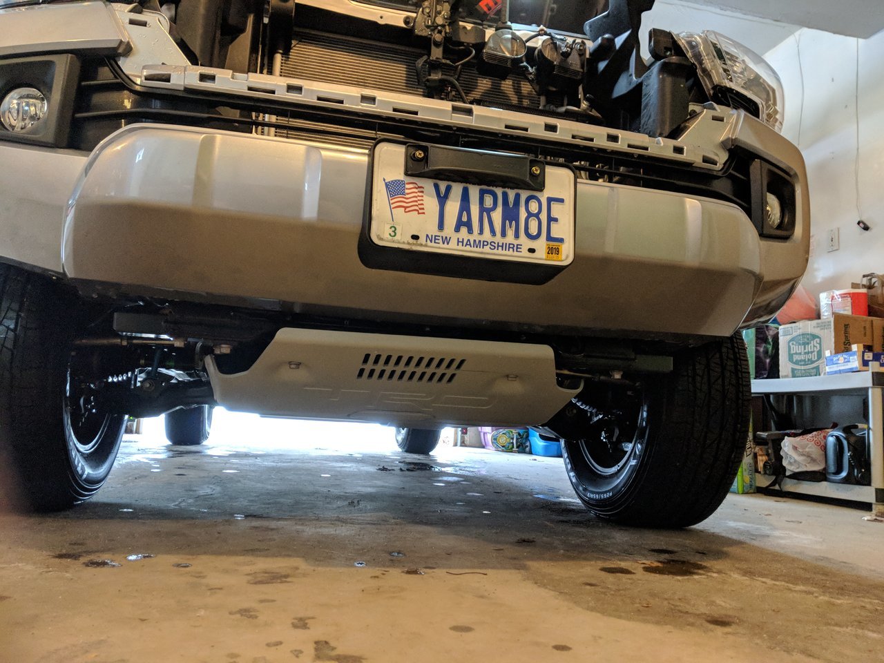

Feb 10: Skidplate and grille bezel install
Little things today:
First, a nice bath with hot water
img_20180210_142515-jpg.2551525
mvimg_20180210_142525-jpg.2551531
mvimg_20180210_142532-jpg.2551535

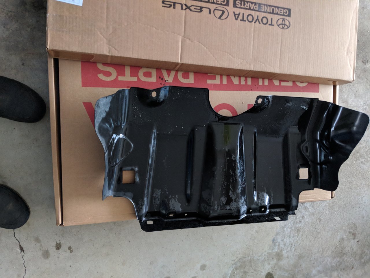

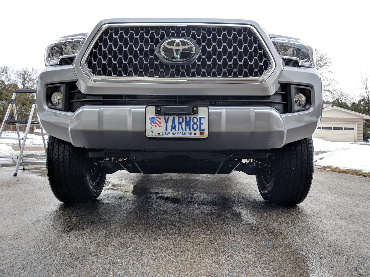

Then skid plate
img_20180210_142743-jpg.2551536
img_20180210_143456-jpg.2551537
mvimg_20180210_152313-jpg.2551538
mvimg_20180210_154023-jpg.2551542

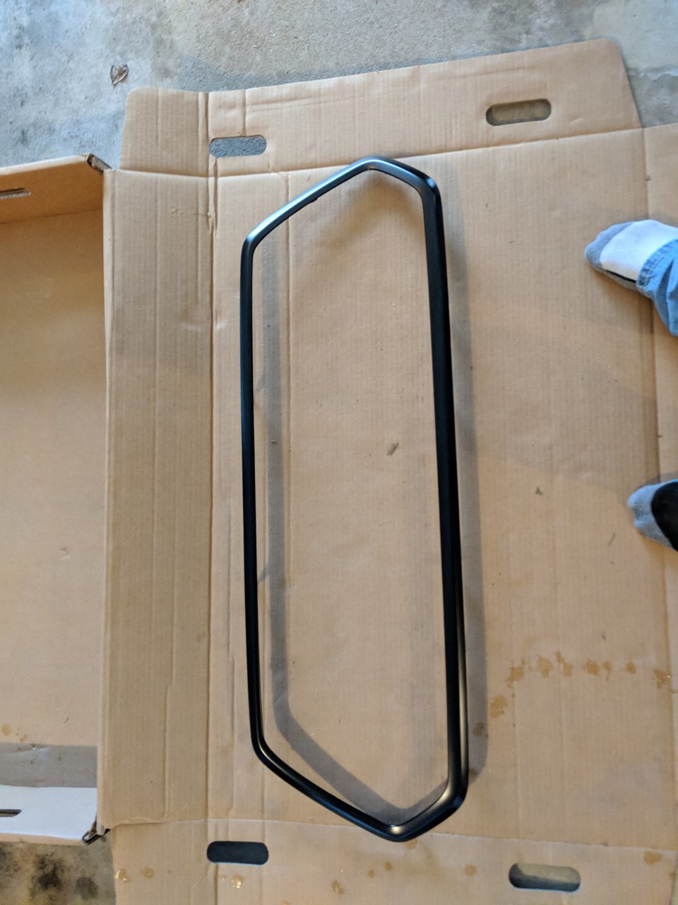

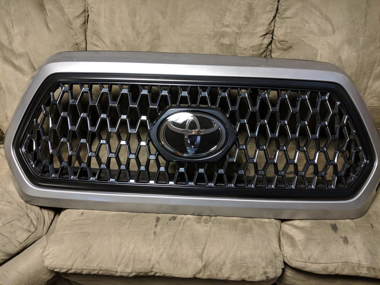

Then Grille bezel swap
img_20180210_152304-jpg.2551548
img_20180210_152812-jpg.2551550
mvimg_20180210_153804-jpg.2551556
I like the grille that the 2018 Sport comes with. I think there are too many Pro and Faux Pro grills out there, and I'm all set with that. Also, there are zero aftermarket grilles that support the TSS right now.
I went with the TRD skid plate because this truck probably won't see any serious off-roading other than some camping trips with sketchy access roads. Any lift this truck gets is going to be asthetic in nature quite frankly, and won't be until it's time to get new tires.

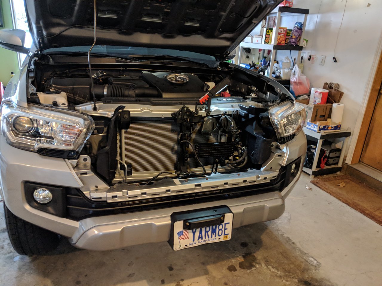

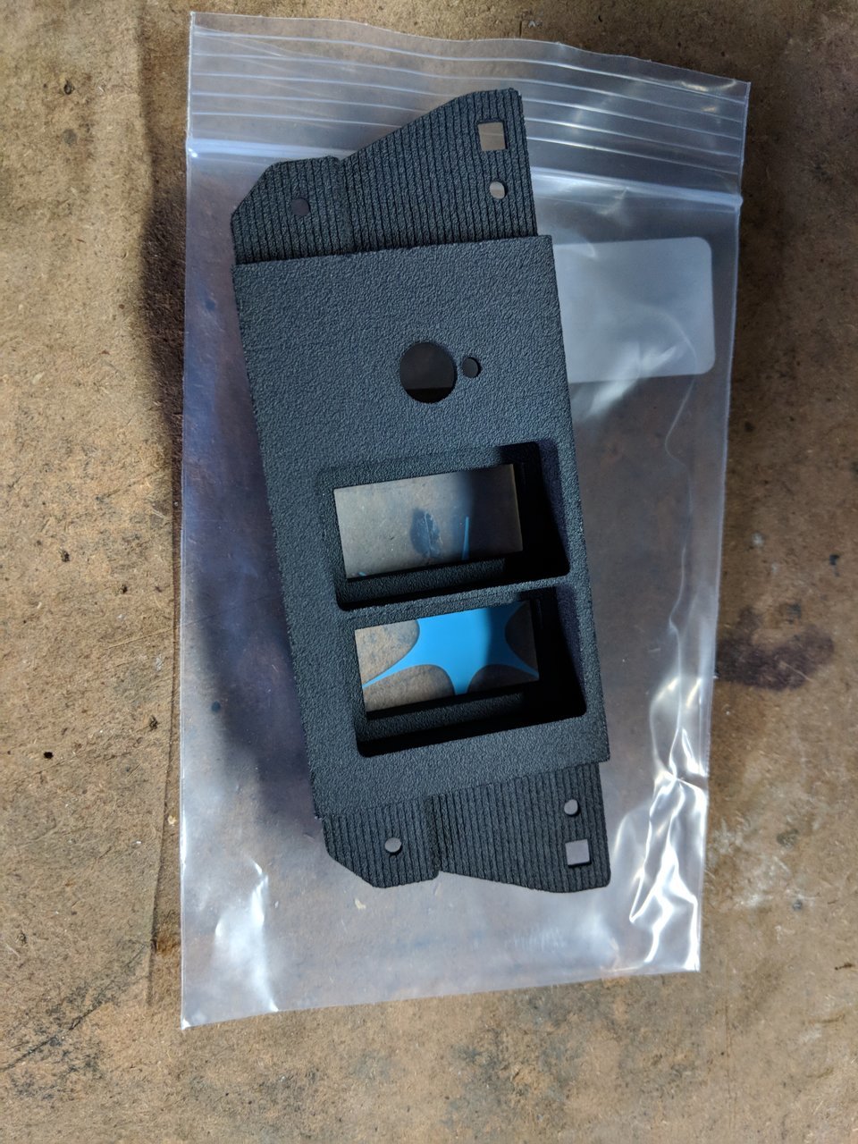

Next item to be installed is the trailer brake, I'm just waiting on the switch plate for that. After that, sub and amp....
mvimg_20180210_153013-jpg.2551554

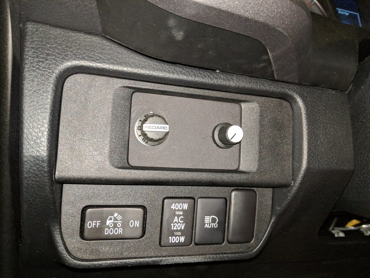

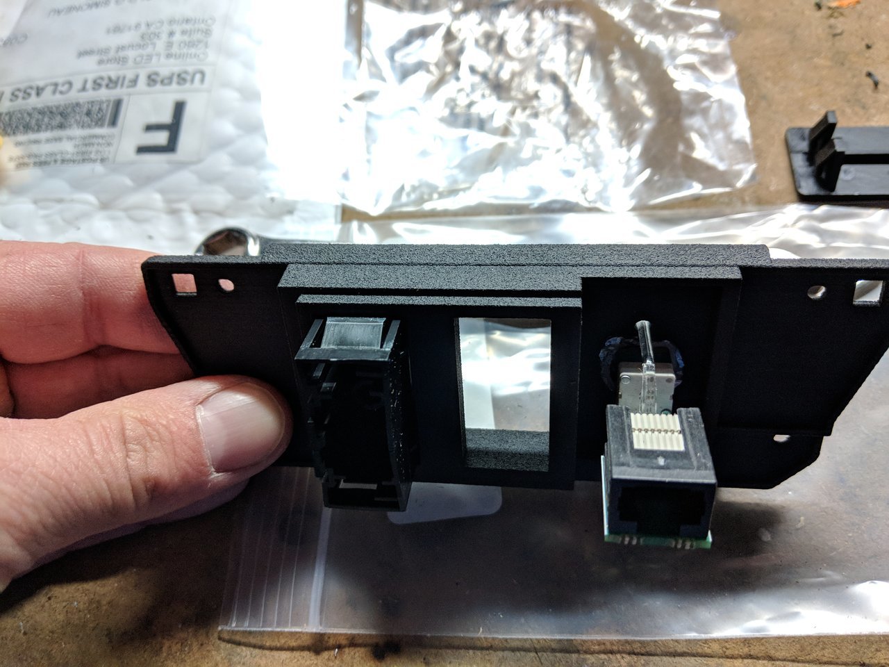

Feb 12: Redarc Installed with switch plate #1.....
Finished up putting in the tow brake. Nice out of the way install. Great design by a member here @forty2 (I think?). Need another cover for now, but I do have plans for those spots....
mvimg_20180212_170121-jpg.2554938
img_20180212_173335-jpg.2554939
mvimg_20180212_173346-jpg.2554940
mvimg_20180212_173936-jpg.2554941
redarc-jpg.2556044
I needed to put a washer in to tighten the unit in firmly. Other than that, pretty clean finish. The other spots will have my sub nob and reverse on demand/front camera (maybe).

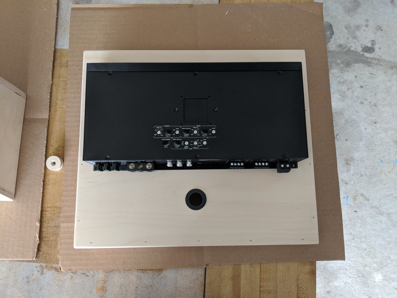

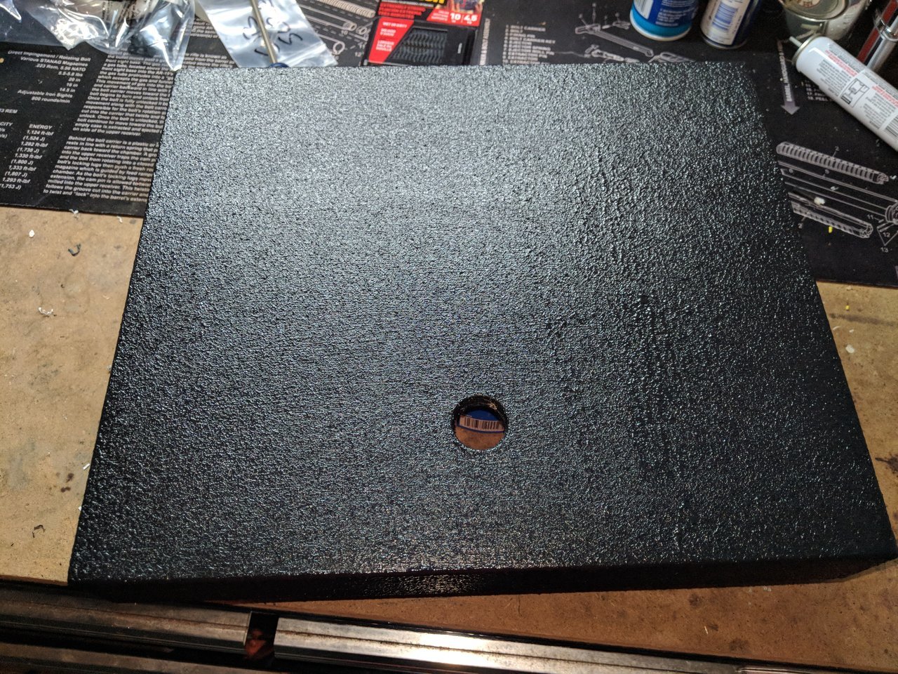

I put a hole in the amp rack for the wires
mvimg_20180217_151442-jpg.2562995
mvimg_20180217_151503-jpg.2562996
I have other things to do with the sub box/rack before they go in. It needs wood filler and painting, and I'll do some of that this week. @Mr Marv does beautiful work.

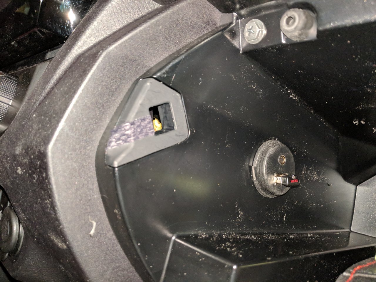

Today I had the opportunity to move the USB to the glovebox. I'll be honest here, I somewhat fucked this up by putting the hole too far back. I couldn't reach far enough back to properly tighten the retaining nut, and now I feel as though I need to take the whole glovebox apart to correct my fuck up.
img_20180217_162700-jpg.2563000

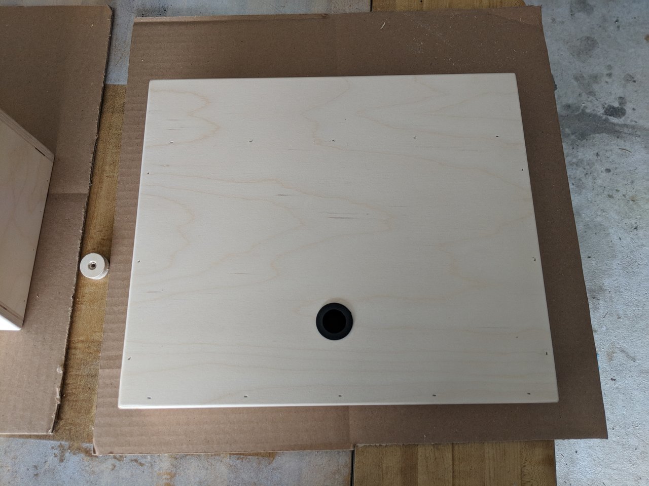

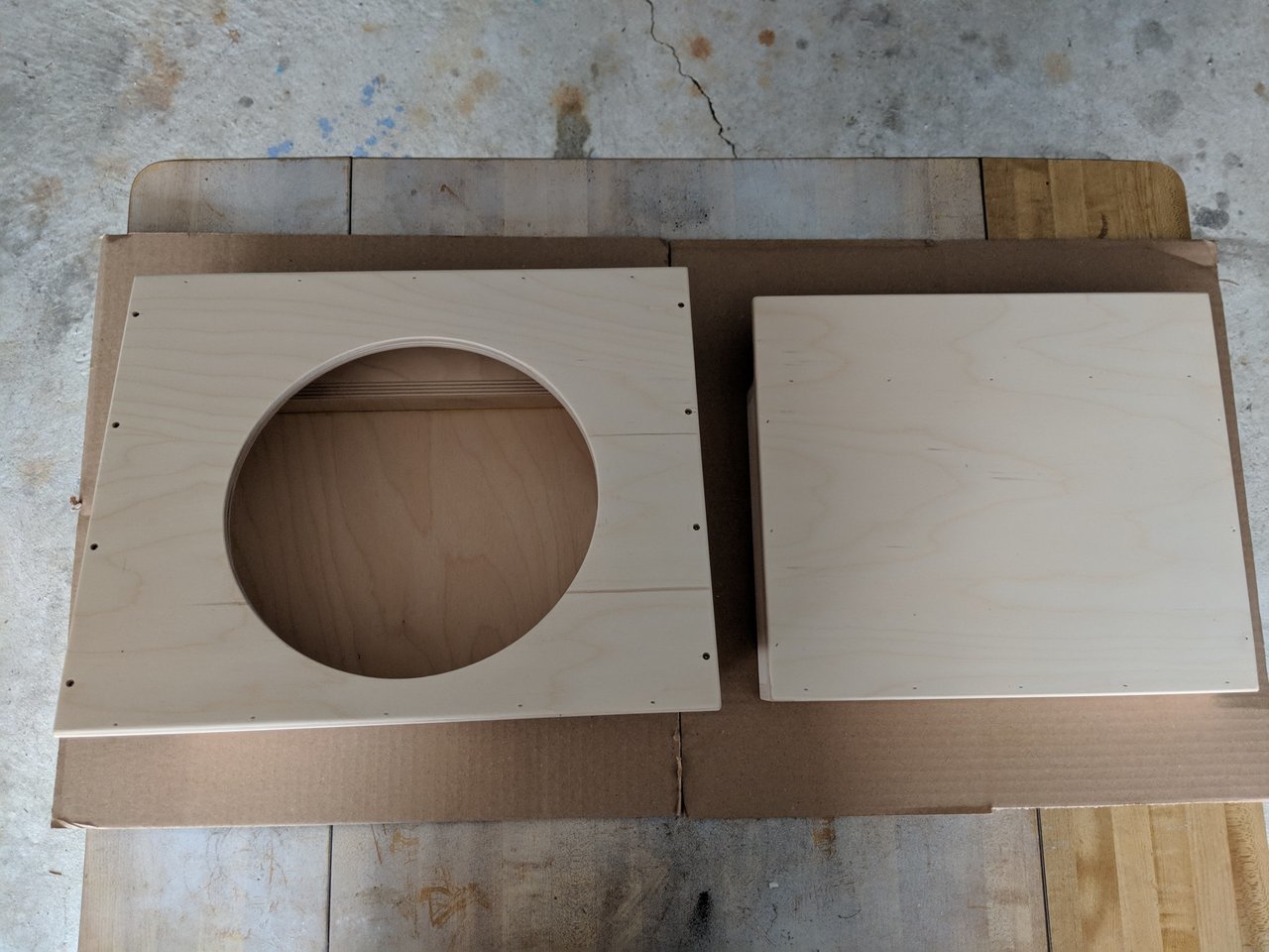

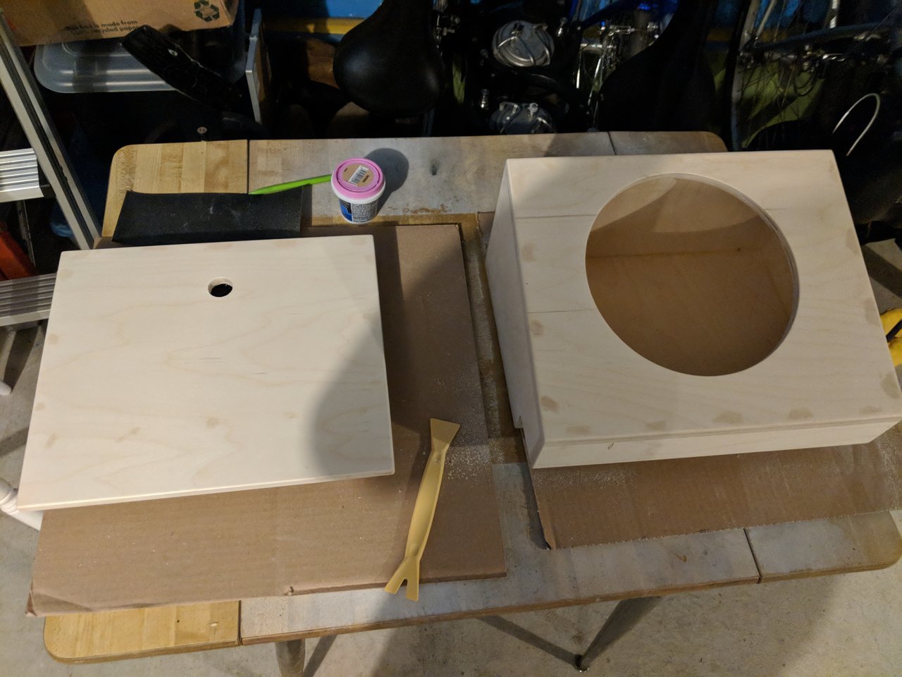

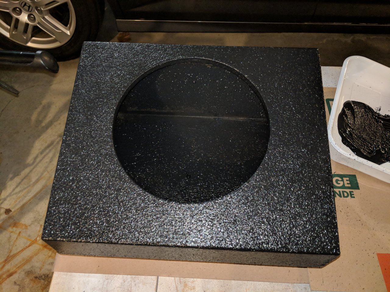

Feb 18: Subwoofer box work
A little filling and sanding
img_20180218_184811_1-jpg.2565360
I bough a quart of Acry-Tech DuraTex to paint these items with that should hopefully come in this week. This project has been slow going with baby steps because I can't seem to find time to blow it all out at once.

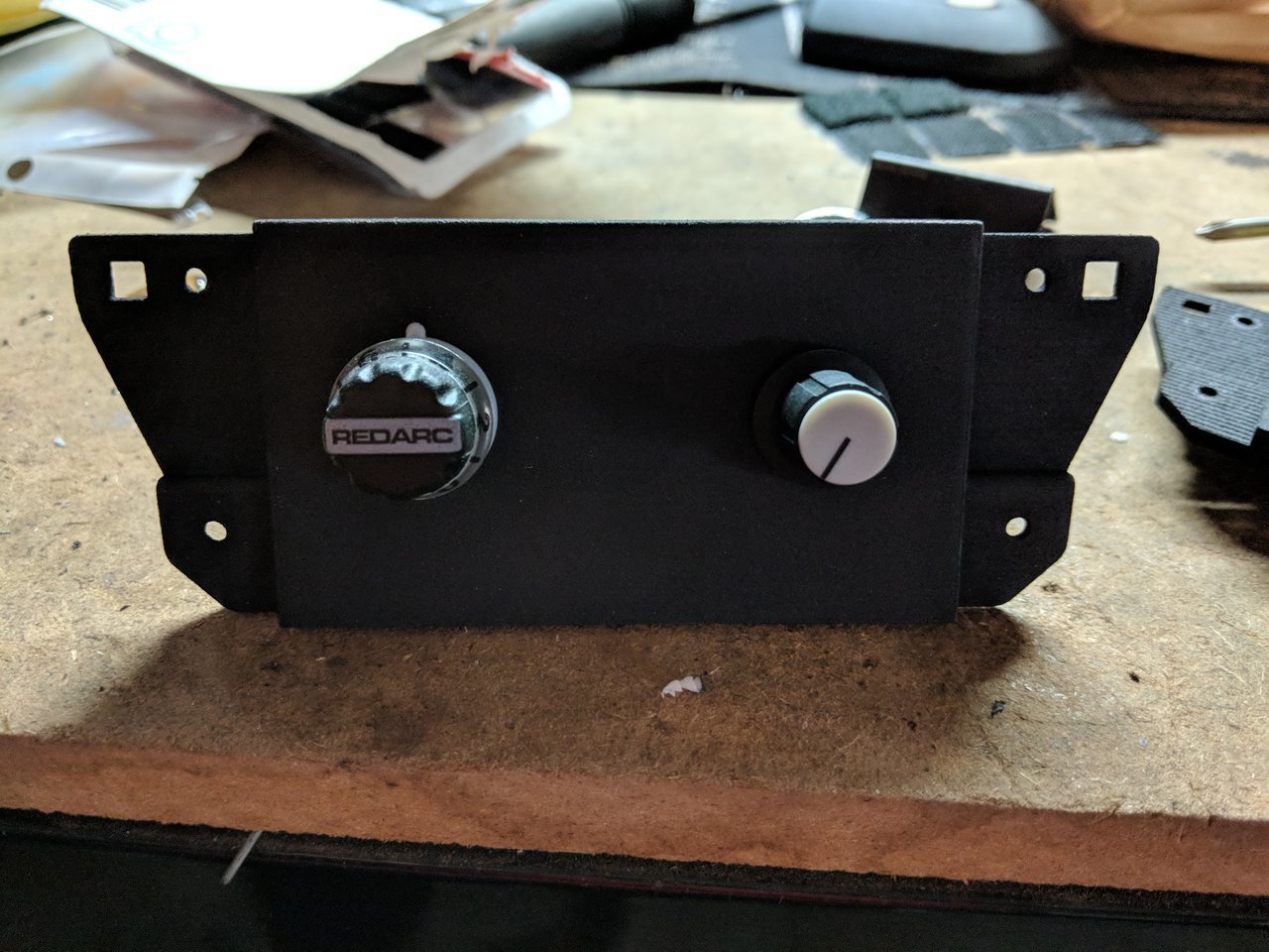

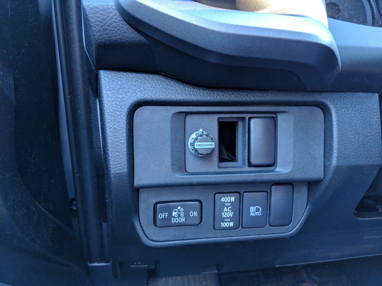

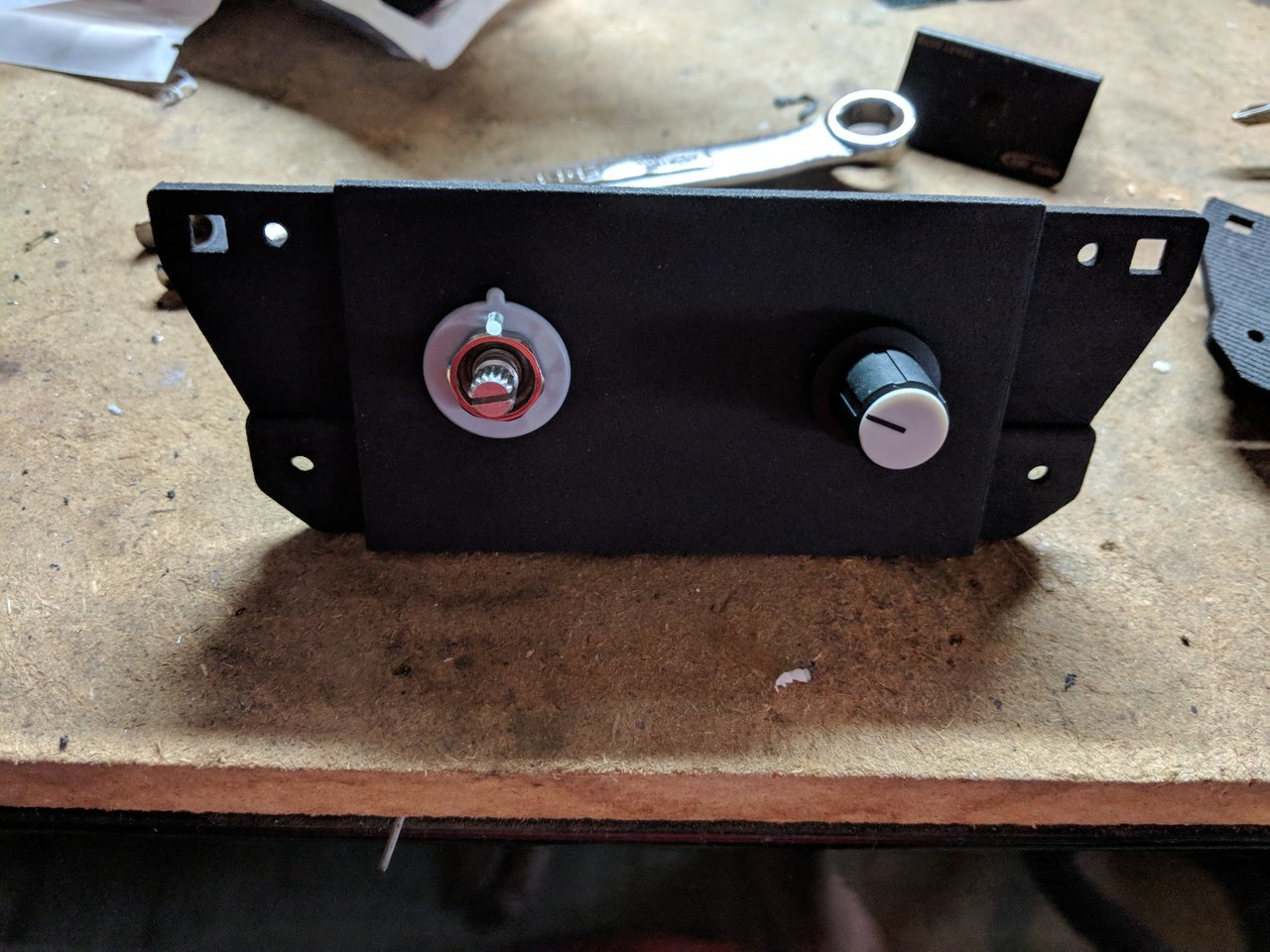

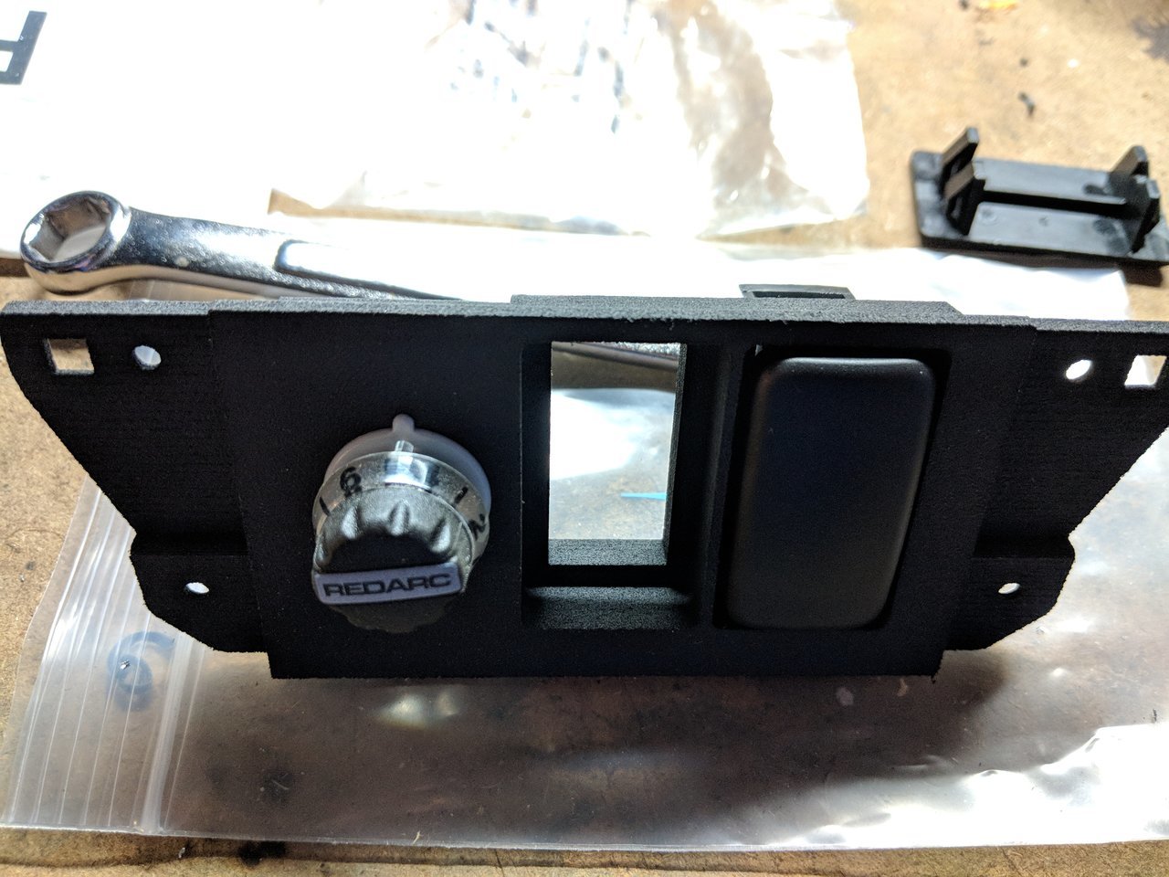

Feb 25: Switch panel #2, garage door opener start and subwoofer box stuff
Went skiing this weekend, do not much done. Waiting on some items to finish a few things, but for now

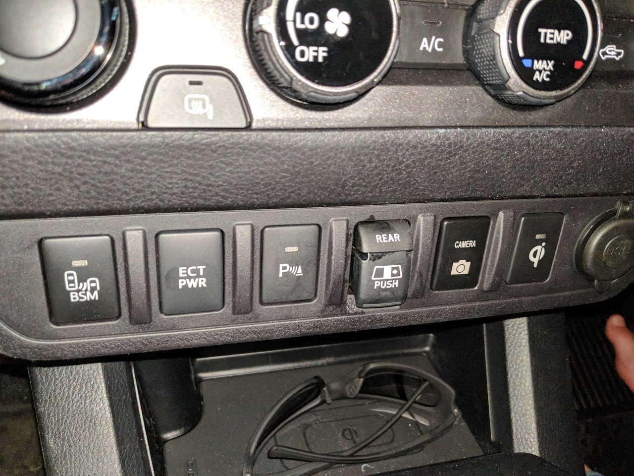

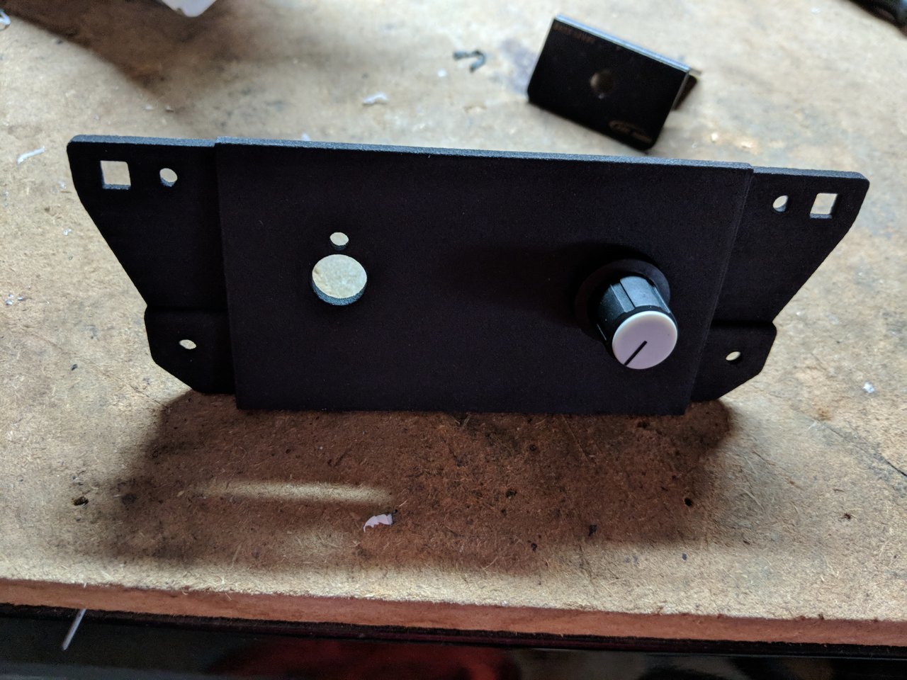

First the Redarc/Sub panel
mvimg_20180225_123532-jpg.2577727
mvimg_20180225_124600-jpg.2577731
mvimg_20180225_124636-jpg.2577733
img_20180225_125002-jpg.2577738

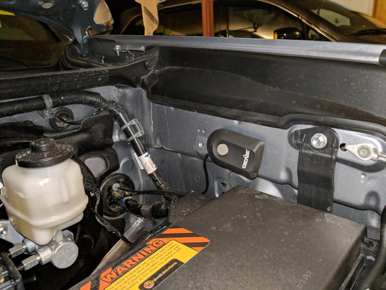

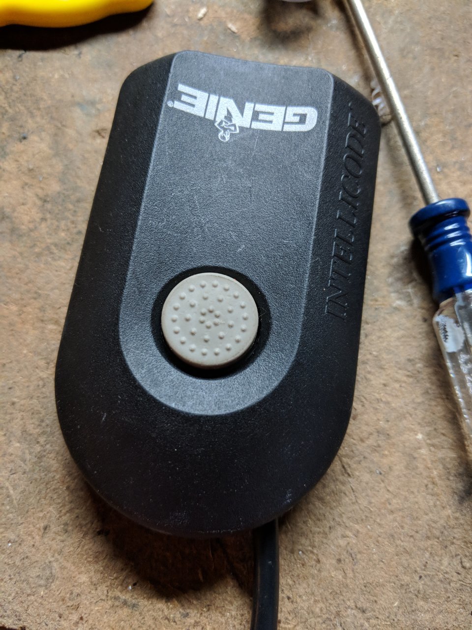

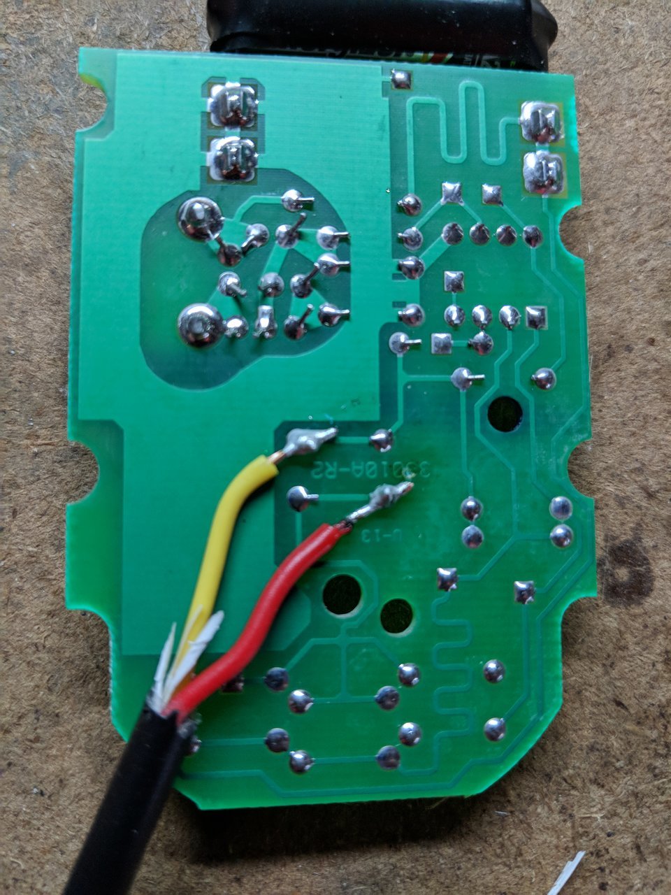

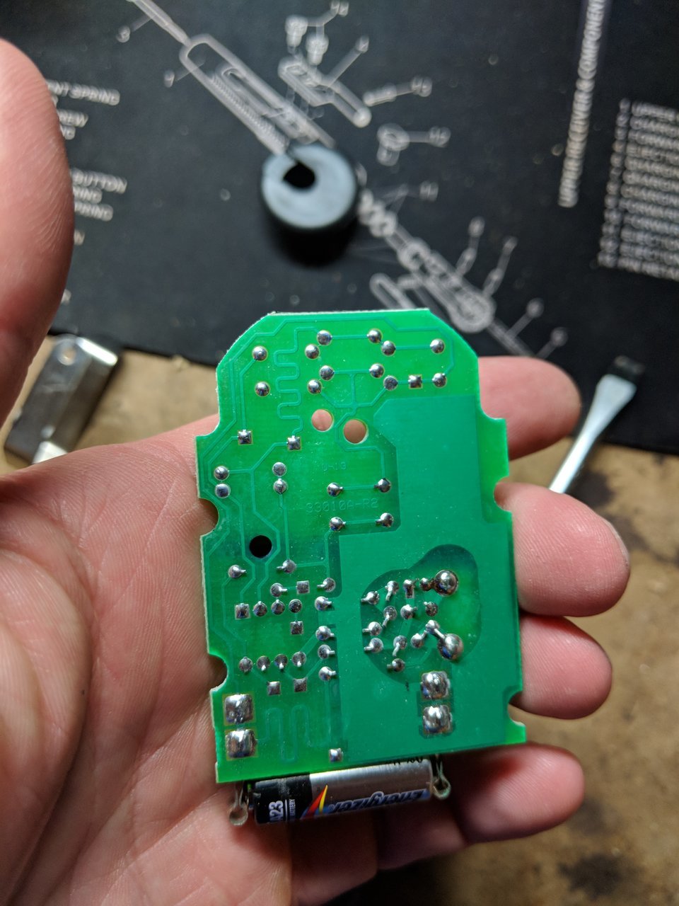

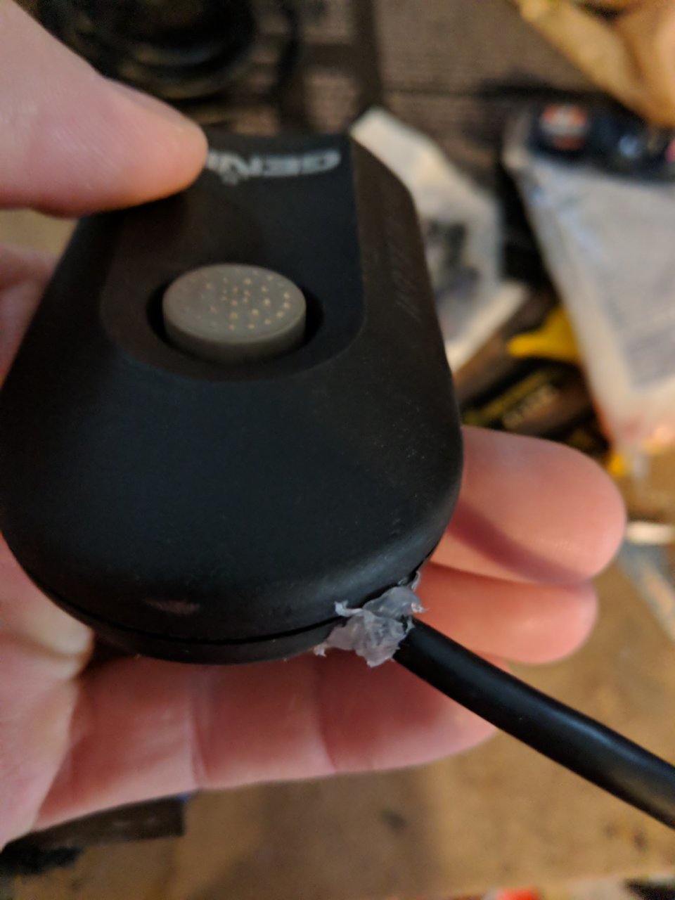

Then I worked on my garage door opener. I had an old door opener I could use for this project.
mvimg_20180221_182735-jpg.2577743
mvimg_20180225_131009-jpg.2577744
mvimg_20180225_135440-jpg.2577745
mvimg_20180225_140124-jpg.2577746
Next up, painting the sub box and amp rack
Staying busy setting up for final install. The DuraFlex paint for sub boxes is awesome, but a quart goes a very long way. I started by brushing a coat, letting that dry/set, then rolling it using the roller supplied. I have enough of that stuff to roll another couple of coats. Will probably roll at least one more on the front sides.
img_20180225_185611-jpg.2577959
img_20180225_185628-jpg.2577961
Still a lot to do, but me and time aren't getting along right now.....
Feb 26: finished garage door opener project and subwoofer box stuff
Finished out my garage door opener project.
img_20180226_182057-jpg.2579662
img_20180226_182301-jpg.2579663
Works just fine. I wish it was a momentary switch, but I like my switch just fine. My kids have called my trucks the yard matey for years, because the plate (YARM8E), so why not...

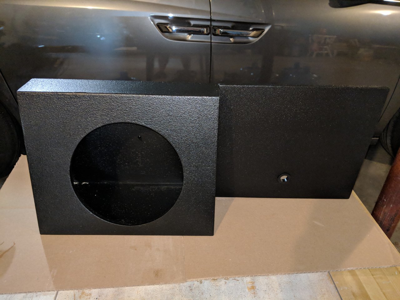

Finished getting the sub box together. The Duratex paint is fantastic.
img_20180226_184152-jpg.2579672
img_20180226_183822-jpg.2579674

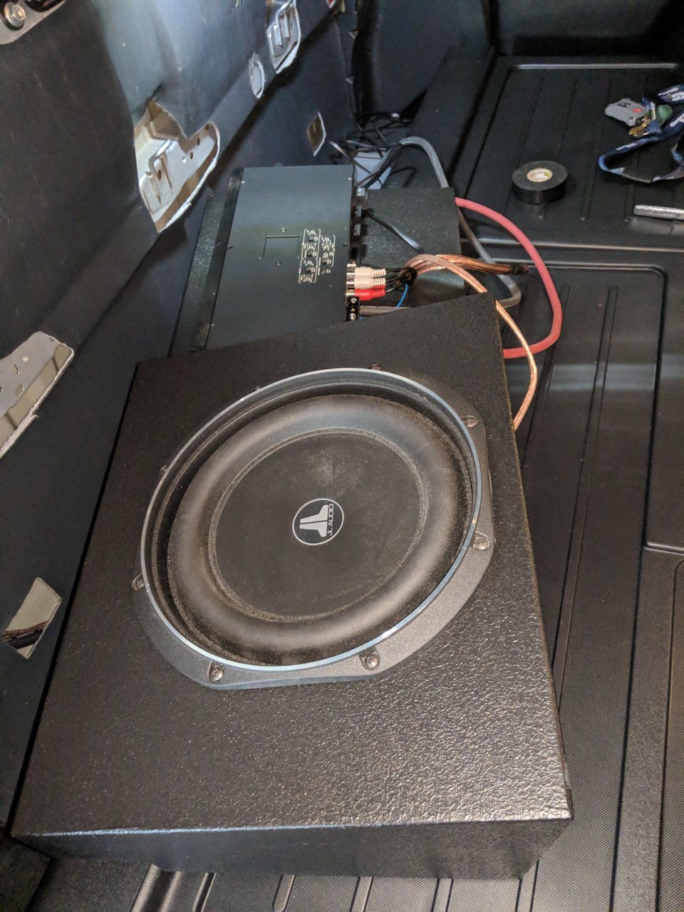

This weekend, hopefully I'll be able to get the amp and sub installed.

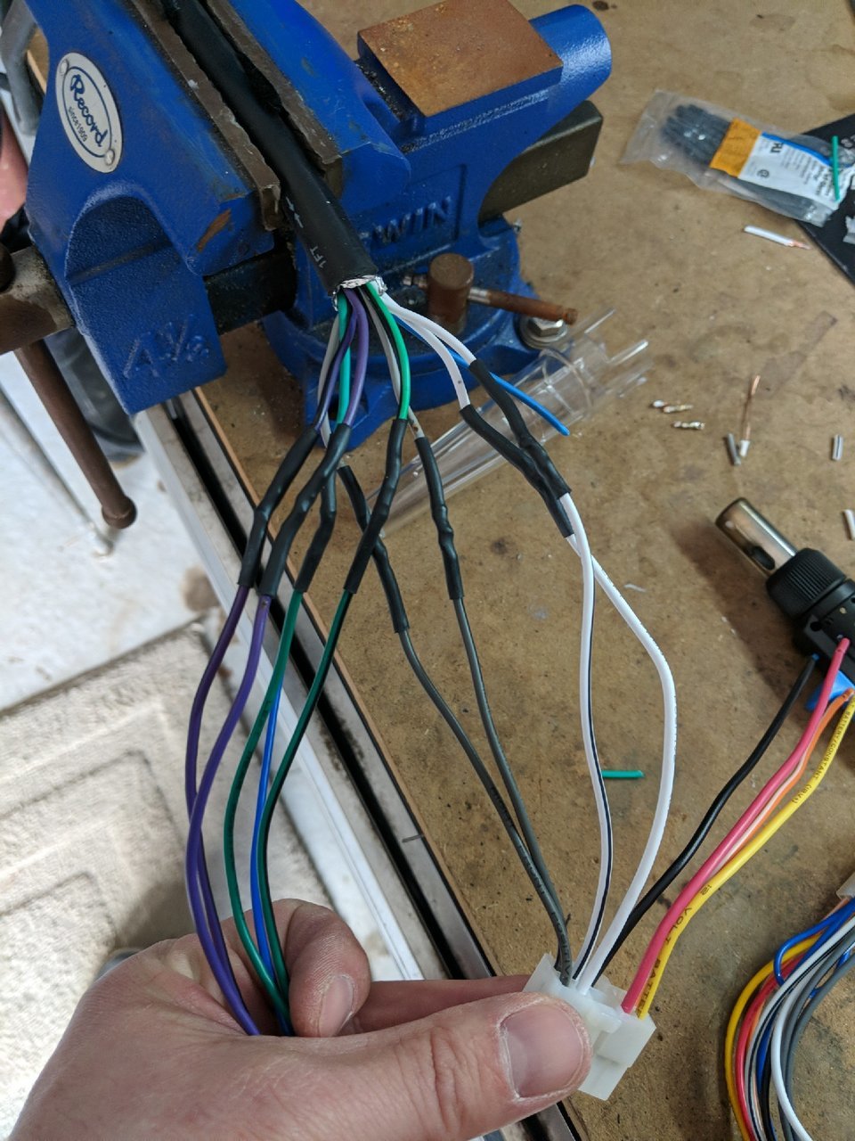

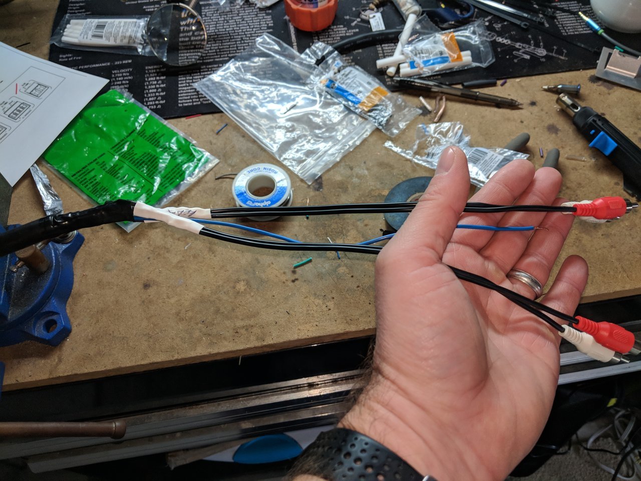

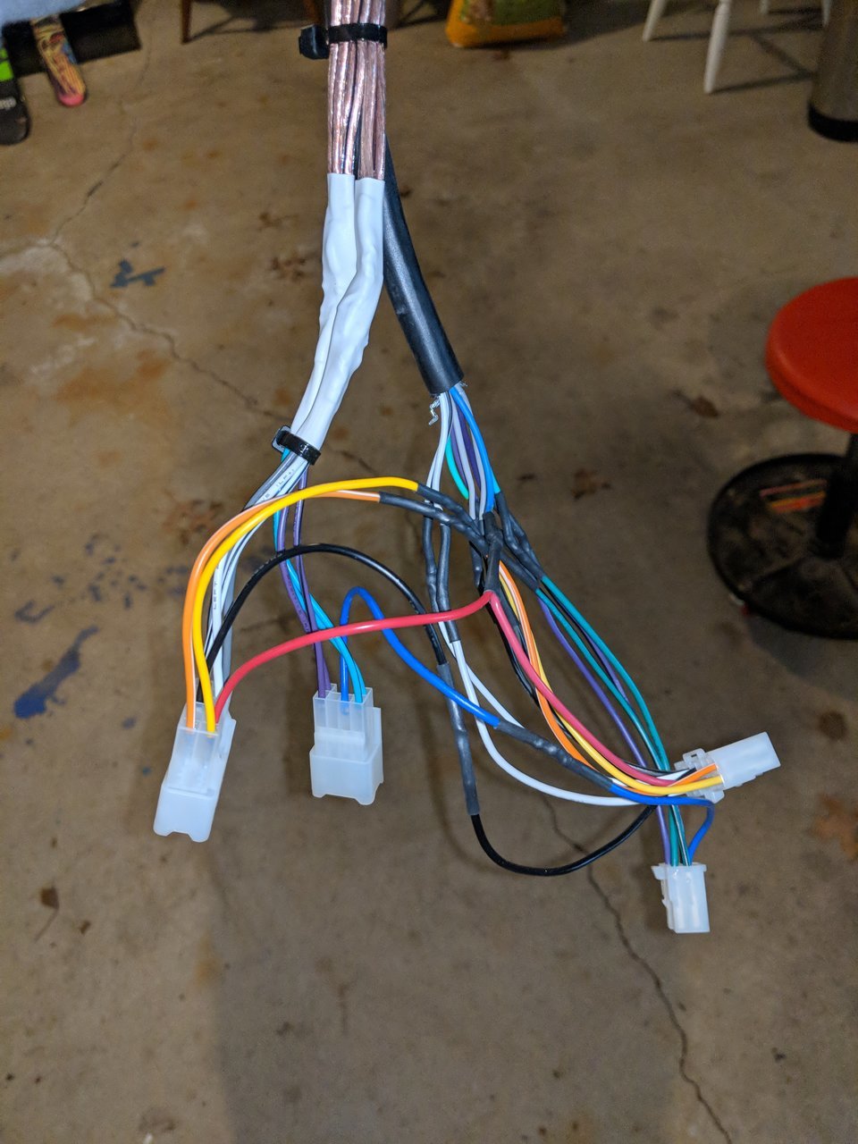

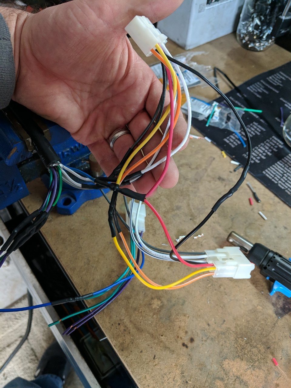

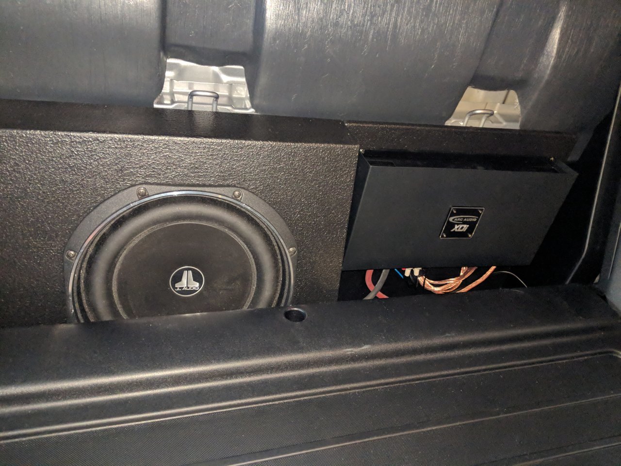

Mar 3: Soldering of wire harnesses for sub, amp. I did this to keep my head unit, drive the sub and still push power to the kickers and PPI speakers.
Getting shit done.
img_20180303_163204_01-jpg.2587686
img_20180303_163212_01-jpg.2587688
Just need to solder RCA connections.
img_20180303_183023-jpg.2587939
March 4: RCA connectors for amp and install.
Today's work!
RCA plugs soldered
img_20180304_090021-jpg.2589449
Fuse is in. This might be a temp spot
img_20180304_123231-jpg.2589450
Tuning done!
img_20180304_141643-jpg.2589451
I used a DSO Nano oscilloscope to set the gains. The OEM head unit doesn't clip even at Max volume, but I set the gains at 52 volume, using 1khz tone at 0dB, and 60hz at 0dB. @Mr Marv was very helpful.
All snug and done:
img_20180304_153917-jpg.2589454

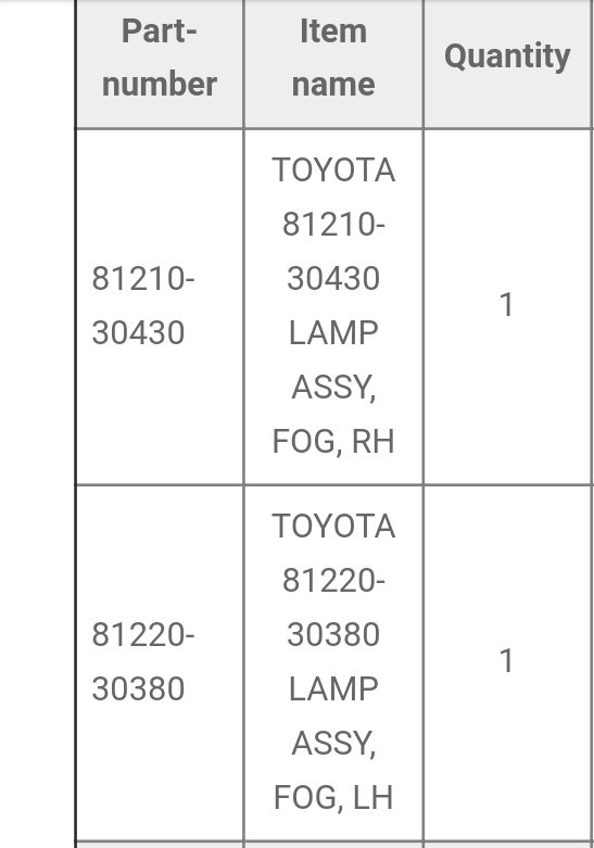

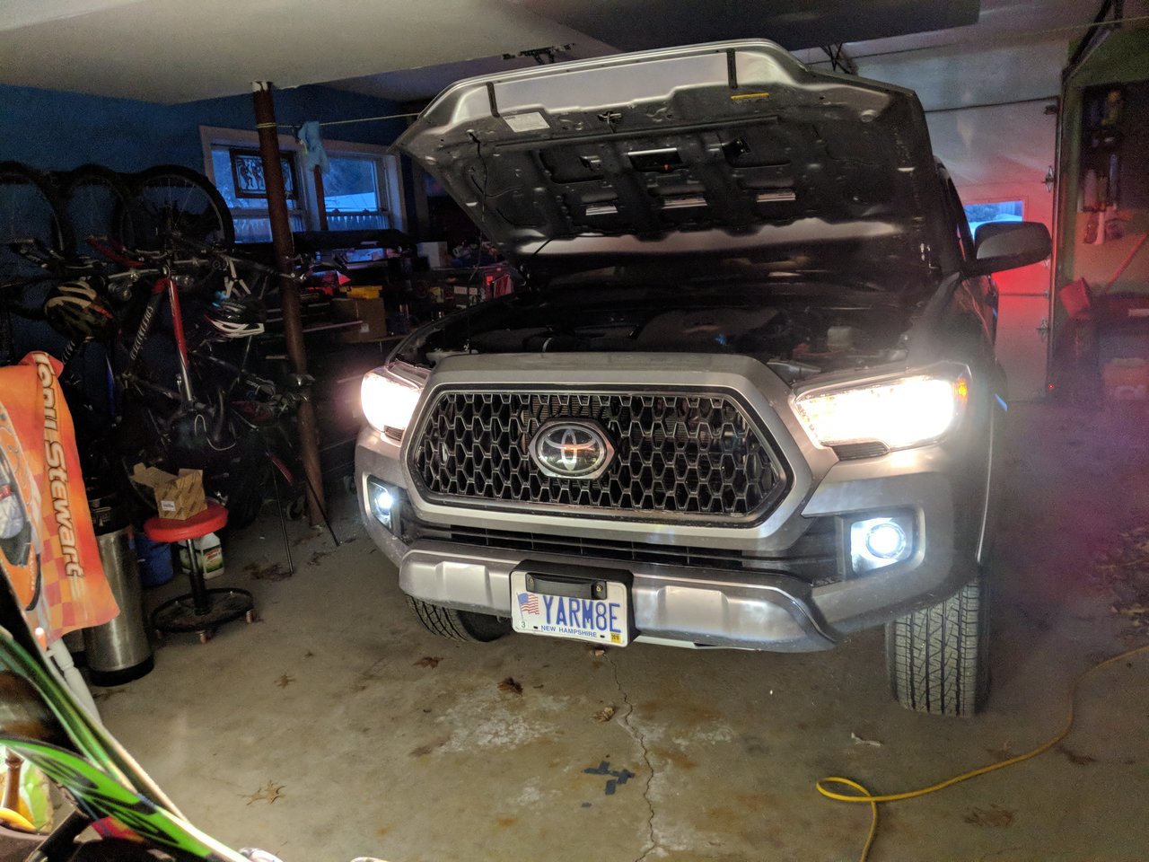

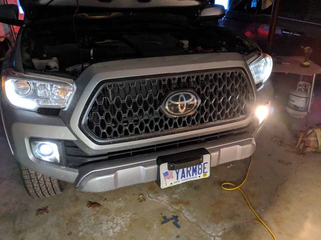

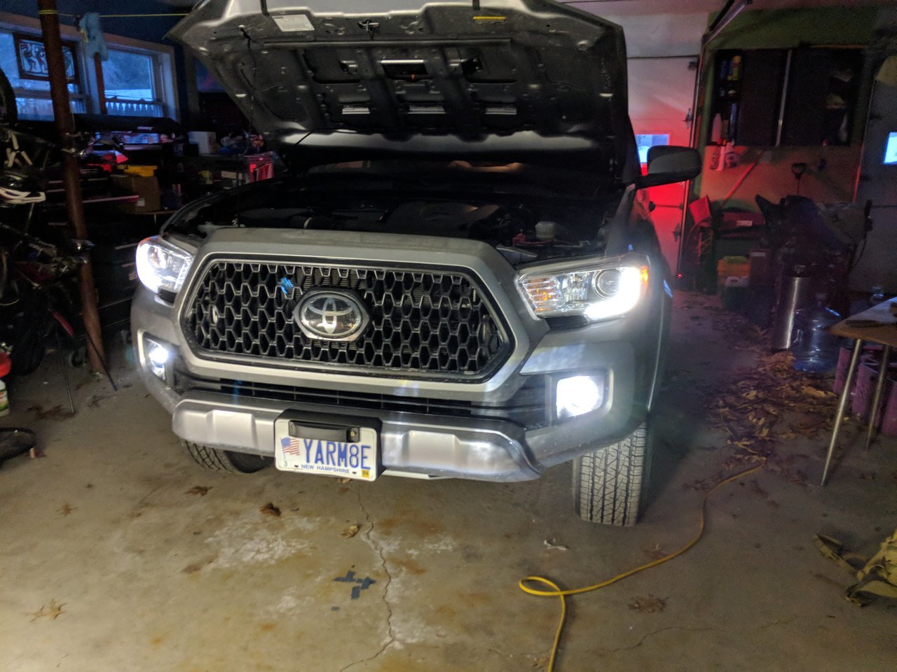

Mar 14: Lexus projector fogs
Put in the lexus projector fog lights tonight, and they look great. I didn't take off the grill. Tried to take off the fog trim and may or may not have broken a clip. I was going to get sr5 trim anyway. Took 5 minutes a side after figuring out I could get them in with minimal issue without removing anything.

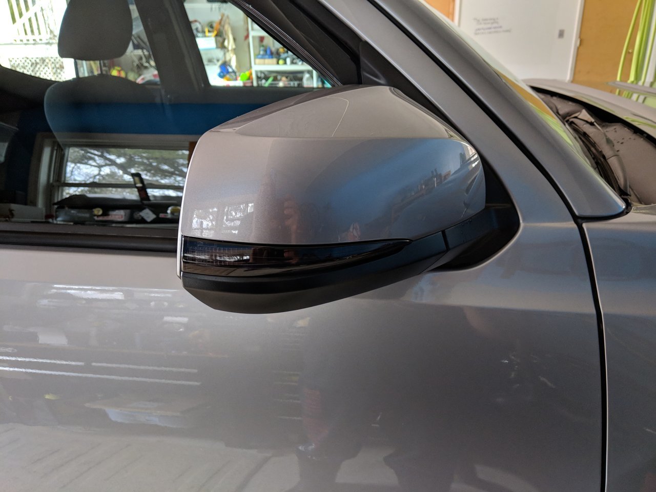

Mar 24: Tailgate inserts, emblem covering and mesojdm blinkers
Good day today! Washed and a quick once over inside, then:
Tailgate inserts, matte black bt TuffSkinz
mvimg_20180324_120438-jpg.2624060
mvimg_20180324_120645-jpg.2624063
Covered the chrome emblems
mvimg_20180324_193114-jpg.2624065
Installed @mesojdm ultimates
mvimg_20180324_123948-jpg.2624066
The blinkers went in quicker than the inserts did, and look fantastic.
