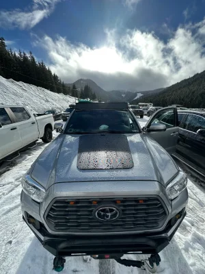

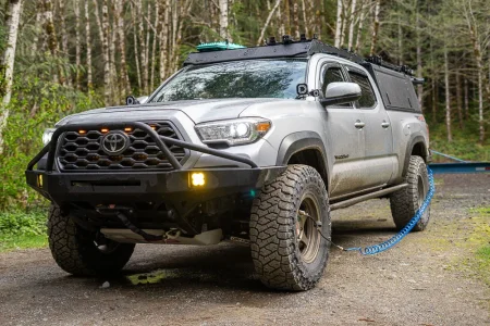

Wow, it’s been a while since I’ve posted. Lots of updates on the build:
Most noticeable:
At The Helm Front Pre-Runner Bumper
Wheels: 17×8.5″ -6mm FNWheels5-star in bronze
Tires: 35x12.5r17 Toyo Tires open country r/t trail
Dirt King LCAs
Alu-Cab Explorer Canopy

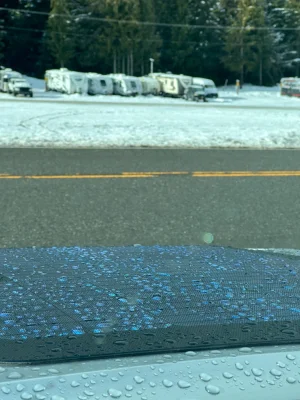

Cascadia4x4 Hood Stamp Solar Panel
