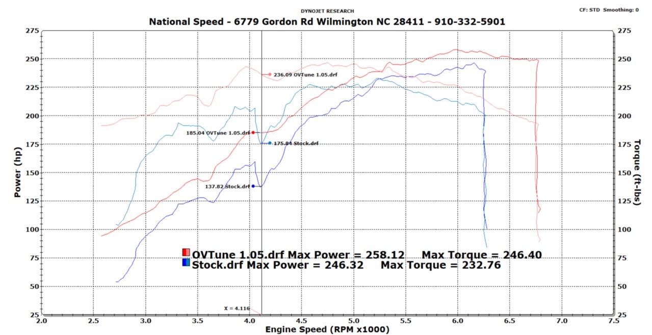

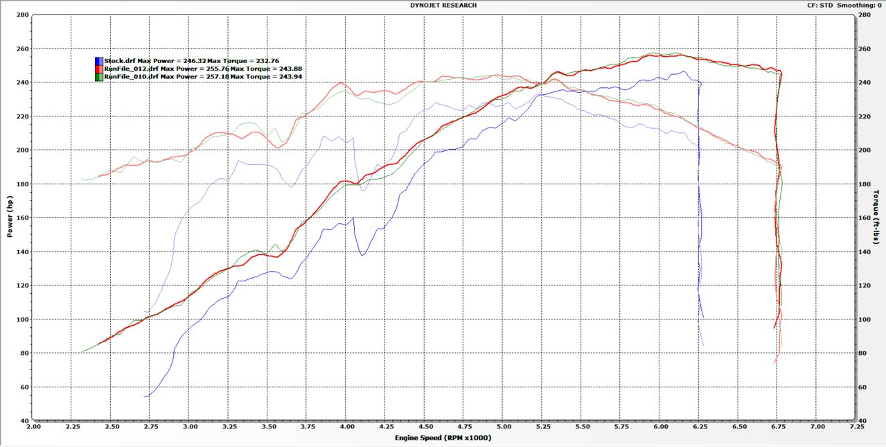

So I haven’t seen anything on this so I am going to ask. The tunes that are being released, are they dyno proven? Would I be better off spending 350 on the OVTUNE editable maps and then take it to a dyno and have it tuned that way? I’ve seen what can happen on a dyno but also know that dynos are the best way to tune something. I am hoping to have this done in a week assuming I get the dongle in the mail. I want to test this on my trip for the 4th.
The following are dynos that OV did on his 1.05 performance tune for 93 octane. I tried his 2.0 tunes for a while but went back to this tune because I found out that he has not produced a performance tune for the 2.0 version yet, at least for us AT owners. You can see a definite performance increase not only in the upper RPM range but also in the mid RPM range. At 4100 RPM it is around a 60 HP gain which can be definitely felt. I also like the fact that he raised the redline to 6800 RPM.
Images / information below is based off of older tuning files (1.05/2.0).
[IMG]
[IMG]
