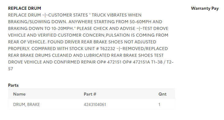

I have a slight vibration in the front end when braking, and I’ve had it since I bought my Pro new 2-years ago. I did a LOT of research on it at first and found some have it and some do not. Some folks go to great lengths attempting to isolate the root cause, and eliminate it. Toyota knows about it, and since it seems to persist year after year, it doesn’t appear they are very concerned with addressing it. From what I’ve read, most don’t ever find anything wrong (e.g. bad tires, warped rotors, suspension issues, etc.). To be honest, I’ve come to realize my Pro is a four wheel drive tank, and I’ve just gotten used to it. :cool:
This fixed it for me. You could feel the vibrating in the seat and all. Sounds sort of similar to what you guys are experiencing.
