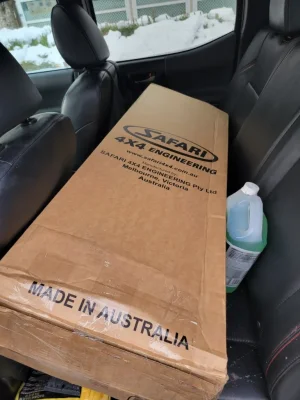

So this was very easy as I thought it would be
The snorkel covers all the holes perfectly
So if you wanna change out the useless trdpro "desert air intake" do it!! cause its 0% watertight

DUDE!! I can't believe I never checked back on this!
So question on your swap. I see that the whole didn't quite line up and when you cut the new one there was some extra space in the top left. how did that work out when you put it all back together?
