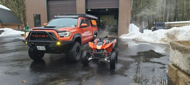

Got my solar setup ready, just gotta find time to put it together and mount it on the truck. Running into some problems tryna squeeze it between the gun cases on the prinsu.

Got a Decked for a great deal! Also had to get a new exhaust since mime rusted out. Swapped out my Mbrp for an axle dump Mbrp. Went a little bit extra and hit the while thing with like 3 coats of high temp paint and then manifold wrapped it.
