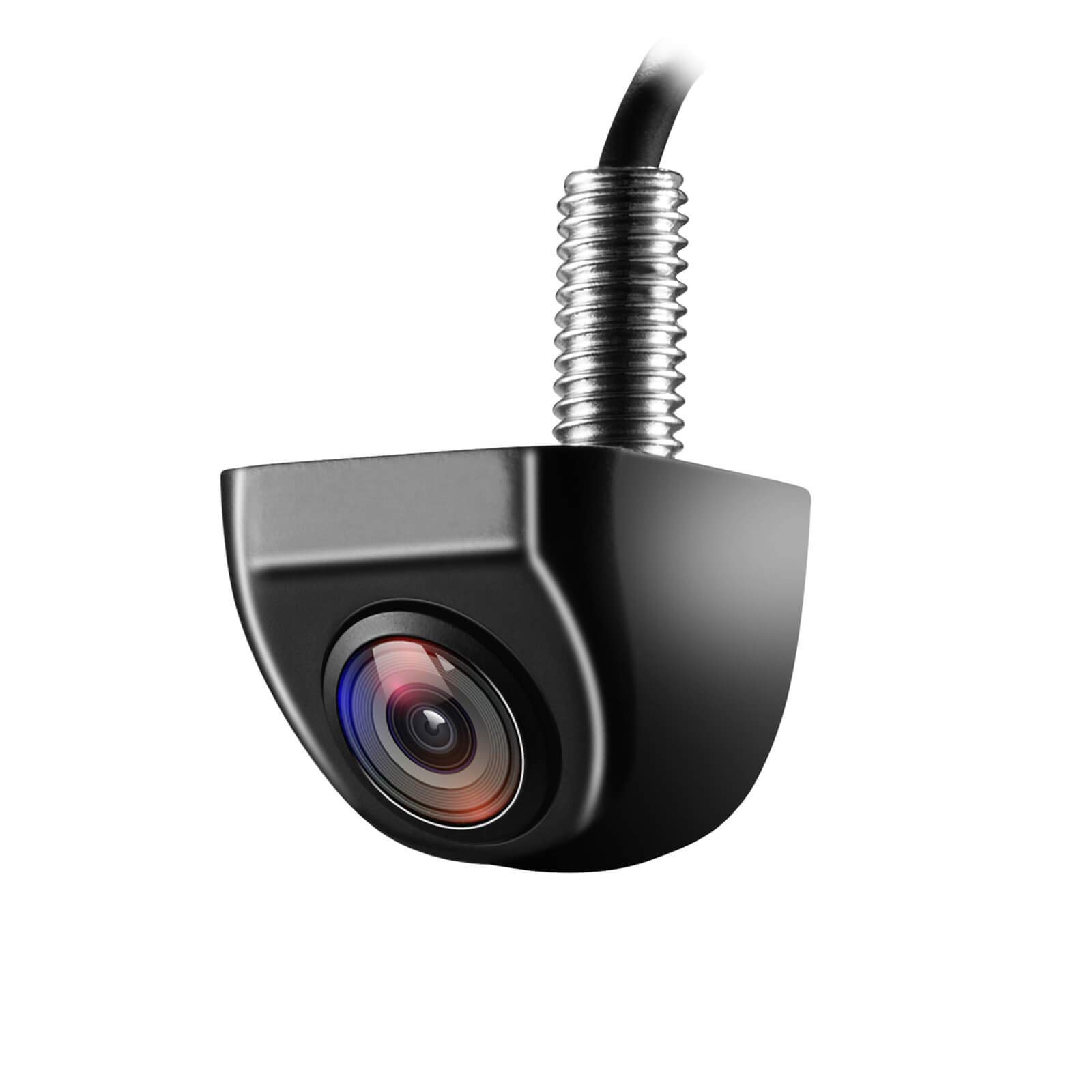

The RAAYOO fit okay but an OEM camera would have fit a lot better. I had to make a mount for this. Per Brian from Anytime there is no way to adapt one of these kits to use the factory camera though due to it having like 6 wires or something like that. I have my wiring all covered with loom and ran along the back side of the grille so you can't see it with the hood open and it comes out under the headlight where it plugs into to the ABC kit.

Might be a little hard to see, but since you said it's higher than you like and not angled enough. I want to share what I did and see if I can influence you into changing over. :) Then I can become a REAL "influencer".
I used the trusty old Natika. Mounted in this position it's angle down. I drilled a hole in the flat part of the grill in front of and against the TSS garnish. Looks better and cleaner than factory in my opinion. It also comes with angle grommits to change the view angle. You could probably also stack them if you want to angle it down lower or just make your own wedge. Now that I'm thinking about it, I should do that. There's plenty of threading. I went for the clean look for mine.

You said it was too high, where is it mounted? Is it above the lettering? I'm assuming the OEM one is also in the same spot?
