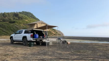

Usal Beach, CA

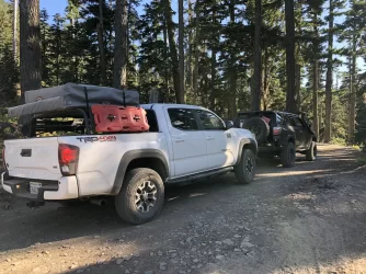

Mt. Hood Forest, OR

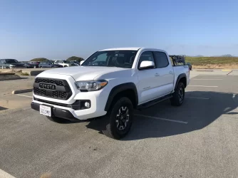

San Francisco, CA

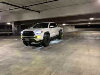

Got the chance to install my @Baja Designs amber fogs. Unfortunately during installation found one of the lights was defective. Shout out to Paul at from Baja for taking care of the unit. I’m receiving mine by next day air tomorrow. Really great customer service! A+
It was weird that only half the light was working. But love how they function. Super bright! They still output a lot of light even with half malfunctioning see below..
On the next day I shipped the unit back to Baja but had to wait until after the New Year.
Below is a comparison of the stock and Bajas. Passenger side is the Squadrons and OEM with amber LED bulbs on driver side.
