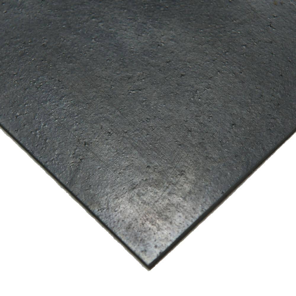

Some people just cut the whole thing out and line the styrofoam then make their own liners.
1/16" rubber or abs. This should be good.
Recut the whole thing out to cover everything, tuck it in, drill some holes and grab new retainer clips. Just don't drill too far in. Use tape or a drill collar.
