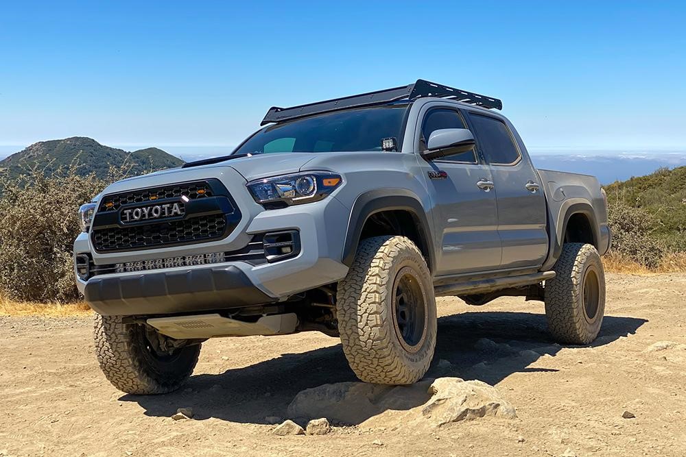

Wondering if any of yall have any experience with the Wescott Designs lift kit for the stock trd pro suspension?
This is for Factory Fox TRD PRO, available for a 4Runner, Tacoma, or Tundra. This is not a spacer lift. This kit does not change the geometry of the factory suspension. This kit will not limit your factory travel or extend the travel pass factory.
This kit provides the following lifts:
  • 4Runner: 1.5” (front lift) and 1.25” (rear lift)
  • Tacoma: 1.5” (front lift) and 1” (rear lift)
  • Tundra: 1.5” (front lift) and 1” (rear lift)
https://westcottdesigns.net/product/fox-trd-pro-lift-kit/
