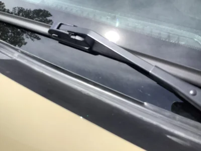

Has anyone else seen this problem?
The lower windshield weatherstripping is not staying on the windshield. The plastic piece is really easy to move and push down.
I am thinking of using some tape or weatherstripping of some type.

Yes. I was cleaning my windshield once and put my hand on that plastic piece. Part of the weather stripping ended up under the windshield. I was able to finesse the weather stripping back in to place using a plastic putty knife while gently pressing down on the plastic. Its not 100% back to normal.

I’d run a small bead of silicon on it to hold it down and seal it a touch. Then next time you go to replace the windshield, have that replaced too

I could pull the wiper arms and reset this piece

Also this area collects lots of rubbish too....I live on a coffee farm ..park under a few trees ..the dead leaves piles up ..and does not flies out too.. bad design ..?
