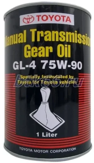

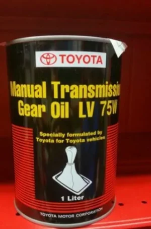

We all know the MT6 (manual transmission) needs GL 4 because of the syncro/blocks made of brass rings and other grades besides GL4 will cause problems.

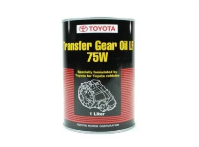

The transfer case ALSO has syncro/block rings made of brass rings as well. So, the expensive "Liquid Gold" LF 75W sold by Toyota is GL 4. at $80 - $125 per liter has a reason.
Toyota does not tell you it is GL 4 unless you do some homework.
The transfer case also has an internal oil pump so 75W is a reason of use, don't go with thick oil here........
I have bought all the OEM stuff in the past and paid for it,......... but also have found Redline makes the transfer fluid as well for $23 a liter.
