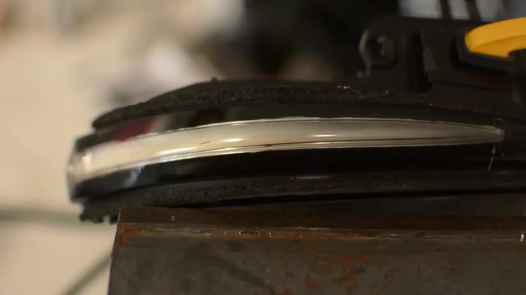

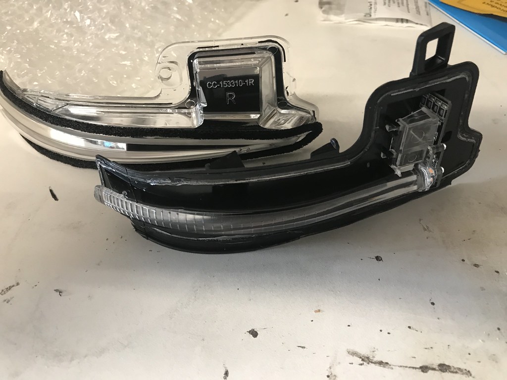

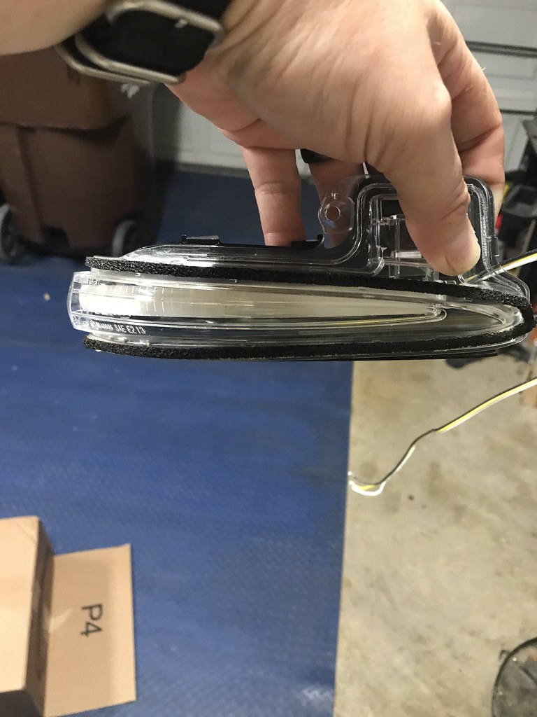

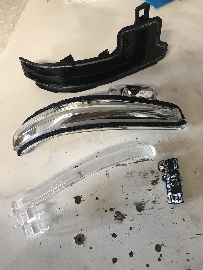

Recently ordered some turn signals from eBay to see how they opened up. Pretty easy actually, just used a razor knife to cut through the epoxy all the way around the perimeter.
I initially used a 4" generic strip that I found on eBay and was very disappointed in the brightness after adding 2 coats of Nite-Shades

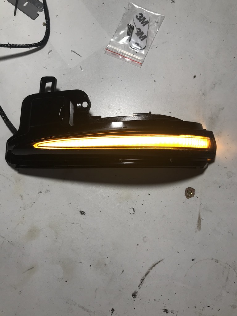

You can see how dim the signal came out -
So after I installed them I decided to split the OEM signals. Stripped the chrome with Easy Off...

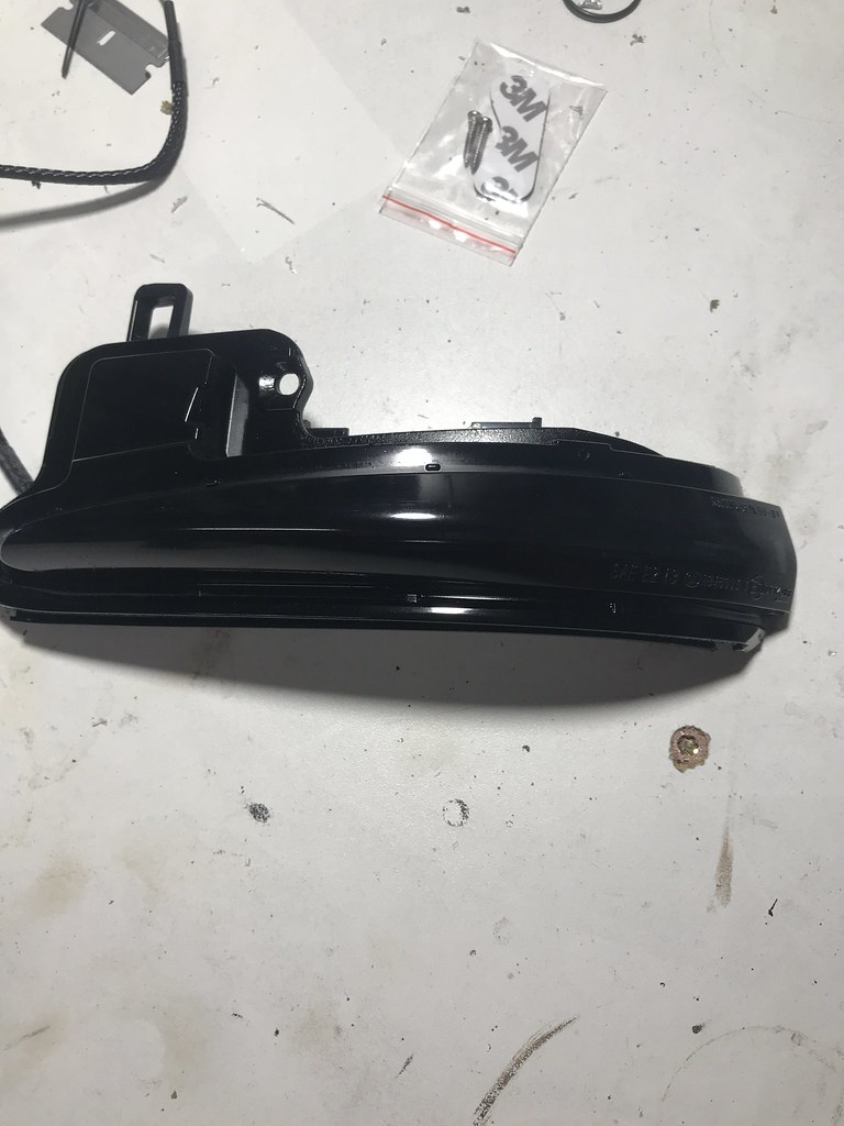

Decided the strip showed through too much so I repainted the chrome area black (from the inside)

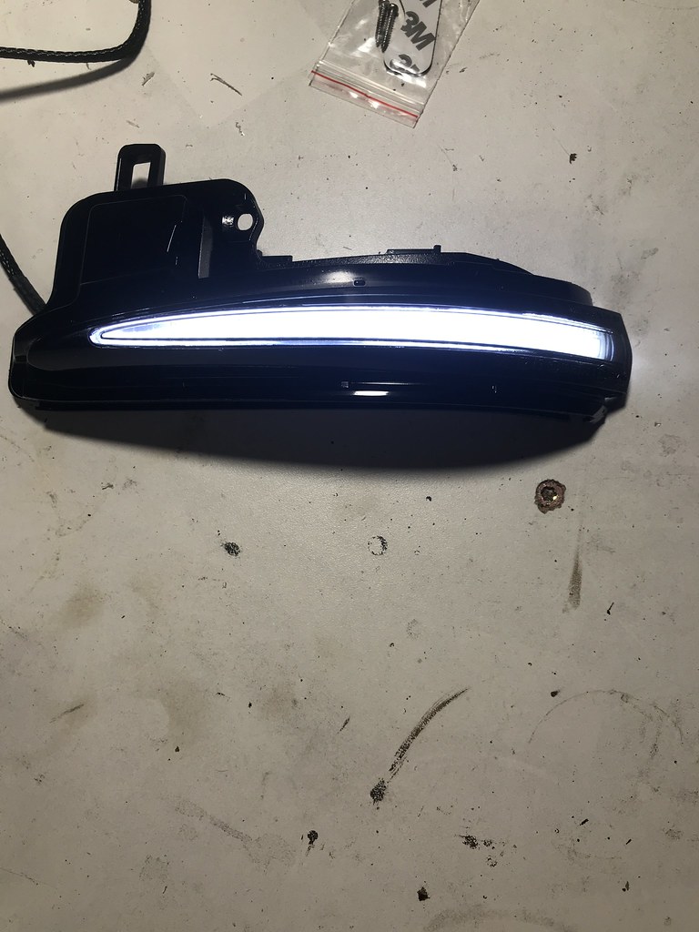

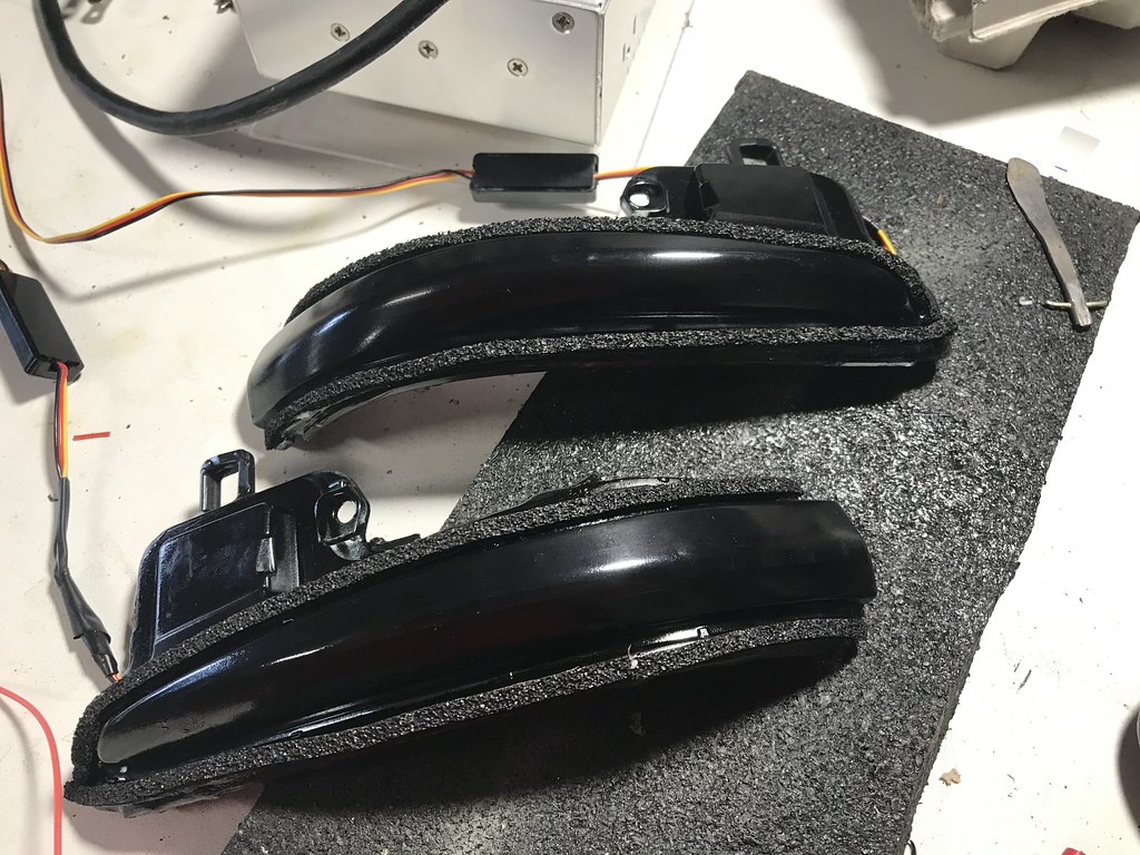

Once I powered the light up I realized these strips were way brighter. Since I didn't like the white showing through, I went ahead and put a single coat of Nite-Shades on.
Sorry no pictures of the wiring, I cut the OEM connector from the signal and used that for ground and turn signal, picked up a pink wire in the window switch harness for DRL signal, and the teal illumination wire in the switch for low power DRL.
