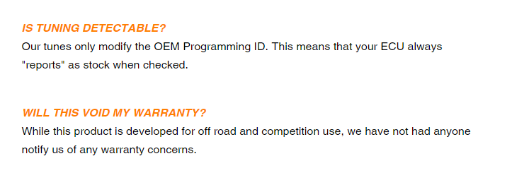

So I’m due for my first oil change. If I take it to Toyota for my free oil change will they know I’ve had my taco tuned?
If theyre jus doin an oul change I wouldnt think so. They usually do a test drive after and they might notice then.
Realistically, a lube tech/maintenance tech won't take the time of day to check or care. The only time the tune would be an issue is if you took it in for warranty work. At that point they'd be checking every box to find some way to weasel out of doing the job under warranty because warranty pay sucks by comparison to regular pay. These guys are paid flag rate so the faster they can get a car in and out the happier they are.
I feel that even at the diagnostic level at the dealership most aren't able to detect a tune unless they have first hand experience of driving a Tacoma daily with one. Even then I don't think they can prove anything. From VFTuner's site:
