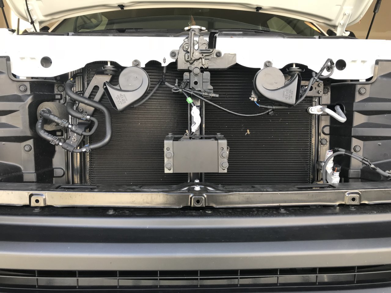

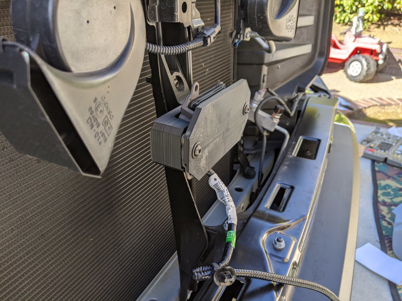

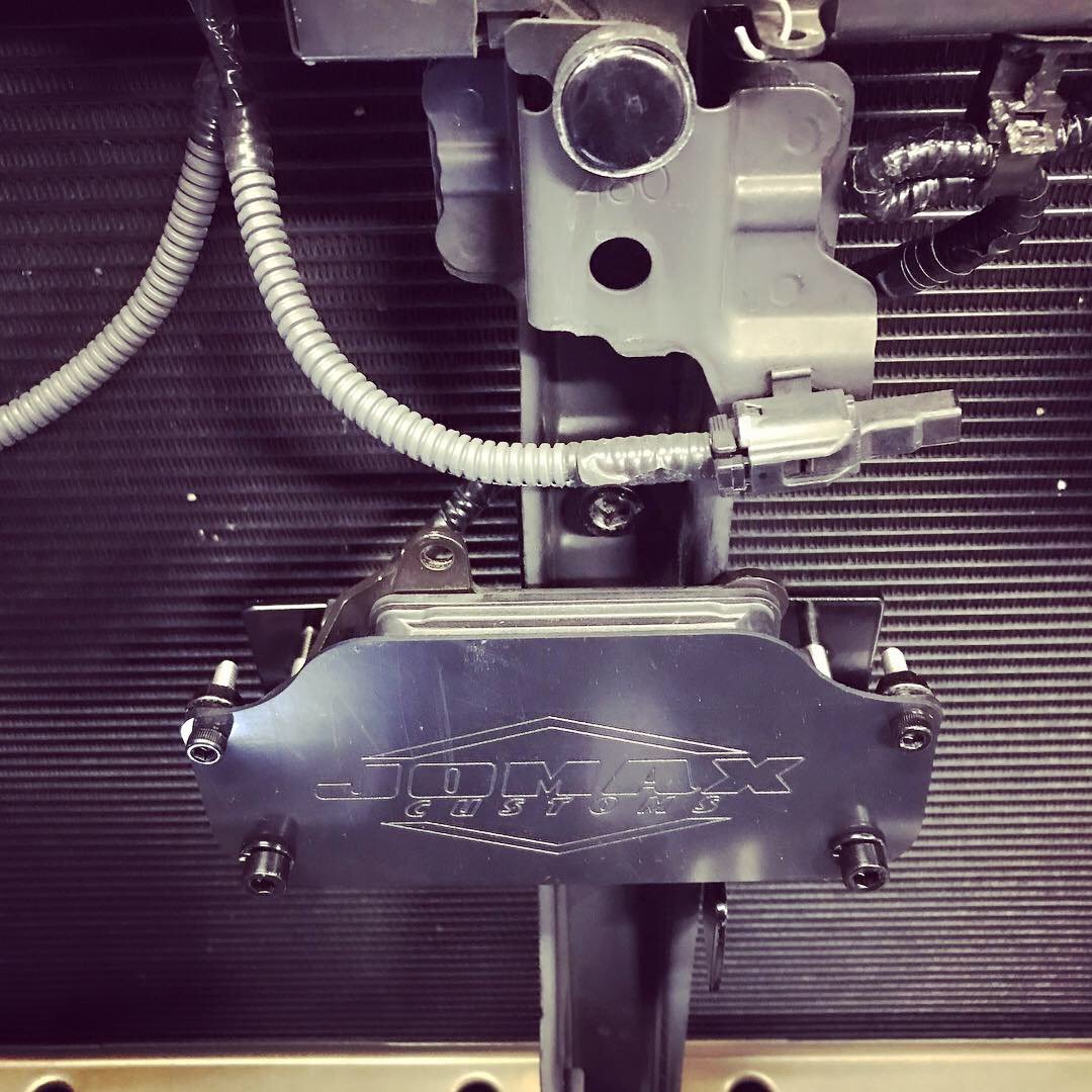

Is it true that if you lift your truck the TSS sensor no longer works properly? Does that relocator bracket fix this issue? Also, wouldn't it think the grille is a vehicle in front of you if mounted behind?
Sometimes it effects the sensor, sometimes it doesn't. Seems to depends on lift height and rake. The sensor itself I'm guessing senses metal mass, so it bypasses the plastics. The sensor is held onto plastic studs/nubs by locking washers. I've heard of some people using spacers to adjust the angle. But it would only be angled upward. Sometimes it doesn't effect some trucks at all.
