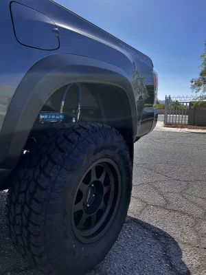

Wanted to swing by and get some conversation going!
What’s your suspension setup, or even dream suspension set up, and why?
Here’s some pics of a super simple and clean set up for a client, we knocked out a while back!
We’ve got a wide array of suspension options for every need by the way! If you’re in the market, let’s go over suspension systems!
Rogue-Offroad
