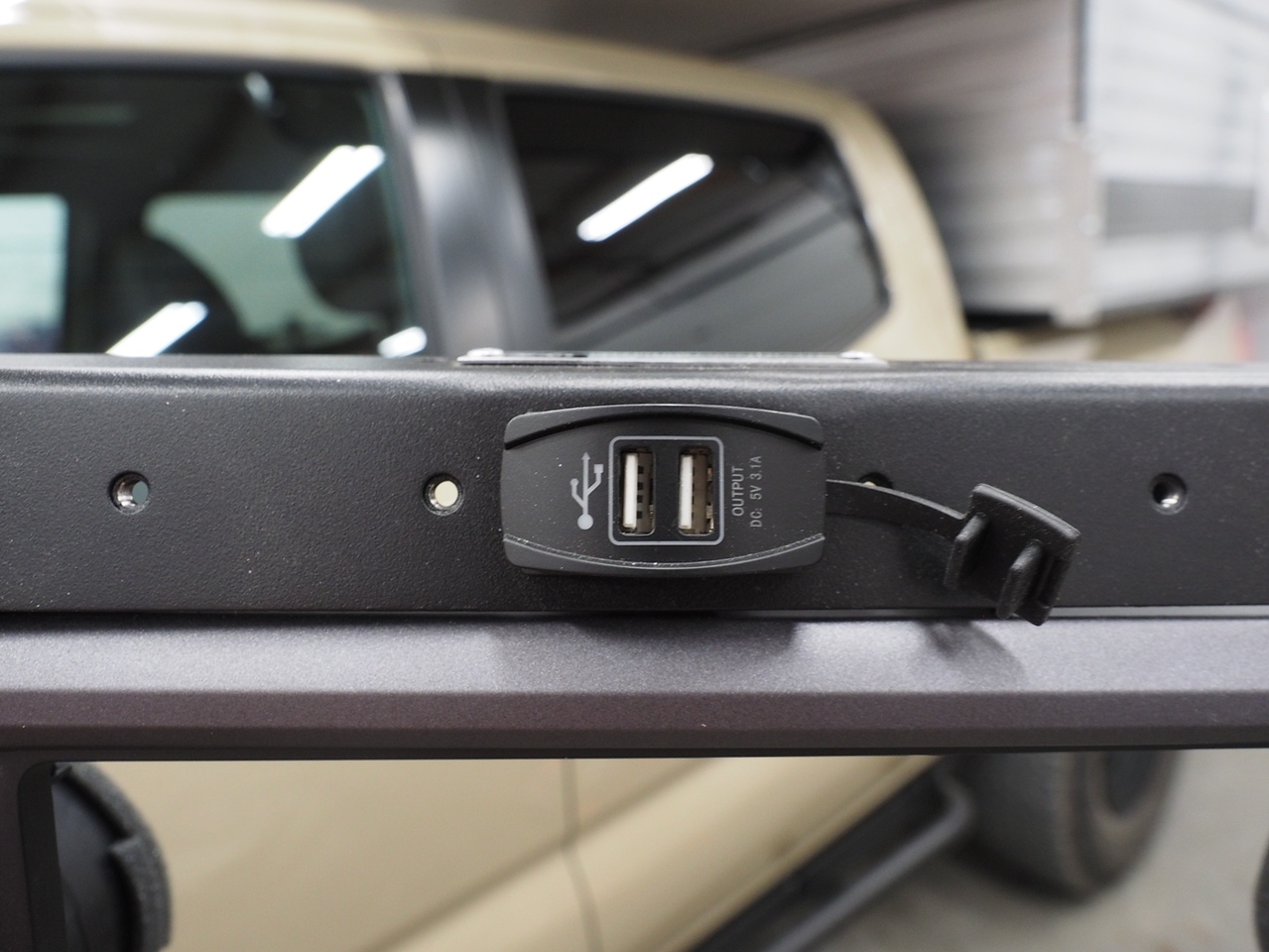

First removed the TPAM from the truck. Here you can see the low power charger I'll be replacing. It's quickly removed from the mount.

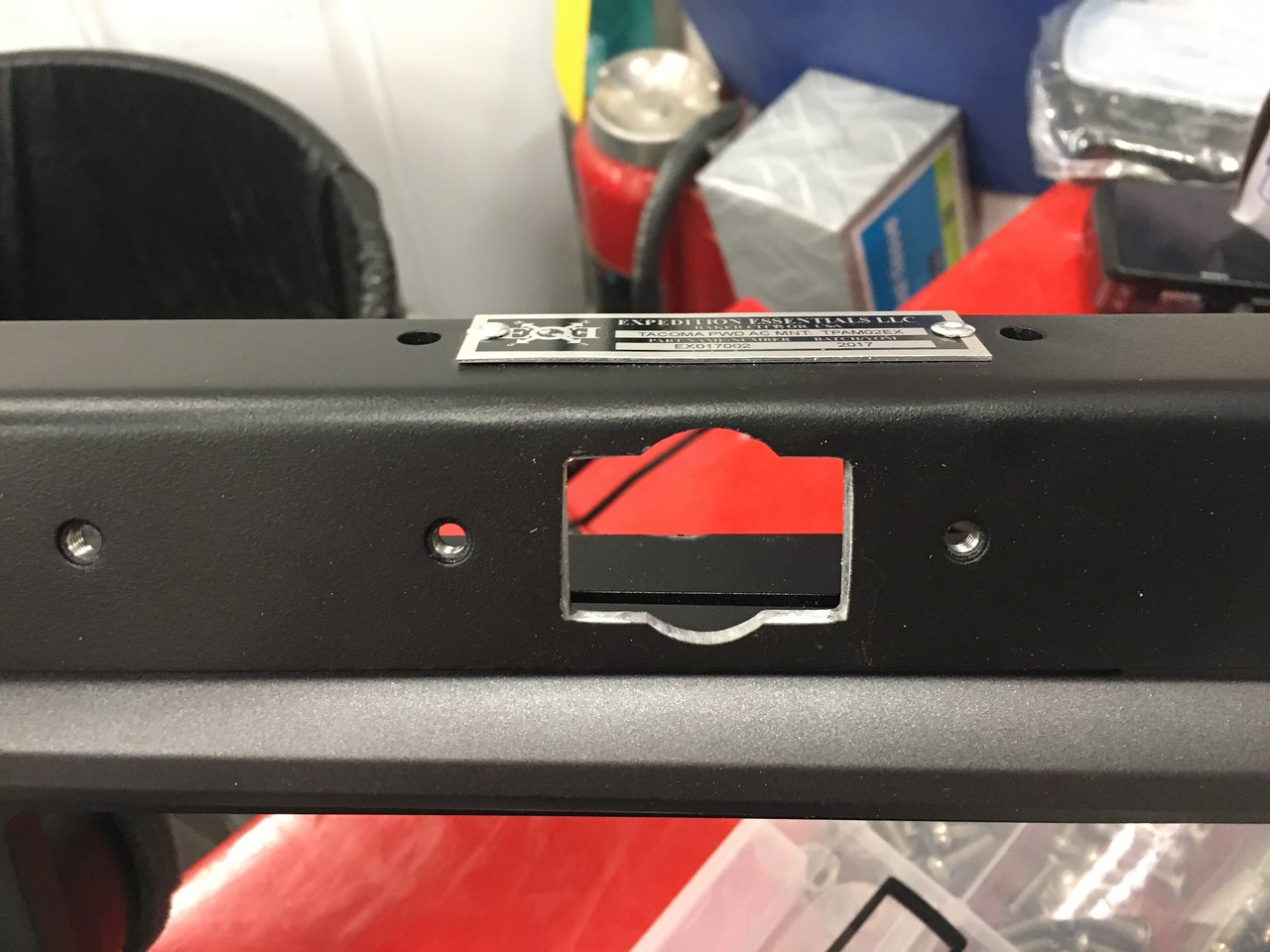

The notches I cut in for the round charger.

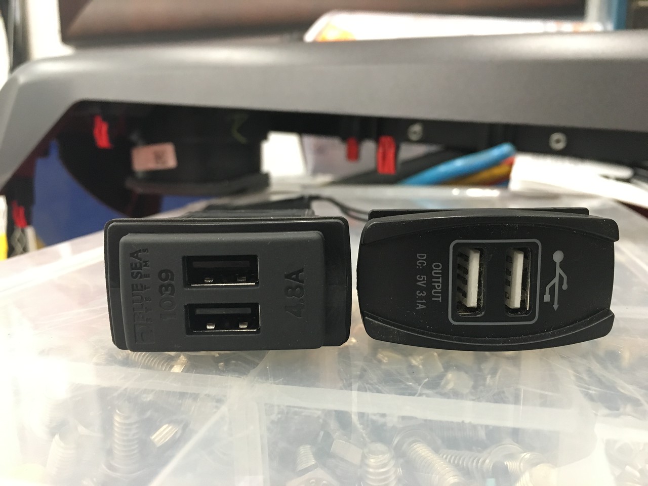

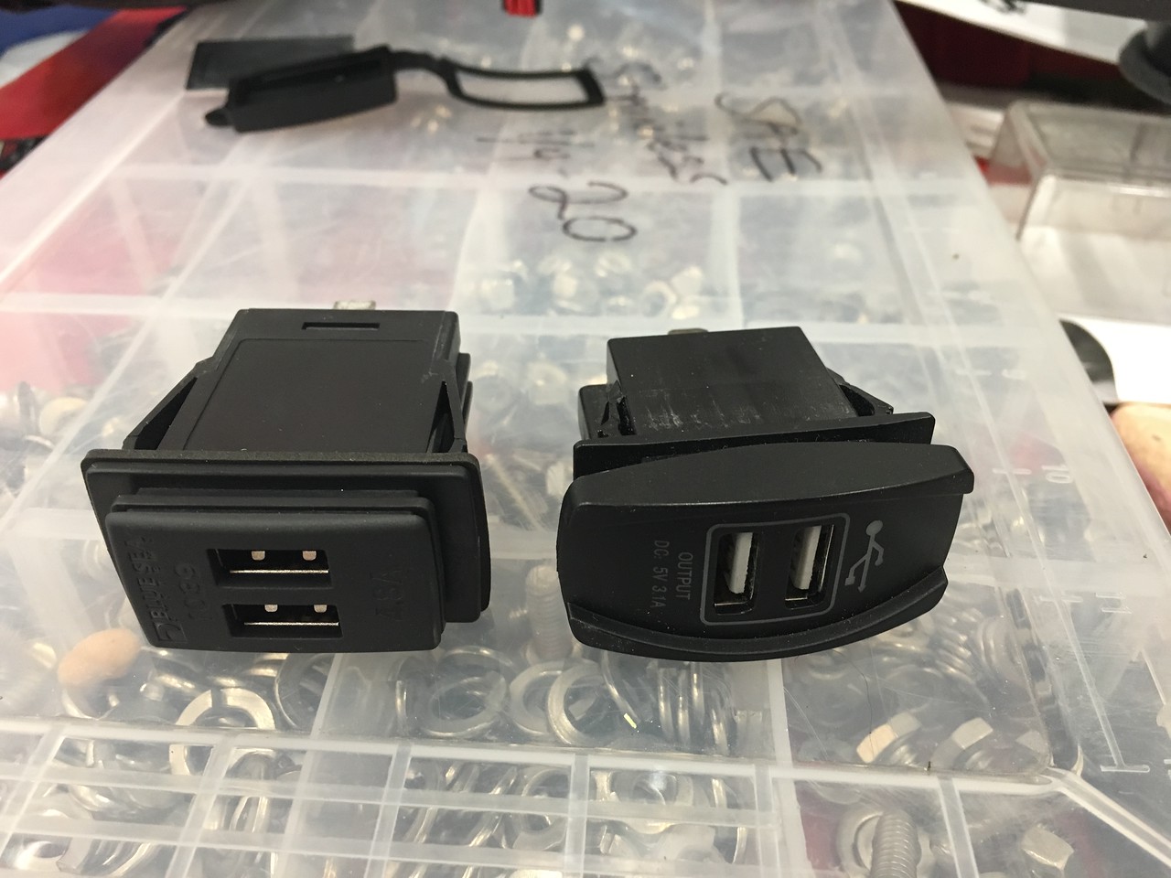

Here's the square Blue Sea charger next to the original unit.

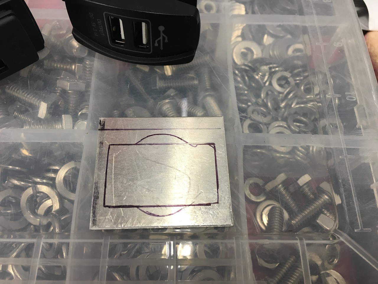

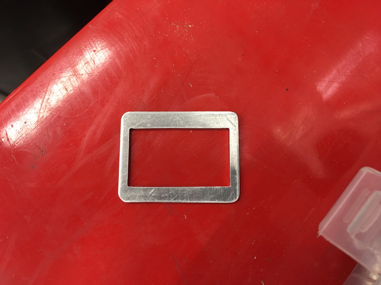

Time to fabricate a cover plate to hide the half round notches I filed into the TPAM mount. A small chunk of aluminum will do nicely.

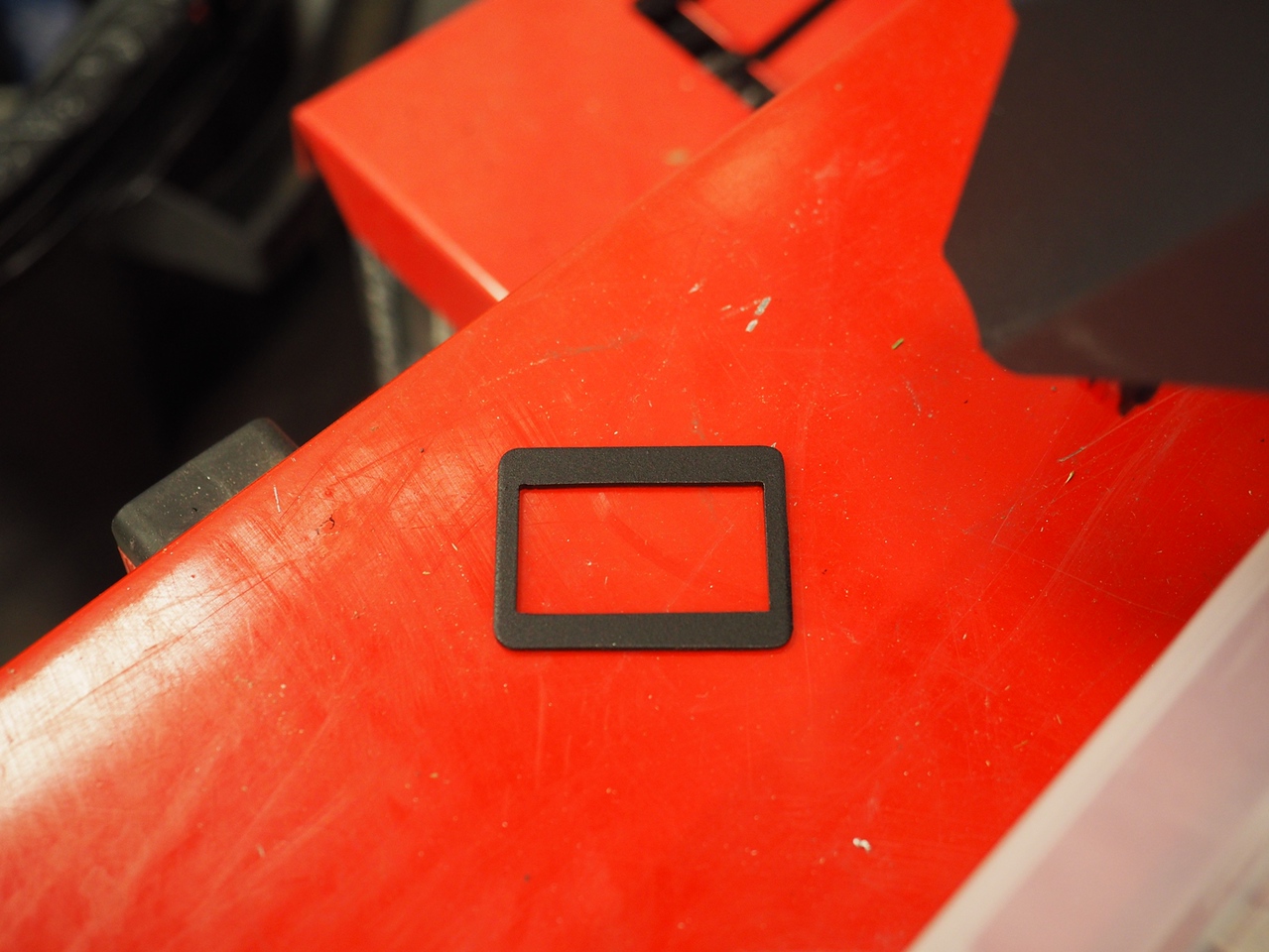

And painted a matching textured black.

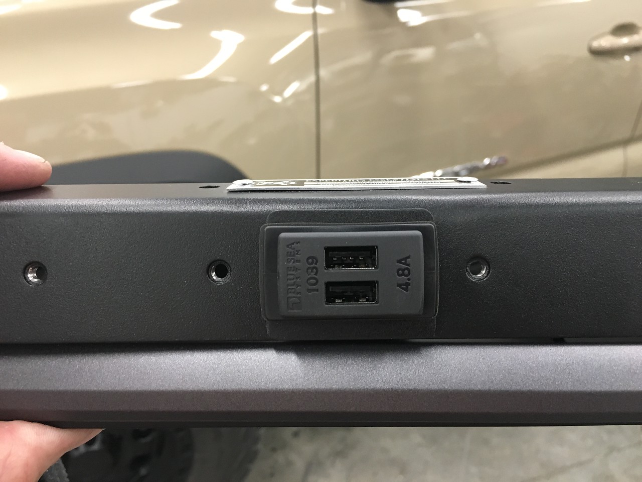

New charger installed in the TPAM mount. I need to trim the rubber gasket on the back of the charger a bit so it doesn't stick out past my cover plate.

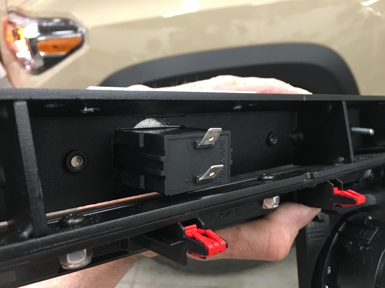

This charger is also slightly longer than the original unit, to give a little extra clearance between the electrical connections and the dash I bent the tabs upward on the back of the charger.

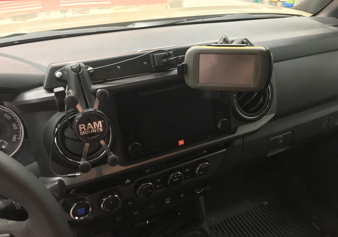

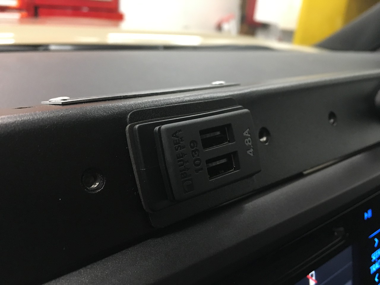

And all mounted back up. My Montana is now happily charging
. Overall a quick and easy upgrade (If you don't try and make it fit a round charger lol).
