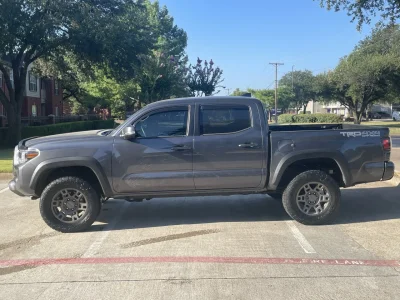

So, I bought my 2021 back in May, and it came with the gray TRD Sema rims (17x7” +4MM offset). They either happened by the PO or the selling dealer. I like these rims (especially since they’re 17”) but what I don’t like is the lesser offset makes it to where when running a 265/70R17 (30.6”) tire, on turns at speed or on minor bumps, they will scuff the mud flaps. It’s no big deal but it bothers me.
For this reason, I have set up a trade for some 2020+ Sport rims, happening later this month. The Sports are 17x7.5” with +30 MM of offset. They are known to not rub on a 265/70R17, even with mud flaps. What I don’t like are the tire options on 265/70, I’d prefer an LT load C, vs the SL or LT E that are available in that size. There are a few C-rated 265/70s, but I don’t want the ones that are available.
255/75R17 has a few tires in Load C that I’m interested in. 255/75 is right at 32”, and obviously a little narrower than the 265s I’ve been talking about. Has anybody run these on a Sport rim with mud flaps and stock suspension and can confirm they will never contact the flaps?
I can always just have Discount install them and return them if it doesn’t work out, but I have a good relationship with the guy’s Discount I go to, so I don’t want to waste his time with experimentation if possible. Hoping someone here has run 255/75 on sport rims before and can confirm they will work. I’d think if 265/70s clear, then the slightly taller but skinnier 255/75s would also, but no way to know until someone confirms it.
Thanks!
Pic of my truck on 265/65R17 and the Semas just because.

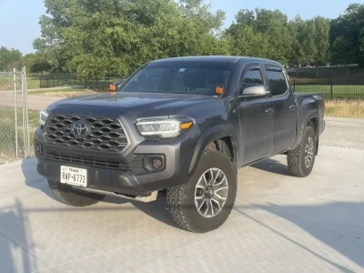

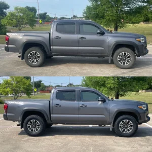

I hate when folks don't follow up on threads, so here I am following up on my thread. I did trade for the 2020+ Sport rims, which are 17x7.5" +30mm. I ran the 265/65R17 Toyo ATIIIs on them for 6 months, worked great.
A few weeks ago I upsized to LT255/75R17 C Toyo ATIIIs on the same rims. Still have factory mud flaps. There is no rub at all, ever. Very happy with my setup. These are on the larger side as well, 648 revs per mile. Most 255/75R17s are more like 650-655 revs per mile. Overall I really like these tires and they complement the stock height and the 5.29s really well. I have absolutely no plans to mess with the suspension at all. Very happy with how the truck drives as-is.
