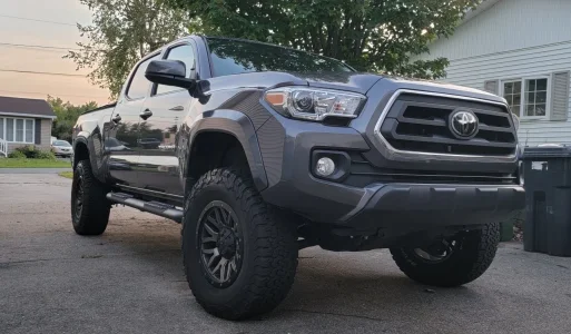

Hello everyone,
I am new to this forum. I got a 2021 Tacoma SR5. I wanted to know if it is possible to get proximity sensors installed with a smart key( both of which ,I do not have) . I have a key with push buttons (lock/unlock). As well as an after market command start(idal-astart)
Is my only option to trade in my Taco for a higher trim?

Don't think it's possible. The keyless entry is an upgrade Convenience Package on it's own.
For the Smart Key/Proximity Sensors, you'd have to jump to an entirely different trim. Only available on the TRD's/Limited/Pro.
It's a lot more work than just programming a key and installing the sensors. Probably an entire new harness. Programming of the ECU for conditions to start.
What is it about the Smart Key that you like?
Welcome Lights won't work since it doesn't have the Proximity Sensor and your key doesn't give off a constant signal.
Smart Key ignition, truck doesn't have the sensor to detect the key. Then swapping out the keyed ignition for a push button. For the parts and labor probably better to just trade in and wait if you want it that bad.
