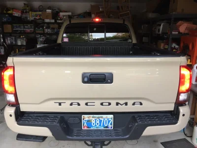

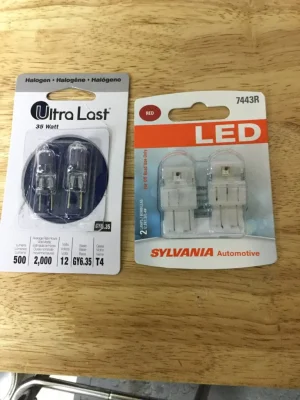

I went with Sylvannia LED’s and Diode Dynamic’s Tail as Turn module on mine. You probably will need to add resistors to eliminate hyper flash. They have run almost five years without any problems.
