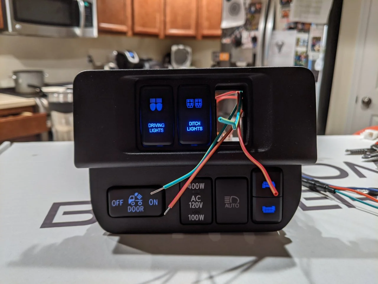

You can get super fancy and spend the money on SwitchPros and stuff or whatever. But if you just want it simple for a few things your setup is fine. Here's a quick diagram.

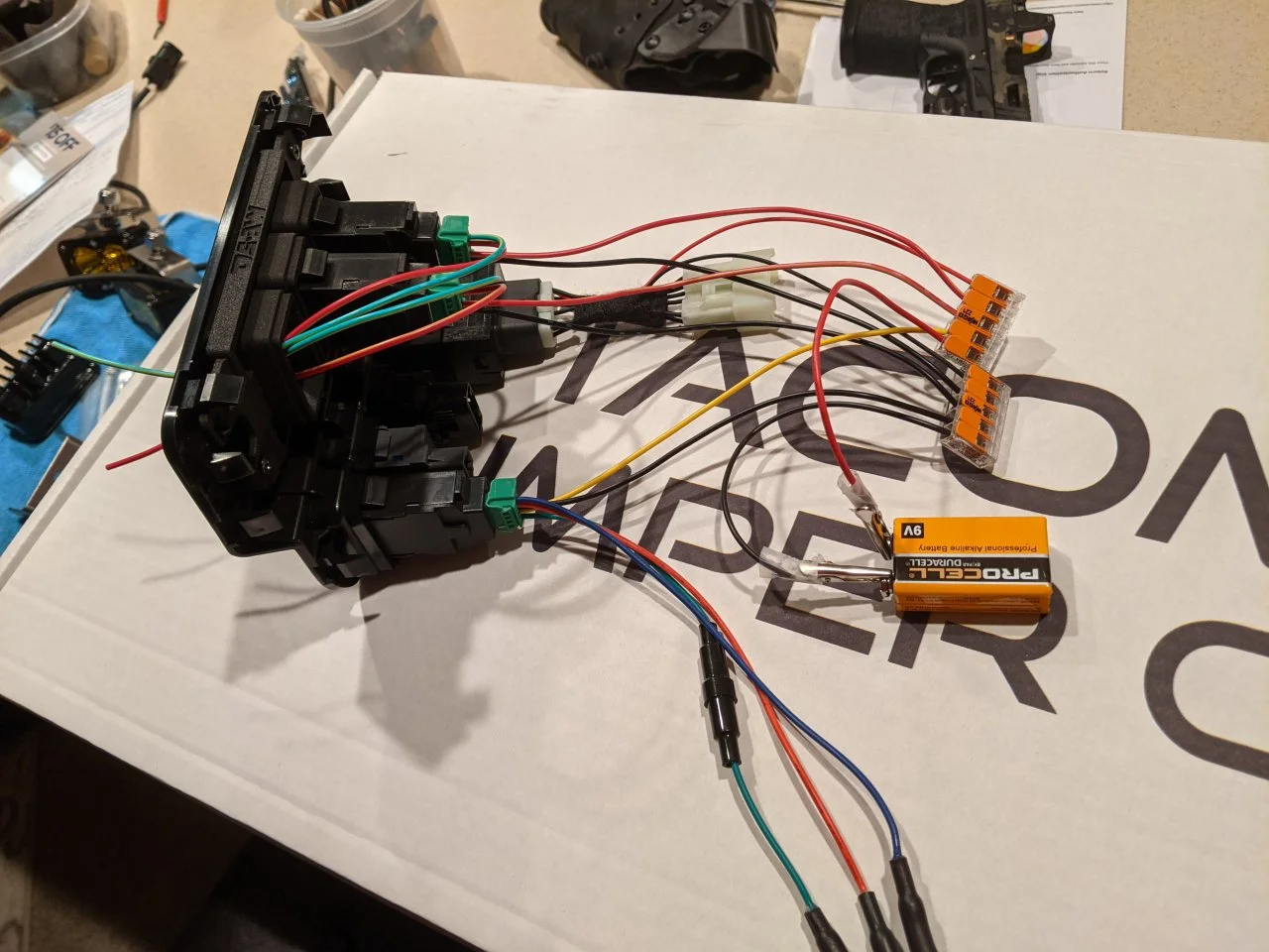

Save yourself a lot of money by not getting the daisy chain harnesses. I made them from scratch before they were released. I opted to dump the harnesses. Price went up and it's a scam.
If you want a 3 switch plate, I have a couple spares if you want it.
I went with Wago Connectors. They were cheap, easy and clean. Ran all the power to light the switches to one switch and them to the adapter. Same with the ground. Then someone offered a PnP harness for the truck bed switch. So it powers off that.
