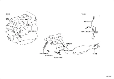

Based on the diagrams, there are two sensors. The upstream (89467B) and downstream (89475h ones both have 4 wires/connectors slots, which is consistent with narrow band. The sensors appear to be the same, other than specific mounting due to the difference in location.
I can't find any definitive info other than that.
