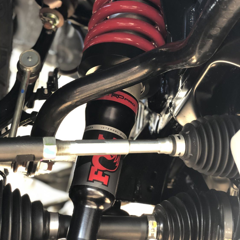

Is there a new TRD Pro Shock? Last I heard they were Fox. I believe there is only one setting. Which is why Wescott gave into the collar option. Which would make it ride more stiff and give a little height. The ones sold separate at the dealer by Bilstein look to only have 2 height options. 1 for the driver side and 1 for the passenger side due to the lean. General guide to tire sizes on factory wheels. 25mm is 1".
Then the only other type is the ReadyLift taller tophat. I think it's no different than adding a spacer on top. They just made it into a solid piece.
The Bilsteins in your pic are from the 2015 Tundra Pro's. The Taco's never got a 4-corner OEM reservoir option.

Ah no, mixed messages. I was referring to how the billstein shocks in your third to last image have those different rings towards the bottom. I thought those were to put the perch at different heights to change the preload/lift of the shock. Maybe it's just the struts with threaded shock bodies and the adjustable preload collar that I'm thinking of. To your point though, the Fox coilovers do not come from the factory to accept more preload.
The third was just the 6112 with the ReadyLift.
Figured so.
