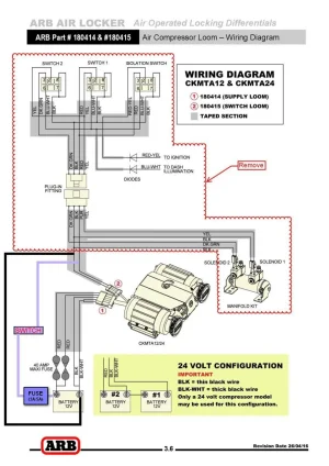

I have the switch on the purple wire and the black wire is grounded behind the tail light. This is not what came with the instructions.
Is this the way its supposed to be wired?
Here is how I have mine wired. Switch is on the purple side.

I have the Expedition Essentials bed cubby mount for the compressor and the ground is behind the tail light. I have thought about moving the ground, but that diagram is making me think that I have the switch on the wrong wire. I can switch the negative side, but I dont know what that will do for the heat being generated. I have thought about running ground wire straight back to the battery, but that is so far away from the compressor. I sat and thought about solutions for a couple of hours yesterday and couldn't think of a solution, so I gave up for the day. The ground and purple wire are both 18 gauge I think. The main ground is much bigger and is ground to the frame. I have a couple of weeks to come up with a solution as its probably going to snow for the next few days. Better anyway so I can come up with a solution.

I would say to double check all your wiring again. I've seen multiple people combine the ground wires with a ring terminal and ground them to a common ground. It may not be a proper ground you're using. Instructions also do say to connect the grounds to the negative battery terminal. I hate trying to diagnose wiring issues like this, I wish I could actually be there and look at it all myself lol. I don't want to steer you in the wrong direction.
