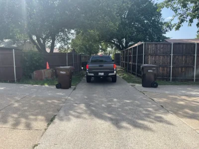

If you zoom in you can see the right side is brighter. Left is VLEDS. I don’t have a comparison with the Mesos.

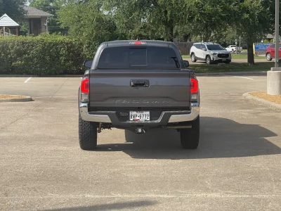

Here it is with the full 4 incandescents.
