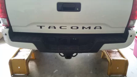

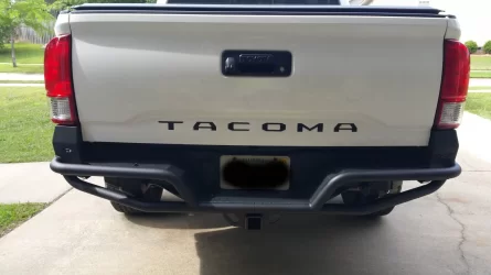

After being rear ended twice, and then backing into a tree, I decided a more durable rear bumper was higher on the priority list. I have the backup sensors and blind spot monitors, and was looking for a bumper that worked with those. After over a month of searching I found 2 brands that claimed to work with the blind spot monitors but they didn't have reviews yet, so I took a chance on the MBRP Full Width Black Rear Modular Bumper, I liked that it was lighter and shipping was easier because of how it split in the middle and install looked easy enough even I good manage it.
Before:
After:
I have no during pictures, install was pretty easy, everything seemed to be going smoothly, then... none of the sensors worked. Here is where the fun starts.
The parking sensors were going off and the blind spot monitor was giving errors when I tried to turn them back on. I was able to get in touch with MBRP, they were very helpful, sent me out new angle pieces for the blind spot monitors and the 2 middle parking sensors, still nothing... Finally while on the phone with MBRP, one their engineers said to try rotating the parking sensors... it worked. The parking sensors have a vertical and horizontal orientation, if they are not lined up right the will detect the Bumper as being to close. Also found out that blind spot monitors will need to be re-calibrated. Finally got around to taking the truck to my local dealer, $400 to re-calibrate. Then on the way home they stopped working again, talked to my service rep and he said they will keep going out of calibration, anything can set them off, so I thanked him for telling me this after I spent the $400 and have never been back to that dealership.
So here is the Tip: If you have blind spot monitors, do not replace your factory bumper unless you are okay not having blind spot monitors anymore.
