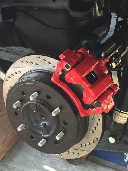

Has anyone done this conversion?

The rear brakes arent gonna help us in terms of stopping being heavier trucks since the fronts do majority of the braking power, we both need the big brake kits up front. I want to swap to discs in the rear because I dont find the drum's to be reliable anymore
Honestly, for those of us with ATRAC, it might be easier to wait and retrofit the rear disc brakes off 4G Tacoma
Good point.
