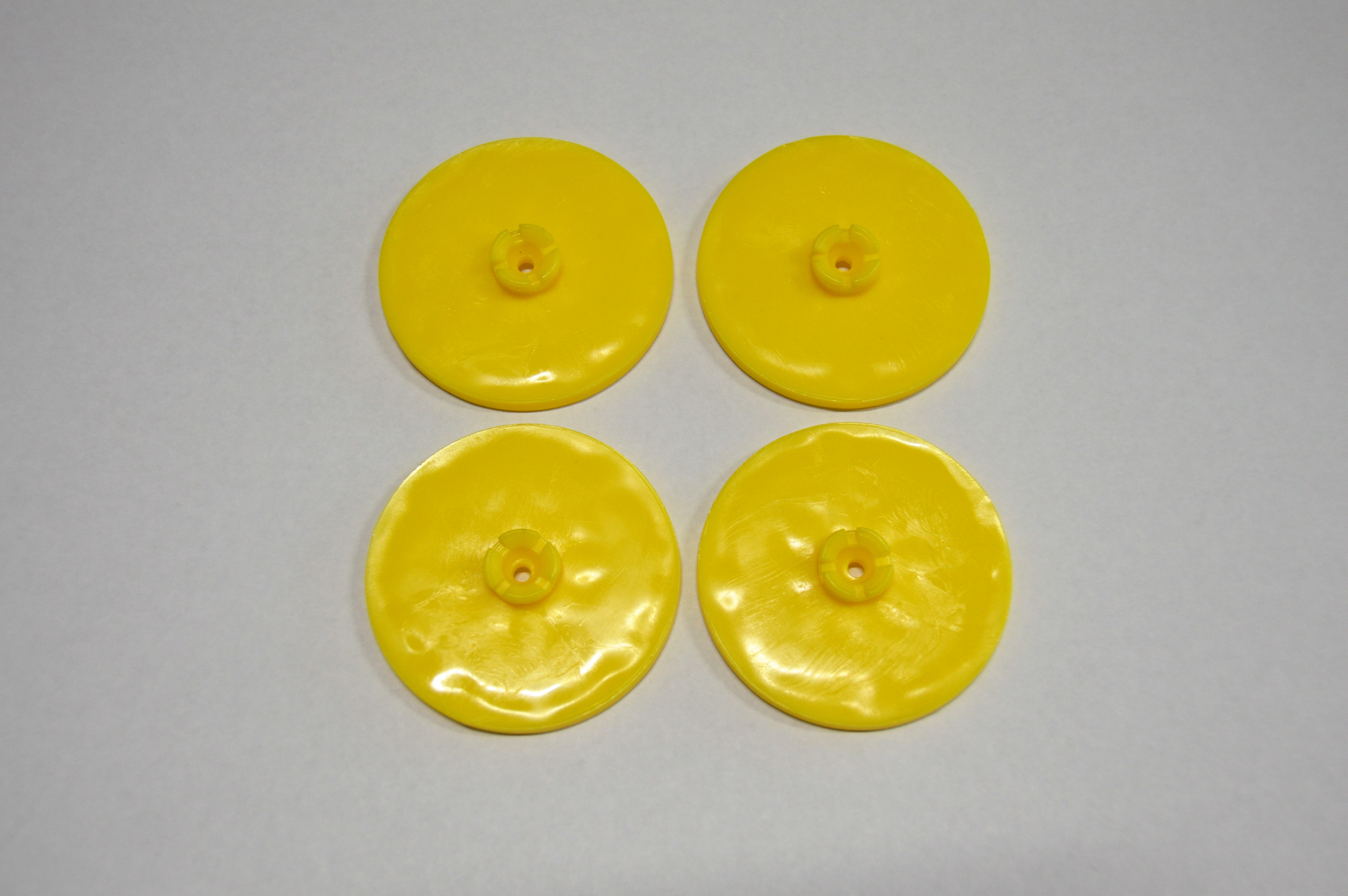

I'm very happy with my Deavers, but it looks like the Dakar's have recently gone thru a redesign and changed the isolators and refined them a bit.
If the setup you get is still old, then swapping the isolators to these is said to be the fix: https://www.amazon.com/dp/B000TYU0FM/?tag=tacoma3g-20
Info taken from this page: https://www.tacomaworld.com/threads/squeaky-ome-dakar-leaf-pack-fix-solution.487394/page-12
That said, not sure if they still need to be trimmed on the rearmost edges where they connect to the shackles so they don't eat the shackle anymore.
