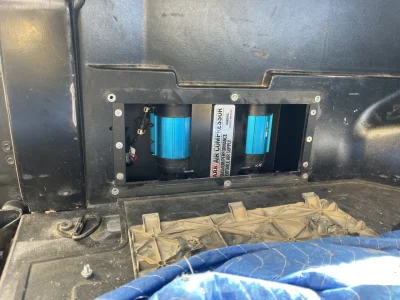

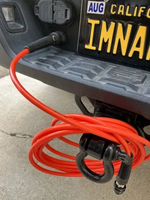

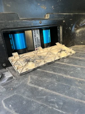

Yep - I’ve disassembled the ARB kit and am using the larger cubby for the compressor. The tank I’ve mounted underneath the compressor, worked out fine. Purchased some custom air hoses and ran the air port to my rear bumper. Last night I did a test run, no leaks or issues. Almost done

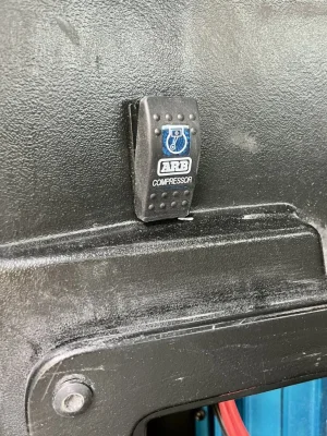

I have mounted the air port, switch, compressor and tank. Still need to run the electrical

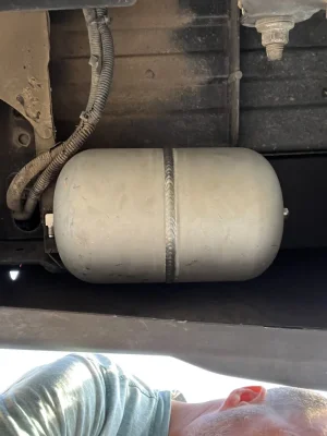

How big is that tank? The twin is so fast I wouldn't think that would be necessary unless the tank is really big.
Hi - it is the original tank from ARB’s portable setup, 1 gal. I reused it, mounted underneath the trucks bed cubby on driver side.
A tank would be useful if you have anything air powered, like a horn or locker, though. But yeah, that twin is going to be really fast.
Why would ARB pair that sized tank with the twin configuration? Maybe out of convenience?
