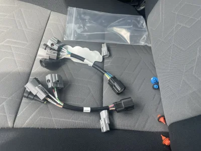

It is not plug and play unless you buy a harness. Daveeasa sells one through his site, FBC harness solution, as well as Morimoto has a version and a few others do too. I would (and did) go with the Dave one, he does the nicest work and uses nicely labeled and uniquely colored/striped wire.
The year and trim thing is pretty simple. 2016-2019 all TRDs used similar headlights with the L shaped DRL. They are all wired the same, the TRD Pros had a darker housing but still same bulbs and connectors.
2020+ started the TRD Pro LED headlight package, which the TRD Sports and Offroads received as an option, so some of them came that way and some didn't. So if you are a 2016-2022 TRD Sport or OR with factory halogen lamps, you need the Dave or Morimoto harness.
In other words, it's only plug and play to go to the LEDs if you already have the LEDs....in which there is no sense to do so because you already have them. If you do not have them, then you will need a harness. They sell harnesses for SR/SR5, and the more popular harness for TRDs.
The OEM lights are around 1300-1400 from Sparks Parts using Chloe's discount code. It's pretty steep, but that's the price to pay for an item like this. Sucks, but they sure are cool.
Here's a picture of the harness from Dave. I bought it for my 21 TRD OR that has halogen lamps. I would need this for any 2016-2022 TRD with halogens.
The only differences from 2020 and onward is that they could have had the upgrade from the factory, but many of them still did not and were wired the same as a 2019 or prior as a result.
