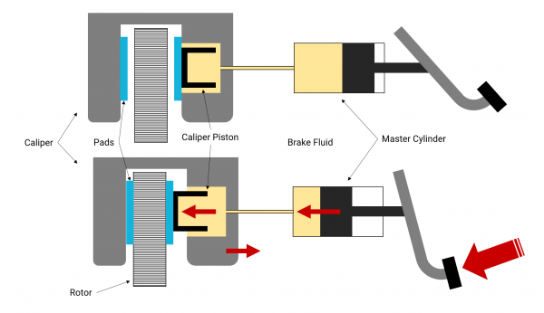

Figure 1: Brake System Schematic
The schematic shows how the brake fluid (light orange) is the medium in which force is transferred without a brake booster. The force of the pedal gets converted to pressure through the master cylinder. That pressure is transferred from the master cylinder to each caliper, through the brake fluid. The pistons in the calipers then convert that pressure to a force that clamps down on the rotors. Drum brakes work in much the same way.
For the system to work efficiently, the brake fluid must be able to move easily through the lines (kinematic viscosity) and must be able to efficiently transfer the pressure from the master cylinder to the piston. The efficient transfer of pressure relies on the incompressibility of the brake fluid. When we talk about brake fluid, incompressibility is related to the boiling point of the fluid. We’ll get into how later on in this article.

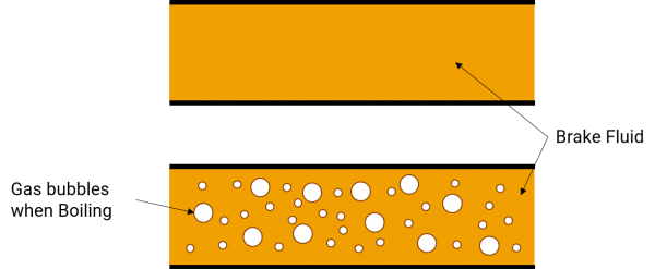

The boiling point of brake fluid is another key characteristic and a fairly important one since at this point, the liquid turns into a gas. Gasses are compressible and will severely reduce the effectiveness of your brake system.
Compressibility of a fluid means how much a set mass of the fluid can change in volume when a pressure is applied. Compressible fluids will result in a very inefficient brake system: your pedal will need to travel further, the reaction time of the system is much slower, and the resulting clamping force to the brakes are significantly reduced.
All brake fluids are designed to be as incompressible as possible in their liquid state. However, if enough heat builds up in the caliper from excessive brake use, the fluid will boil and gasses will be produced. These gasses displace brake fluid in the lines and introduce compressibility, making for a very mushy and ineffective brake system.
Figure 3: Illustration of Gas in Brake Lines

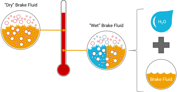

This boiling point is called the Equilibrium Reflux Boiling Point (ERBP). The ERBP is the temperature at which the uncontaminated (moisture-free or “dry”) brake fluid begins to boil… Which brings us to another point.
Another factor that affects the boiling point of the fluid is water. Most brake fluids are glycol ether- and borate ester- based brake fluids which absorb moisture (i.e. they are ‘hygroscopic’). Because of this property, the moisture from the environment gets absorbed into the fluid and the boiling temperature is reduced (water has a lower boiling point).
This “wet” boiling point when moisture is mixed into the brake fluid is called the Wet Equilibrium Reflux Boiling Point (Wet ERBP). The Wet ERBP is the temperature at which the fluid begins to boil after it has had time to absorb moisture from the surroundings. This temperature is a good indication of the limits of use of a moisture-contaminated fluid.
Figure 4: ERBP vs Wet ERBP.
