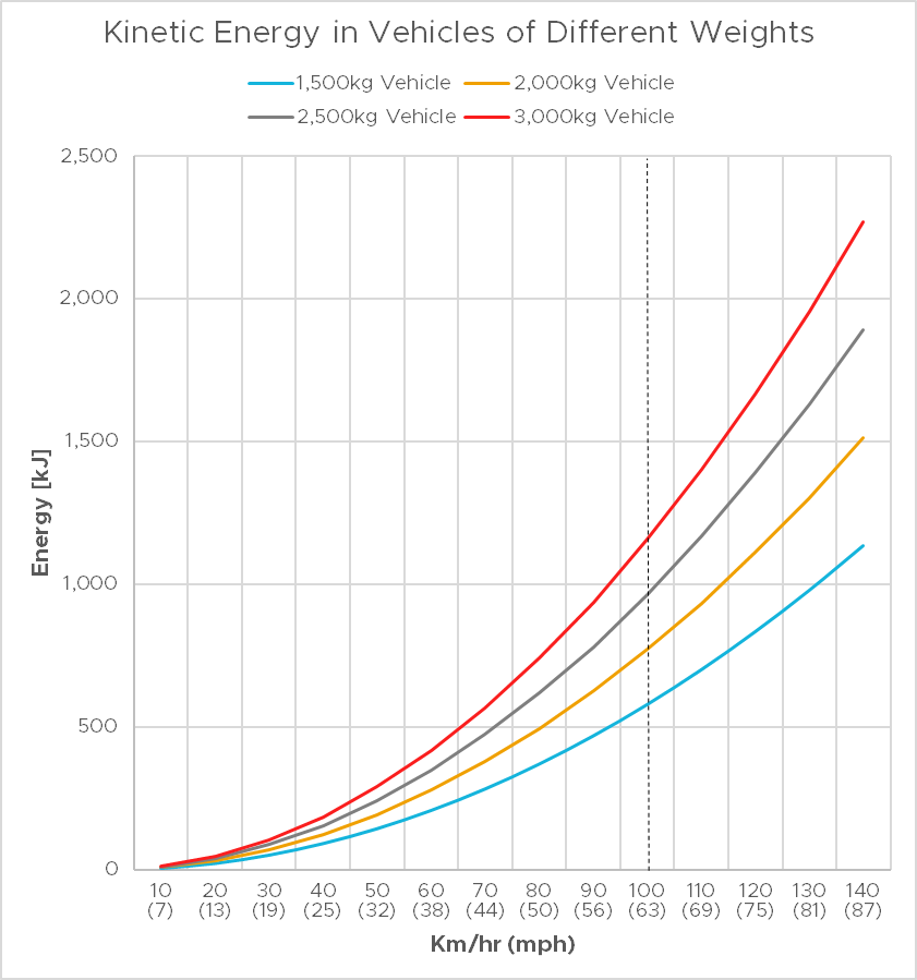

For those preferring to get a little more theoretical, remember that the equation for kinetic energy is ½ x [mass] x [velocity]2. So, we can see that the two variables that effect energy are mass and velocity. As mass increases, energy will also increase linearly assuming velocity remains the same. However, when velocity (speed) increases then there is an exponential change in energy. This is the energy that will need to be transferred to thermal energy. The more kinetic energy built up, the more energy you’ll have to convert into thermal energy.
The below graph illustrates energy build up at different speeds and different weights. The energy built up is the energy that will need to be converted into thermal energy in order to stop the vehicle. You can see how energy increases significantly as speed increases for a given vehicle weight. Doubling the weight of a vehicle will double the energy whereas doubling the speed of the vehicle will quadruple the energy!
