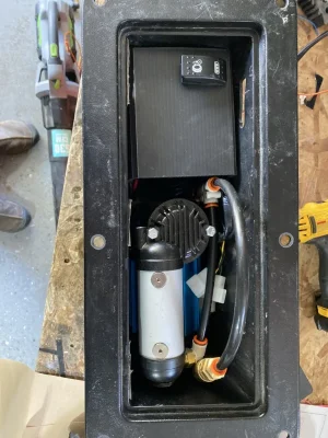

I have an ARB single mounted in the driver side bed cubbie. It's not cheat, but it does come with all the wiring, switches and relays you need.

So you store it in the bed cubbie thing and take it out when needed? Can you show me kind of how your setup is by chance?
No, it's mounted in the cubbie, hard wired with a switch and i run hose to an air chuck and then connect a hose and inflator and take that to each tire.

How did you run the wiring? Would wiring into the bed outlet so when you turn that on you can turn the compressor on work? I'm not the best with electrical stuff lol
The wiring runs up to the battery.
