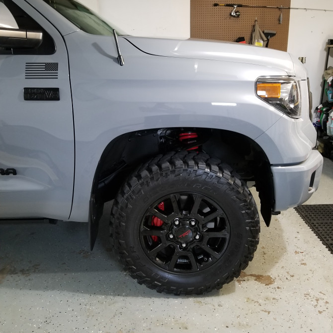

my spurrrr taaayre. 285s until i get back to Cali on saturday.

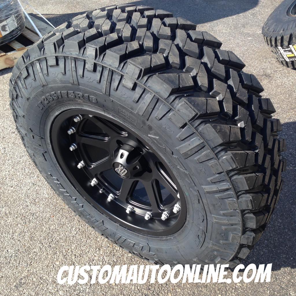

Who's going to be the first to run a 285/75R18 (35x11.5") on a 3rd Gen Tacoma? That would be pretty bad ass.

Of course appearance will always play a factor and I'm certainly not trying to talk anyone in to anything, but I look at it like this: Aspect ratio is a constant, so that 35" tire on an 18" rim has the same sidewall height as a 33" tire on a 16" rim or a 34" tire on a 17" rim. Same amount of rubber, same amount of cushioning, same amount of everything, only a taller overall diameter which means more ground clearance at the same given width. Width being our biggest enemy, it seems like a better option than 315s... if you can get past the looks.
Just playing devil's advocate. I don't plan on running it personally but I think that size has real potential on these trucks.
