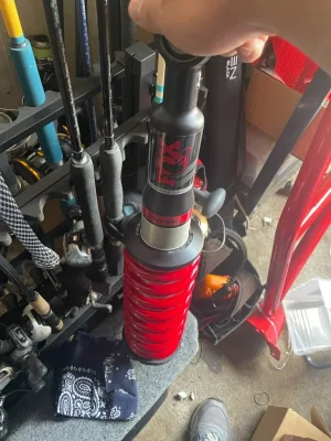

I have a frien that came up on some 2020 4runner fox coil overs. But i am not sure if they will fit?
Is it even worth installing?

Looks like it will be softer than what you have and all 4 corners will fit. Rear needs different lower bushings though. Seems like a pretty simple swap.
I'd throw it on and see how it does, then put a small top hat spacer if necessary (easiest) or hit up Westcott for one of their OEM Pro lift upgrade kits depending on how it sits.
