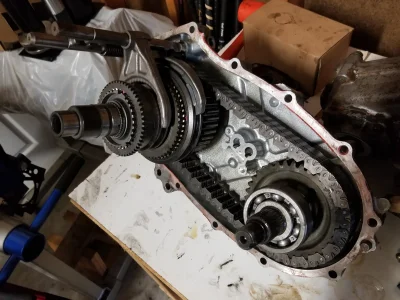

Low range is a 4 pinion planetary gear set and the front output is chain driven.
