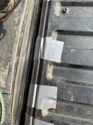

Looking for some help on this problem: 2021 TRD Off Road 5' bed with BAKFlip tonneau cover. I'm in Canada at the moment and have the bed loaded with camping/fishing gear. Everytime I'm on gravel/dirt I get TONS of dust in the bed which covers everything. I have taped hard plastic door molding to the base of the tailgate (right side on photo) and also attached foam-backed adhesive tape to the end of the bed just beyonf the liner (left on photo). I have also taped the edges of the tailgate before driving on dirt/gravel, which obviously I remove and replace with fresh Gorilla tape whenever I need to open the tailgate. Nothing works.

Are you wanting to totally seal off the bed area? There are a couple holes in the side cubbies that allow for water to escape as well that can let a decent amount of dust in.

Thanks-I haven't seen the inside of the bed since I bought it and immediately put the bed cover on since its always been full of gear. Is this what you're referring to?
No, the third gen doesn't come stock with the cubby above the wheel wells. But there are either 1 or 2 big ones behind the wheel wells depending on your year. I added the pre-2021 storage to my bedside. Long story short, they let a ton of dust in if you don't seal them up.

I live just out side of Carson City Nevada. So I know all about dust and dirt. I have a 2017 Yoda and a Tune M1 camper I can tell you that there is absolutely no way that you’re going to get rid of all the dust. It will find its way into your truck bed no matter what you do. However with that being said you can limit a lot of the dust by doing a few things.
Thanks-one of those items looks strikingly similar to to door jam insulator I taped on. But that tape doesn't last long. I will add this to the list when Zi return from Canada

I put in a rock block tailgate seal kit and it made a huge difference. I hardly get any of the Arizona dust in my bed now.
