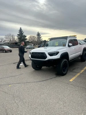

Full housing, the top putter rim has a white led strip that’s always working fine turn signal switches it from white to orange that’s like a 3 stage motion light….
I bought this truck used with a lot of aftermarket parts and I don’t know who the previous owner is, so I can’t even ask questions…. Just odd as it was fine for the last few months and now it just started acting up and it’s extremely random on when (more often now) and which side decides to do so…
Hmm based on the photo, unsure what those headlights are, but I would guess it's due to something internal with them. Not to be rude, but they look pretty low end and the low end tech does not work as well with all the functions. These trucks are pretty sensitive to voltage changes in the turn signals, especially if the tails are led as well. Experiment with having the lights setup in different ways to see if you can isolate when the hyperflash happens (headlighs on/off) and or if it takes x amount of blinks before it starts. I was hoping it would be a quick bulb swap, but doesn't look like that is the case. You might be able to fix it with inline resistors, but my recommendation would be to upgrade the housings to the new Morimoto Evo's (though I'm slightly bias about those) for an overall upgrade in function, output and looks. They're really built with oem quality and are the only headlights on the market brighter than the ugly factory led option these trucks had available (with supercharger upgrade).
