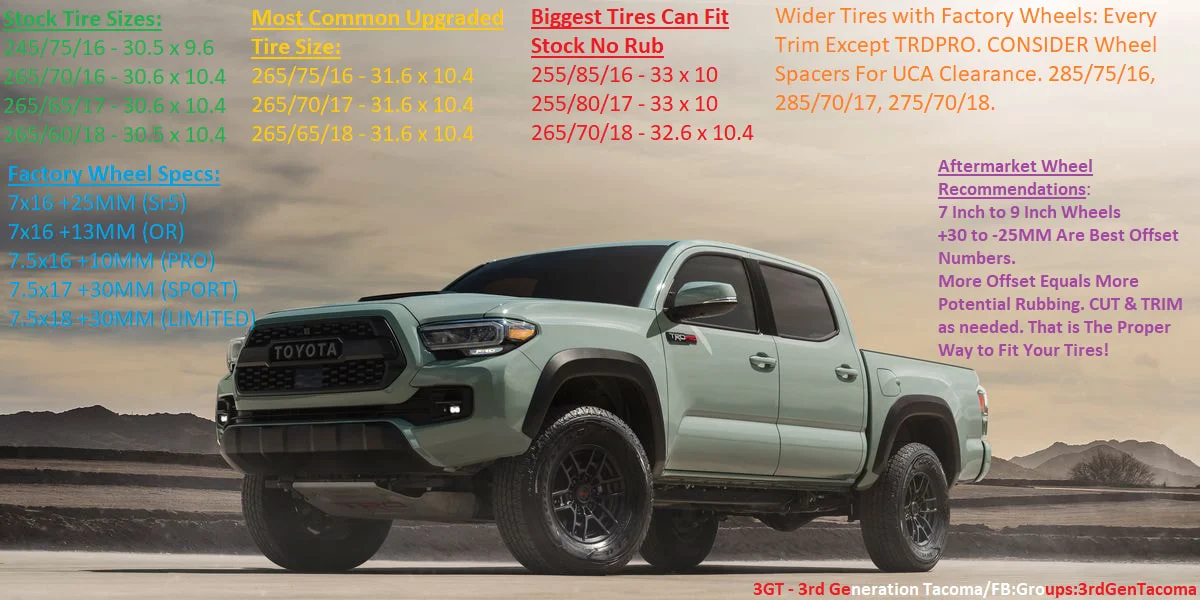

So I wanna get these Black Rhino wheels... but, I have no clue how this offset stuff works... Will these Wildpeak tires fit on these wheels? I don't fully understand wheel offsets and all this fancy shit yet

What wheel size and tire are you thinking about getting?
Lifted? How high?
I can plug it in for you and take screen shots. I'm probably around 2.5-2.75" with 16x8et-31.75.
16 or 17?
16x8et0 - Will sit you around flush.
16x8et-25 - Will poke out slightly passed the fender. Like 1/4".
-38mm is 1.5". Just remember the further out you go, you risk rubbing when turning if you're not high enough. 3" should be pretty safe for all the offsets except the -38mm in 17".
First one you basically enter the factory wheels and tires.
Second one you enter the wheel and tire that you are looking at.
Will tell you how far or close it will move the wheel and tire. Then you guesstimate if you're gonna rub.
