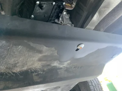

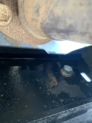

Had to drive up to Nor-Cal for a family emergency and when I got home, noticed a puddle under the truck and a giant wet spot on my transfer case skid. Truck is leaking oil from the transfer case.

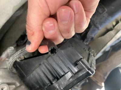

More exciting discoveries, the dealership did not replace the breather hose from when the transfer case actuator was replaced and transfer case rebuilt. Instead, they left the cracked, old piece of shit on that was barely on the actuator.

Wow. Sorry man, lots of cracks have quite fallen through. Hope this gets resolved soon.
A bit to much and I’m surprised how uninvolved management at the dealership and Toyota wants to be about this. You’d think with having the truck for 25 days total and now 4visits in barely over a month some alarm bells would ring.
Anyways, trucks in for another warranty repair. They didn’t reassemble my transfer case correctly which caused the leak.

Got it back for the fourth time. . Still no response from management. Didn’t give a shit about the rotted breather hose they left on the t case actuator that they had to do multiple warranty repairs to or the fact they left shit loads of oil still dripping out and off everything.
