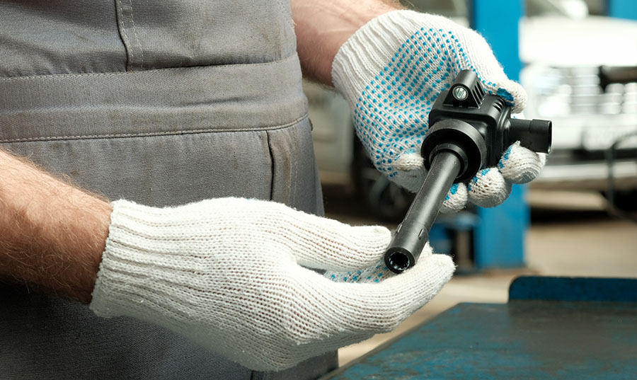

Toyota Tacoma bad ignition coils symptoms, causes, and diagnosis​
The ignition coils are part of the ignition system in Toyota Tacoma, responsible for amplifying the relatively low battery voltage from 12V to a high voltage of tens of thousands of volts for the spark plugs. Driving your Tacoma with bad ignition coils can damage the engine or the catalytic converter, so you must act urgently to avoid more expensive repairs.

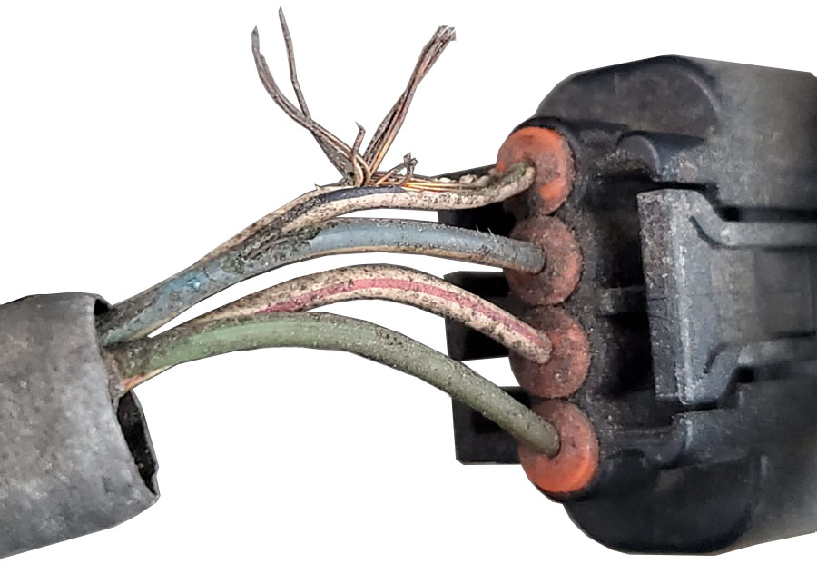

Rodent damage or faulty connector/wires​
If bite marks are discovered under the hood, there is a high probability that a rodent has let off steam in the engine compartment of your Tacoma. Then it is important to carefully examine all the cables and hoses for damage, including electrical wires and connectors for the ignition coils.
When the electrical wires or the connector for the ignition coil goes bad, you may see an error code between P0350 to P0362 when you hook up a code scanner tool, which indicates an ignition coil circuit malfunction.

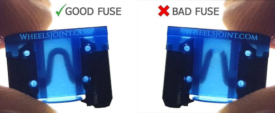

Blown fuse​
The ignition coils in Toyota Tacoma needs electricity to work. In case of a faulty fuse, the circuit is interrupted and the coils will not fire. Check the owners manual or the fuse box cover of your vehicle to find the exact location of the fuse for the coils. If the fuse is blown, replace it with a new one with the specified amp rating.
To check the fuse, pull it out of the fuse box using a fuse puller or needle nose plier and hold it against the light. If the metal strip is broken in the middle, the fuse has blown. You must replace it with one of the same amperage and therefore the same color. It does not matter in which direction you insert the fuse.

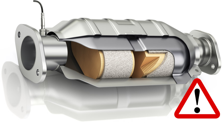

Catalytic converter failure​
If you continue driving your Tacoma with faulty ignition coils for extended period of time, it can cause total meltdown of the catalytic converter. Since a bad ignition coil cause the engine to misfire, any unburnt fuel that escapes from the combustion chamber will ignite inside the catalytic converter which will overheat it. Repeated overheating can melt the internal structures and will eventually clog the catalytic converter, which will then need to be replaced at a high cost.
Catalytic converters contain honeycomb-like structures with tiny pores that are coated with platinum, rhodium, or palladium depending on the catalyst stage. If these pores get clogged due to improper engine combustion (e.g. because of bad ignition coils), the exhaust gases cannot pass through easily. This suffocates the engine and causes performance issues.
