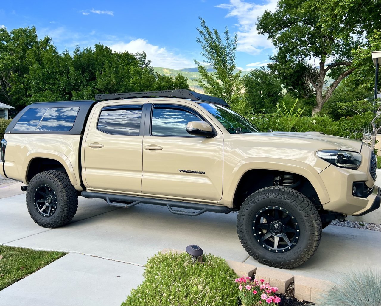

Just pulled the trigger on this ARE Topper.
Not my truck, but looks cool with the rack.
17cc0bd3-8aa9-4637-873e-e2bf8eb5cde7-jpg.5303389
bonifacio
7️⃣ Connoisseur
1,580
2,313
One is a P and one is a V.
You'll have to ask your dad about "the talk".
