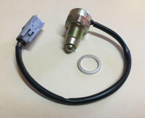

This switch?
I bought the truck new in 2015, straight from a yota dealership. No issues with backup lights prior and passed ever annual safety check, which inspects backup lights. Rear bulbs have never been changed since the truck was purchased. Initially thought it might be a bulb, but both lights are out.
Dash fuse for backup lights looks ok and doesn't appear to be blown. Hood fuse it's a larger, opaque object and I'm not sure how to inspect if it's off.
That switch looks similar to what I have seen in videos, but all the examples seem to correlate to M/T. I tried inspecting the location of the switch in the available videos to try and find this switch, but everything looks very different.
You're right. The one with the pressure switch is for M/T.
A/T has a module type switch.
I'd say clean up the outside, unplug the cable at both ends, inspect, carefully clean with a brush or Q-tips/alcohol and seat firmly. Hope it works out for you.
