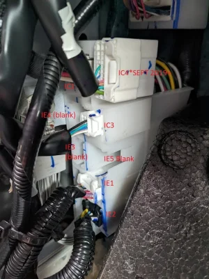

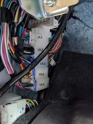

I'm working on a seat heater install (will post how I wire it later) and needed to ID the location of connector IE2. Between the similar nomenclature and the cold outside, I decided to photograph the connectors and identify them inside. Since I didn't see it anywhere else on the internet, I wanted to share.
If you are looking for the location of IA1, IA2, IA3, IA4, IA5, IC1, IC2, IC3, IC4, IE1, IE2, IE3, IE4, or IE5, take a look at the images. This is from a 2021 SR5. Note that IC2 is actually not in the pictures but the location is the same as IC4. IC2 was used pre-Sept 2019. Incidentally, the factory seat heater connector is pin 5 on IE2 (the passenger side is pin 7 on IL3 but it isn't pictured)
edit: per the factory diagram, the seat heater is on pin 5 of IE2. During testing, I determined it is actually on pin 4 of IE2 which matches the color of the factory diagram.
