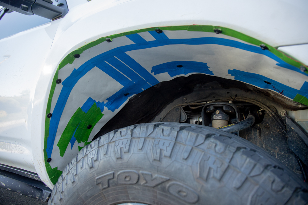

Here's another method to try if you wanted to go further.
I purchase a large roll of hard plastic. I forget what material it was, but I can take a look and let you know. I was gonna just make my own set and mount it in there with clips. Just been lazy.
Just go with heat gun, mold it, press it further in and hold it there,. While it's hot, just spray it with cold water to set. Should be enough.
