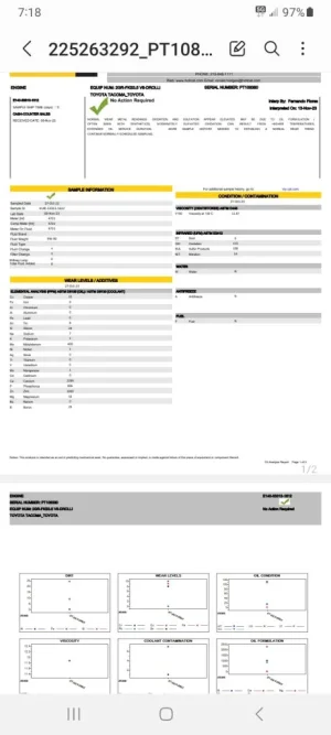

So I did a UOA on the Tacoma. 9500 miles on the truck, 4721 miles on this change. This was the 4th oil change
.How's it look for a 2gr-fks with 9500 total miles?

Looks fine, metals are still a little high but this normal on break-in.

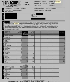

I'm no expert, but how you get the metal numbers are high?
I threw it in the Blacstone format and compared it to averages.
The only numbers that seem a little high was Copper and Tin. Even then the values didn't seem significantly higher.
Dustin
Just from comparing to other tests, I think it looks good.
Only things that seemed to vary was Molybdenum, Calcium, Magnesium and Phosphorous. Those are all anti-wear additives.
Next time I'd say go with Blackstone Labs, since it seems the most common. That way it's easier to compare and see differences. The lab also includes synopsis analysis of your oil. I just averaged the first 2 results I came across.

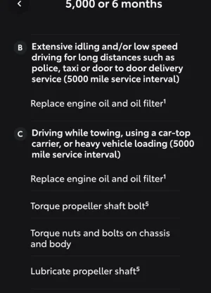

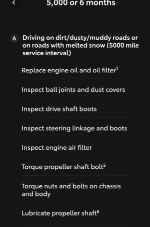

It’s difficult for many to believe that marketing takes priority over engineering in the USER manual.
Source: https://youtu.be/v4JS7PybV2k?si=SM0y19G1wY4MmZg6

Averages is based on submitted information, it’s not necessarily something to strive towards. This is a pretty good example. My motor is still too new for a UOA, I’m definitely interested in see how she looks.

The manual also give stipulations that decrease the oil change interval to 5K. It’s called severe schedule. Guess you didn’t take note of that on the manual? Many owners will fall into the severe category if they read the manual.
Many experienced Toyota techs warn against pushing oil changes out to 10 K.
It’s wonderful to have an opinion. It’s also great to not try to push that upon other people.

My air filter is irrelevant. I never sent my oil in. Numbers and stuff were just ones I found online.
I understand averages are more of a baseline. If they knew the ideals numbers, they would show that and not averages.
I based my input on the analysis of Blackstone and what they documented for those users.
Upvote 0
OK so the silicon numbers on that chart you posted. They seemed a bit high. Guess I missed the statement where you averaged a couple you found.
