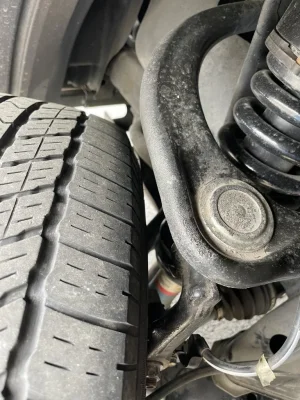

I recently installed a 2” leveling kit with a 2” rear block. I didn’t take before pictures, but I noticed the upper control arm sits very close to the inside of the front tire. If I try to put my hand between the tire and control arm I can only get to my knuckles before I can go any further.
Is the control arm supposed to sit that close? Or is there something going that shouldn’t? Everything I’ve read about the 2” kit is that no extra modifications should need to happen. If anyone has any insight on this very much appreciated. Thanks in advanced
This happens with factory control arms and high offset wheels. Not a great combo but if you're not rubbing and you are able to realign in spec (with higher caster settings to avoid rubbing on the cab) then you should be fine.

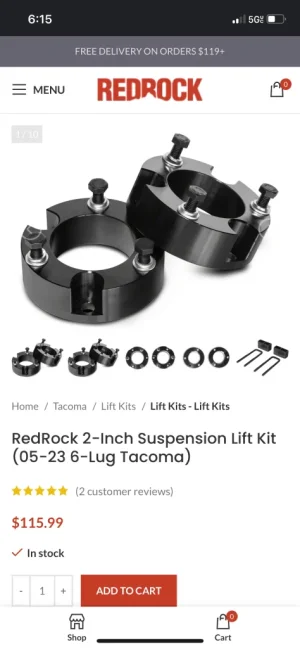

Thanks for all the feedback. So attached is what I have installed on my Tacoma

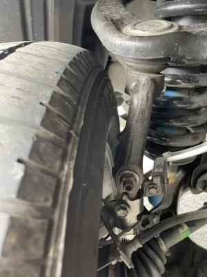

Here are some pictures where I have questions.

Based on those pics you have tons of clearance. All the components move together so you should not rub if you stay with this setup. If you do end up going with wider or taller tires on the factory wheels it would be a good idea to get wheel spacers. 1-1.5" is a popular choice.
That kit also looks like a 2"F/1"R spacer setup which puts you in a much better place in the rear. If you measure the height of the rear block that will tell you how much lift exactly it got. The rear lift is 1:1 unlike the front setup which is witchcraft to figure out (something around 2-2.5:1).

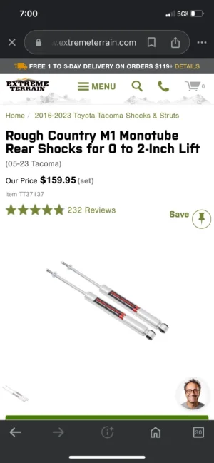

These are the shocks I had purchased, but hadn’t installed yet
If you have them already, definitely throw em on.

I just realized that the 2” front spacer is really giving me a 3” lift with the combination of all the only factory hard ware. That a true statement?
I’m also curious why my kit didn’t come with spacers to lower the differential?
eBay I don’t want is I got this really cool looking truck or at least to me it is, and I’m wearing out the component quicker than normal. Hence the thought of taking the truck back to factory and that would allow me to run a 265/70/17
I don't know what it's doing on your truck. Sorry this is the first time I've seen that kit. Looks like a typical spacer kit though, IMO they're all about the same unless you go with a Westcott setup. If the front spacers are 2" tall, then they will lift the truck more than 2". Diff drops are generally not a great idea on these trucks because it changes how the front diff sees oil. There's a whole rabbit hole on that you can look into if you want to search.
Best thing to do is measure before and after from center of wheel to bottom of fender to see how much lift it added. If you don't like it, take it off and get something better. I wouldn't run more than 1.5" total lift out of a spacer on these trucks with the rest of the stock equipment.
