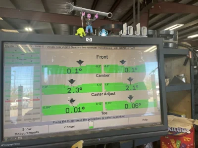

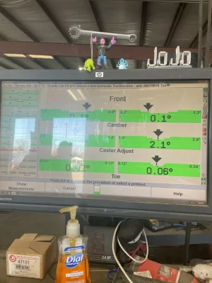

So I’ve done a post about this previous but I thought I’d go back into it now that I have an alignment sheet.
I finally went to an alignment shop the other day that actually gives out alignment sheets and the guy tells me that the truck is perfectly in line.
He checks the frame and all the other components of the front end to see if anything else has went out like ball joints, tire rods, etc. Basically anything that could be making the truck pull.
He ends up not even charging me the $75 for the alignment as he really didn’t do any work.
I’ve had my tires rotated and balanced several times to see if swapping the tires around would eliminate the pulling and it really never does. It’ll make it drive a little better on the way home but then will go away.
Btw, I have 35x18x12.5s Atturo M/Ts on a 6” Pro Comp lift.
So my question is, what could be making my truck pull?
Here is a picture of the alignment computer screen as his printer was messed up.

Is your rear axle centered properly and leaf spring u bolts are tight? I’m assuming there’s blocks in the rear

Just take measurements of where your wheel is sitting on the drivers side compared to the passenger side. If the axle isn’t straight it could be making it feel like your pulling one way. I would say check the torque on your u bolt nuts but just throw a wrench on there and make sure they’re not loose. Is it a really excessive pull to the right?

I’ve taken it to a place that specializes in off road alignment. They’re one of the only places around me in Mississippi that actually gives alignment sheets. There’s not a whole lot of options here, especially when it comes to overlanding type parts.
It pulls to the right constantly. If you let go of the steering wheel then you’re going in the ditch.
If it’s wearing unevenly then it would just need new tires right? Cause I’ve done balancing and rotating and it never fixes anything.
They put like 11 ounces on one side one time and it straightened out a little for a few days then went back to shit after.
But then people say that if it’s pulling then it’s the alignment. But my truck is perfectly aligned with nothing bent or going out up under the front end.
So what can it be. How can a truck be pulling when everything is in check..

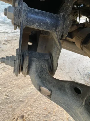

Sounds like a huge geometry problem. Combination of tires lift and everything else. Probably gonna have to take it someplace that specializes in off-road suspensions not just alignments and have them go through it.

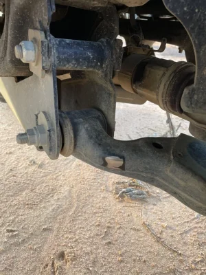

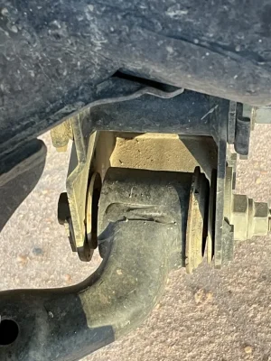

So I noticed this earlier this morning and figured I’d post it and see if anyone can tell me anything.
The two pics where you can see the paint rubbed off on the lower control arm are obviously on my front passenger side. I took a pic of the left side control arm because they both looked as if they weren’t sitting right but I have no clue.
Is the tire rubbing it a really big deal? Or is that normal when your truck is pulling really bad?
